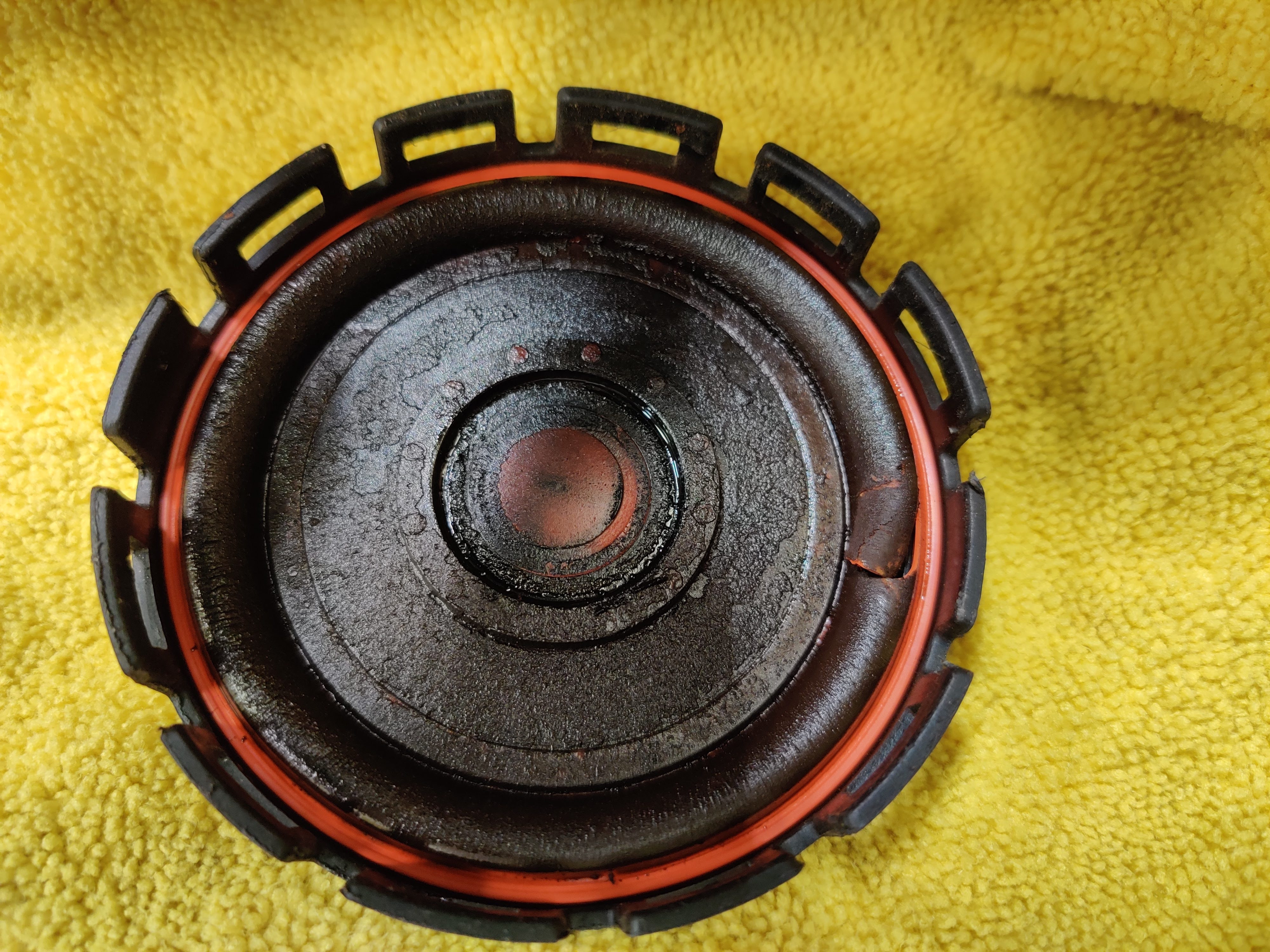

RS6-T28RPH
- 2nd Gear
- Posts: 131
- Joined: Fri Aug 07, 2015 10:35 am
Re: Turbos - oh dear, the saga continues
I also have the oil in the bottom of the boost pipes between turbo and intercooler, yet the turbo outlet looks squeaky clean so similar situation at a guess?
A while ago I did have a bit of a bang and a stars in your eyes moment out the back of the car, the fine oil separator diaphragm had split as well as blowing the crap out of one of the non return valves down below it. Replaced those and the white smoke has gone, still rich as you like with the odd puff of blue smoke on cold start-up but hey ho, she be alreet
156k miles on the clock on oem parts, mega stuff
fingers crossed we shall have her booked in with RE Performance soon for the upgrades
