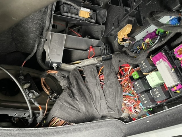

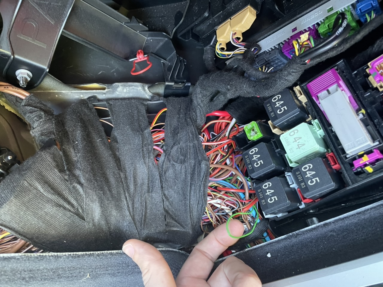

Re: Mysterious beeping
Cheers.
Pics attached. Nothing jumps out to me as a layman as “non Audi”. But I’m no electrical expert.
As far as I can feel/ see there are two grommets.
- One 6inches further towards rear of car (not pictured) which seems to connect to the parking assist module. And has the barcode tag on the cable.
- one at slightly at side of car which you can see the grommet. That has what looks like proper wiring which runs along side of fuse box and joins into the big jumble of wiring to the left of fuse box.
But as I said I’m no expert
Nothing obvious and not easy to decipher too much from pics but can you tell me where the 2 green wires are going to next to the bottom left '645' relay?
RS6 Performance Ascari blue, Carbon Ceramics, Akrapovic, H&R Anti Roll bars
Think that’s a trick of the photo it’s actually a loop coming out of the main bundle. Looks too entangled not to be Audi.
