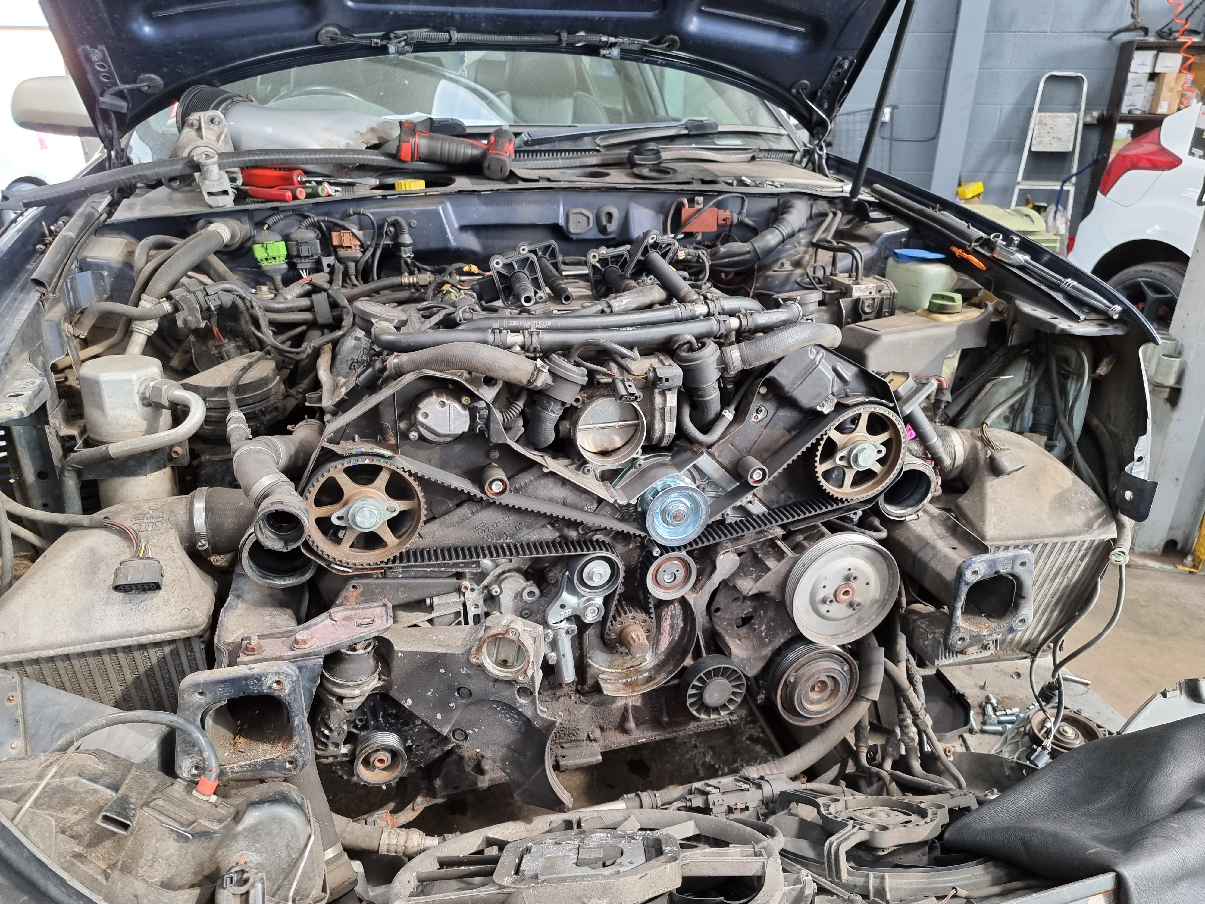

Well, after being told it would definitely be ready today, this is what I turned up to......
They say the timing has likely been out ever since I've had the car as the last people did not use the proper lock mech for locking the cams in place. They also said something about washers that had been ground down behind some of the pullies, so they wanted to replace them. There were a few other bits they mentioned and said some of the parts were not off the shelf and they have had to wait fotnehm to come in. Last of the parts are scheduled for the morning, so hopefully not long.
Also it appears the coolant leak I had was from the water pump, so at least that's sorted !

Always looks like a nightmare when they're at that stage of disassembly, doesn't it.

The old RS is certainly a lot more work compared to others I’ve done recently. On the others, it’s just a pin to lock the crank and cam and just change it all over. Or in some cases, just eyeball the timing marks.

I'm not very impressed with the lack of paint protection on the wings, the strain on the water and AV pipes from having the lock carrier forced open like that and the bits and tools laid all over the engine, plenum and inner wings. DOesn't scream "Aston Martin quality".

Looks like your intercooler is leaking, too. I'd better stop looking at the photos before I find anything else. ;)

Yes Shop. Tools all over the car etc etc.
Exactly my initial thoughts.

Yeah I must admit, the placement of tools etc, did take me by suprise. My bumper was just sitting on the floor next to the car on upside down, but literally just on the floor, no protection at all.
I'll certainly be having a good look around when I eventually collect it.
The rounded bolts were from some large cross member type thing that sits directly across the front of the engine. It only has 2 bolts, I'm not exactly sure what it was, but I'm guessing it connected the 2 intercoolers to the intake in the middle ? It looked like it had an opening each end and was hollow "Ish"

That was my guess. Those bolts are tricky ones until the lock carrier is off - if it's just in "service position", they are a bit tricky to access, you are going blind.
Once lock carrier off - or lowered like this - then easy enough to drill out/encourage an oversize bit in to.
