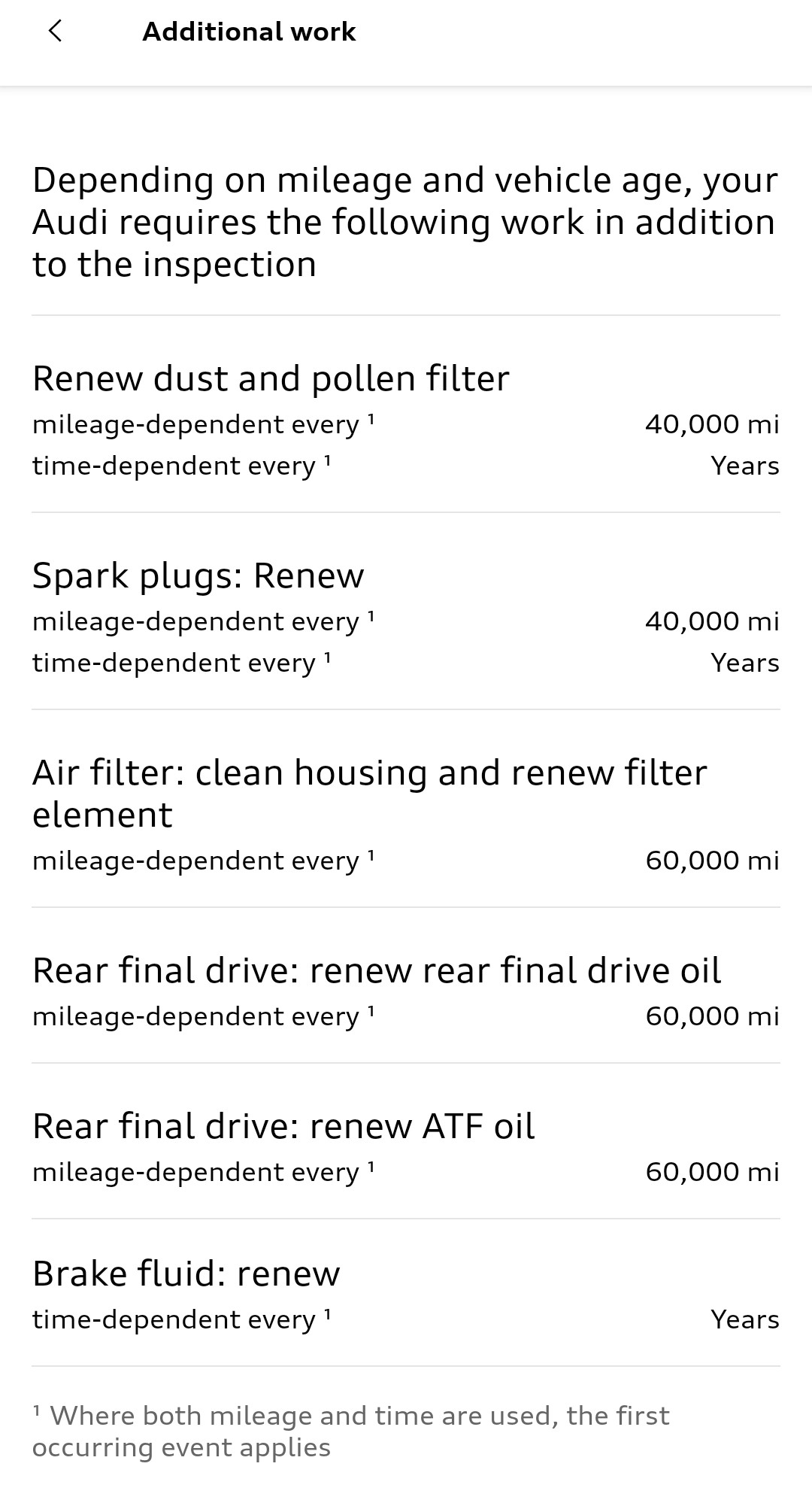

Does the B9 still need front final drive oil change at 20,000 miles ? Dealer has told me after speaking at length to Audi ! that front and rear are both 60,000, and they are tamper proof ??
Doesn't sound right to me!

I'm sure the front box is sealed for life, both rear oils need doing ay 60k.

I'm sure the front box is sealed for life, both rear oils need doing ay 60k. Screenshot_20210407-221531_myAudi.jpg
Thanks @dannyboy123, is this from myAudi. How do you get to this screen, pls.
scroll down
Service Topics -> Additional Work
