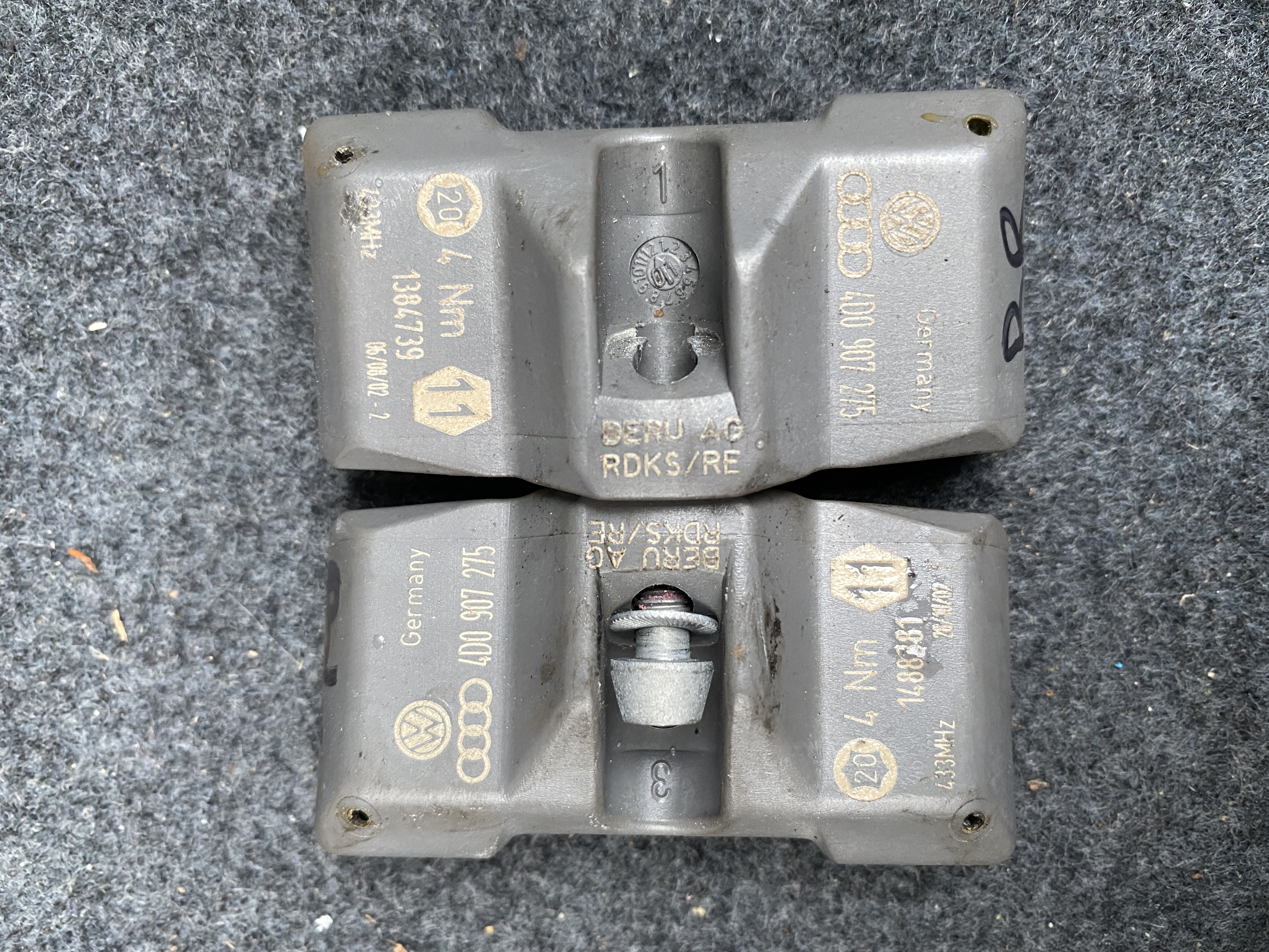

I took the tyres off my alloys on Saturday and the Audi p/n is 4D0 907 275 433mhz. I think they are now HUF RDE001.

I bought some Huf RDE001.
The auto doc ones sound like very good value. I’d try those if you’re sure they’re compatible.
