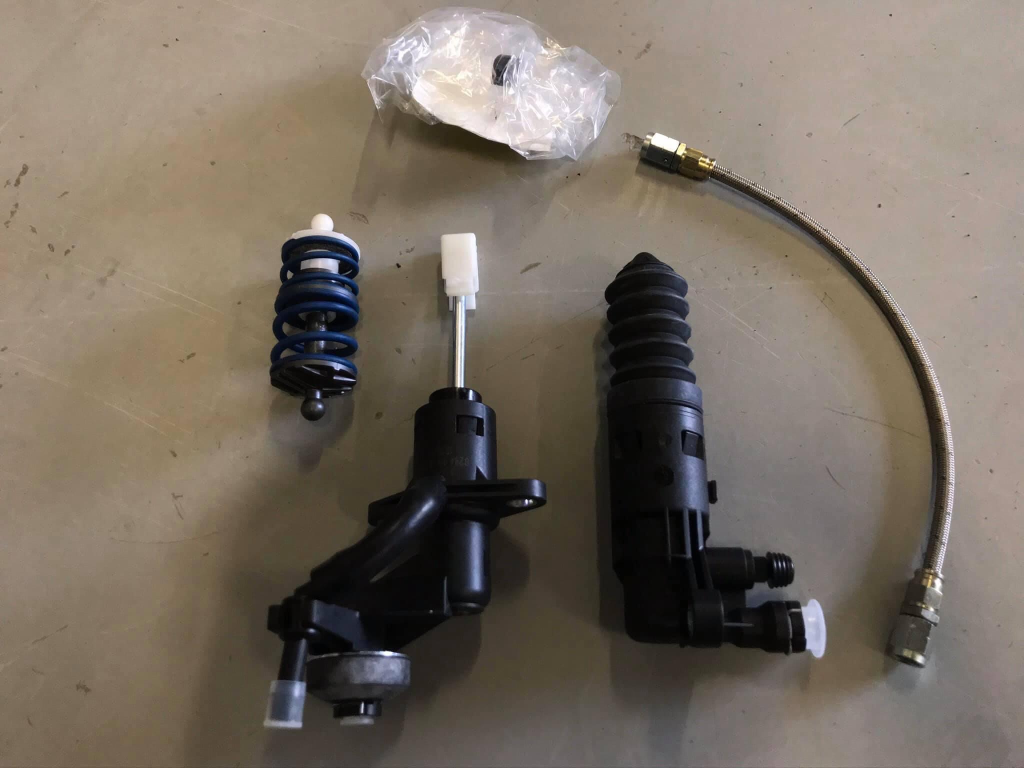

Time for another update.
I started to get the signs of a failing clutch hose and the pedal was staying down when shifting when pushing on!
As I was in the process of moving house I left it until I had moved into the new home and started collecting parts.

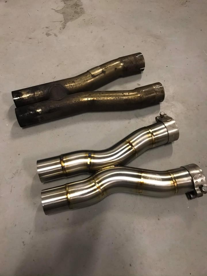

I had it all fitted by chris at CM Tuning who also fabricated an X pipe to replace the Milltek H pipe as I was having fitment issues with the Milltek downpipes, I wasn’t sure what to expect but I’m glad I had it all done, it sounds amazing, almost like it’s revving at 9k

I’m having chris fit mine with an X piece next week.
