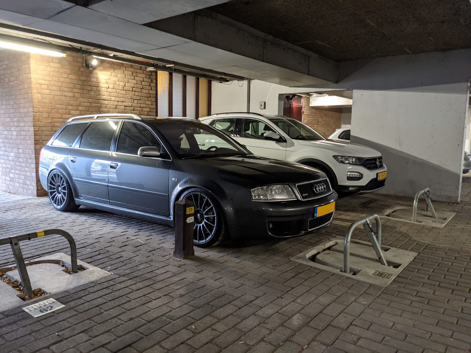

My car isn't a daily so sometimes sits for a number of weeks in our open car park on the ground floor of our building.
Some guys tend to drink beer down there at night and on occasions, someone kicked down the old chain that used to close the space when my car was in the Shop.
The homeless guys seem harmless and only leave their beer cans there.
I had this barrier fitted so it can lock my car in its space. I'm now happy the car is safe as can be. In the winter I won't be driving it much and on two occasions the battery has died in two weeks.

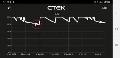

I mentioned this with my car about a year ago. The major source of my drain was the alarm horn battery. I removed that to check and the current drain dropped to the minimum. Nevertheless, the car design with the alarm system (motion detector etc) activated still uses power so it is not possible to get to a zero battery consumption state. Furthermore, if you log the battery state, you'll see a significant battery drain every time you open the door or boot and it takes some time for the current draining items to switch off. Even if you just let it sit you'll still need to top it up every month or so if you wish to prevent long term battery damage and possible cell reversal.
I did consider a cut off switch and there are plenty of options but in the end the benefits are clouded by the disadvantages which have been mentioned above. The penalty you pay for a more fully equipped car.
Re: Car Standing-Battery Dying-Kill Switch
Yup. Mine is now snug in the garage again with its IV CTEK.

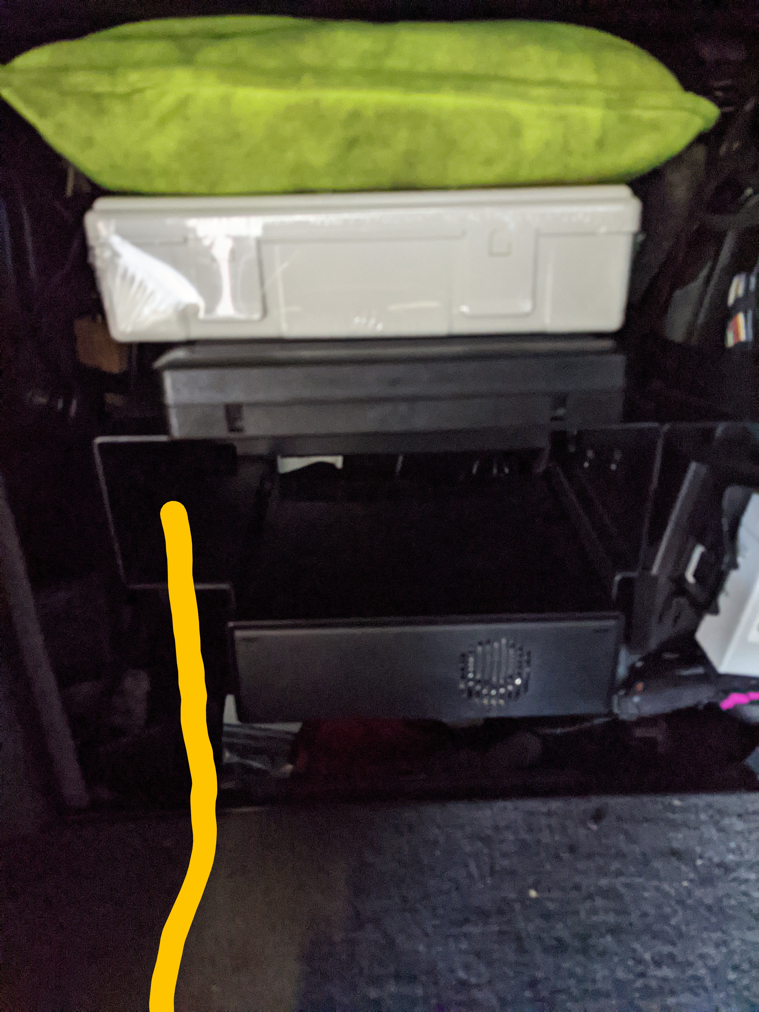

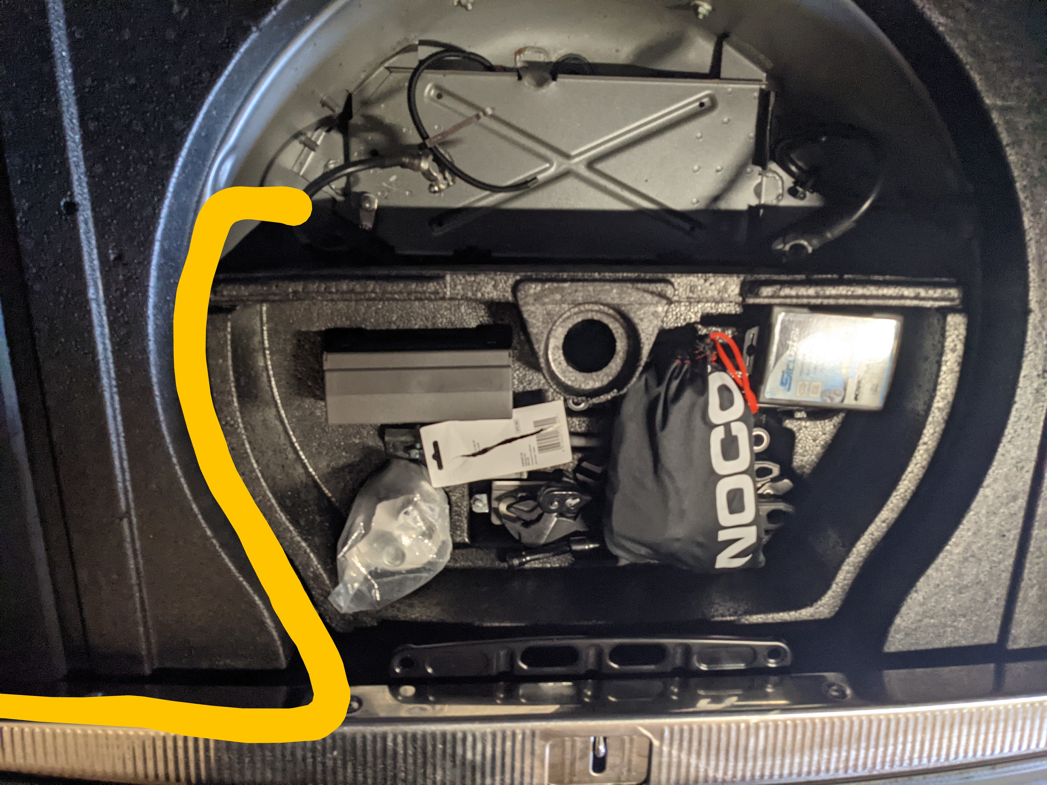

I was thinking to run cables from the battery connection to the left-side storage space where the CD player used to be:
There is a channel of space between the polystyrene and the bodywork where the cables would go.
Having got them into the left-side storage space I could connect them to the switch and mount it where the CD player used to be.
The benefit of this over the Halfords Dis-Carnect is the ease of access. The downside is the headache of install, drilling holes into the metal shelving and generally more ballache.
I guess the Halfords option is also safer as I'm not running the power anywhere other than where it already is.
I'd also like to not drill any more holes anywhere.

That said, having the fire extinguisher where I do makes opening the wheel-well lid a bit of a pain.
If I'm looking for the battery cable extension wire, what gauge and max amperage are I looking for?
