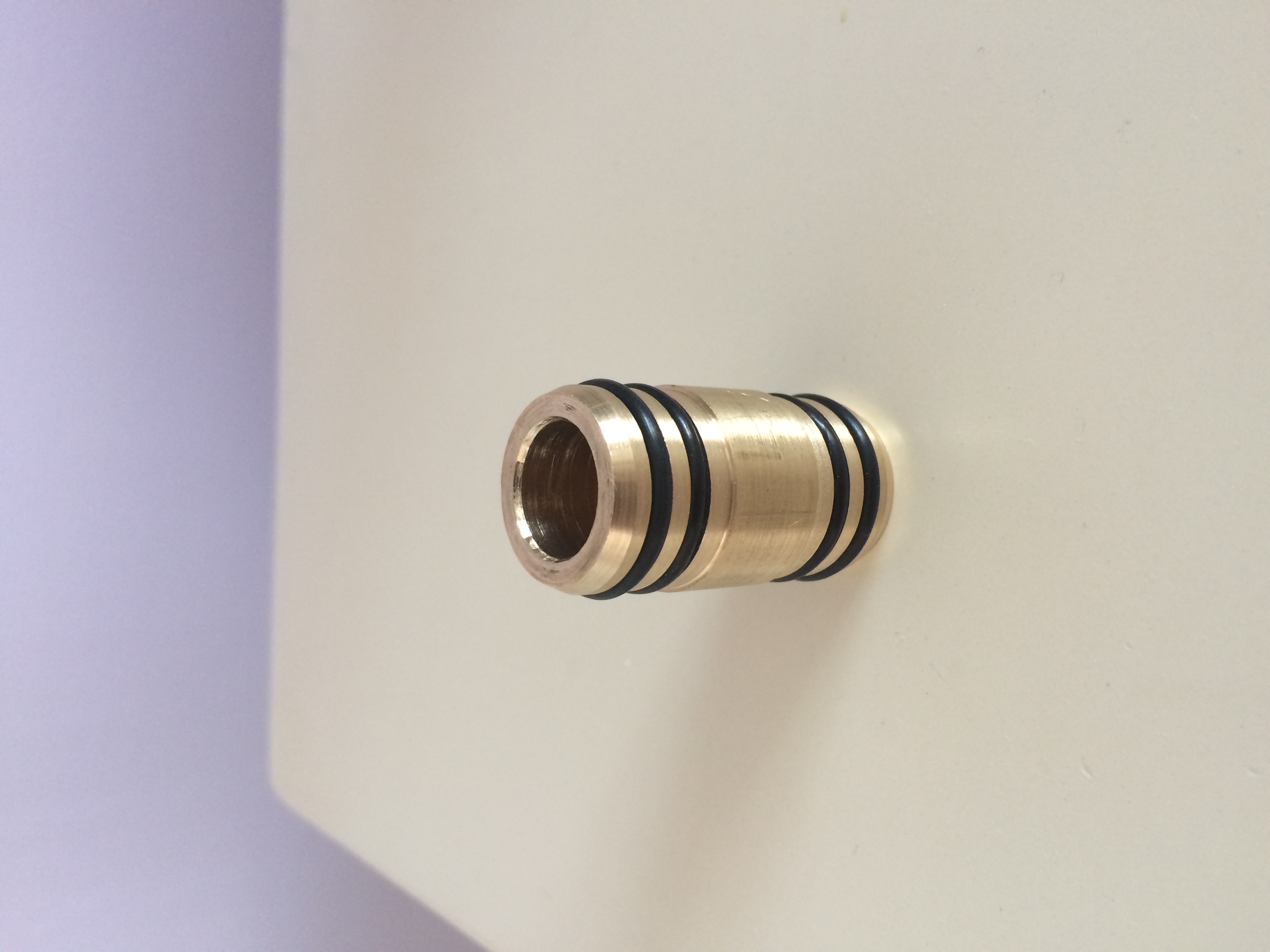

Classik / HPsauce.
This arrived this morning. Many thanks for your assistance.
Re: Coolant leak
Great! If it can give some hope the job has been done twice here without having to pull the engine out, it's just 'a bit' of a pita and you'll need to sacrifice an allen key...
The following tutorial is for the A8 but it should be a similar job for the RS6 : http://www.audipages.com/Tech_Articles/ ... stall.html

Re: Coolant leak
This pipe was one of the triggers for my second engine out event. I naively/stupidly didn't do it the first time.

Re: Coolant leak
Ok talking of being naive. Had the engine out about 3 years ago to replace the power steering hoses.
Wish I had done the buffkin pipe at the time. But at the time I didn’t know it was a common problem.
In hindsight should have put a post on here asking what work should be done while engine was out.
