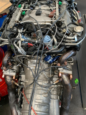

Teo also got a motorsport friend of his to service the engine while it was out: (with 034 Motorsport uprated engine & transmission mounts +transistor bypass)
Camshafts seals, Crankshaft front and back seals, Camshafts cover gaskets, Camshafts tensioners gaskets, Tensioners slides, Camshafts plugs, Timing camshafts chains, Back cover gasket, Engine ventilation gasket, Thermostat, Sparks set, Detonation sensors 3 pcs, Intake manifold gaskets, Exhaust manifold gaskets, Turbo bolts set, Water manifold o-rings.

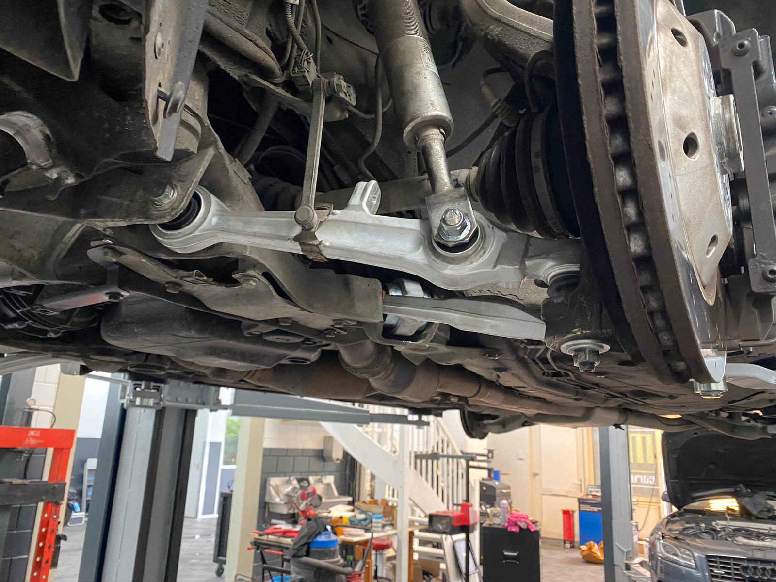

I then drove the car back from Poland to Rotterdam. Martin from MP Carworks then took the car and we got to the next task, suspension:

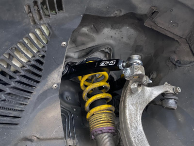

OZ Superturismo LM 9.5 x 19 ET40 + MICHELIN P-SP 4 S 255/35ZR19
034 Motorsport: density line adjustable upper control arm kit & lower control arm kit, uprated tie-rods, Spherical rear sway bar links + front uprated links
H&R ARB 33524-1
SKF Top Strut mount
We lowered it and made the KW firm, and I'm now very happy with it, it's planted, doesn't rub, even with seats down/loaded up. It is a bit bumpy but I guess that's the compromise. I can just fit my finger between the inner wing and tire.

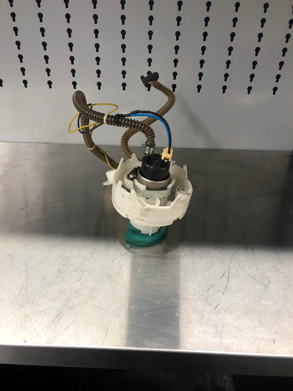

Then to the other parts before being set up......Wagner intercoolers, 034 Motorsport billet check valve, DW400 in-tank pump, BMC air-filters, braided brake hoses.

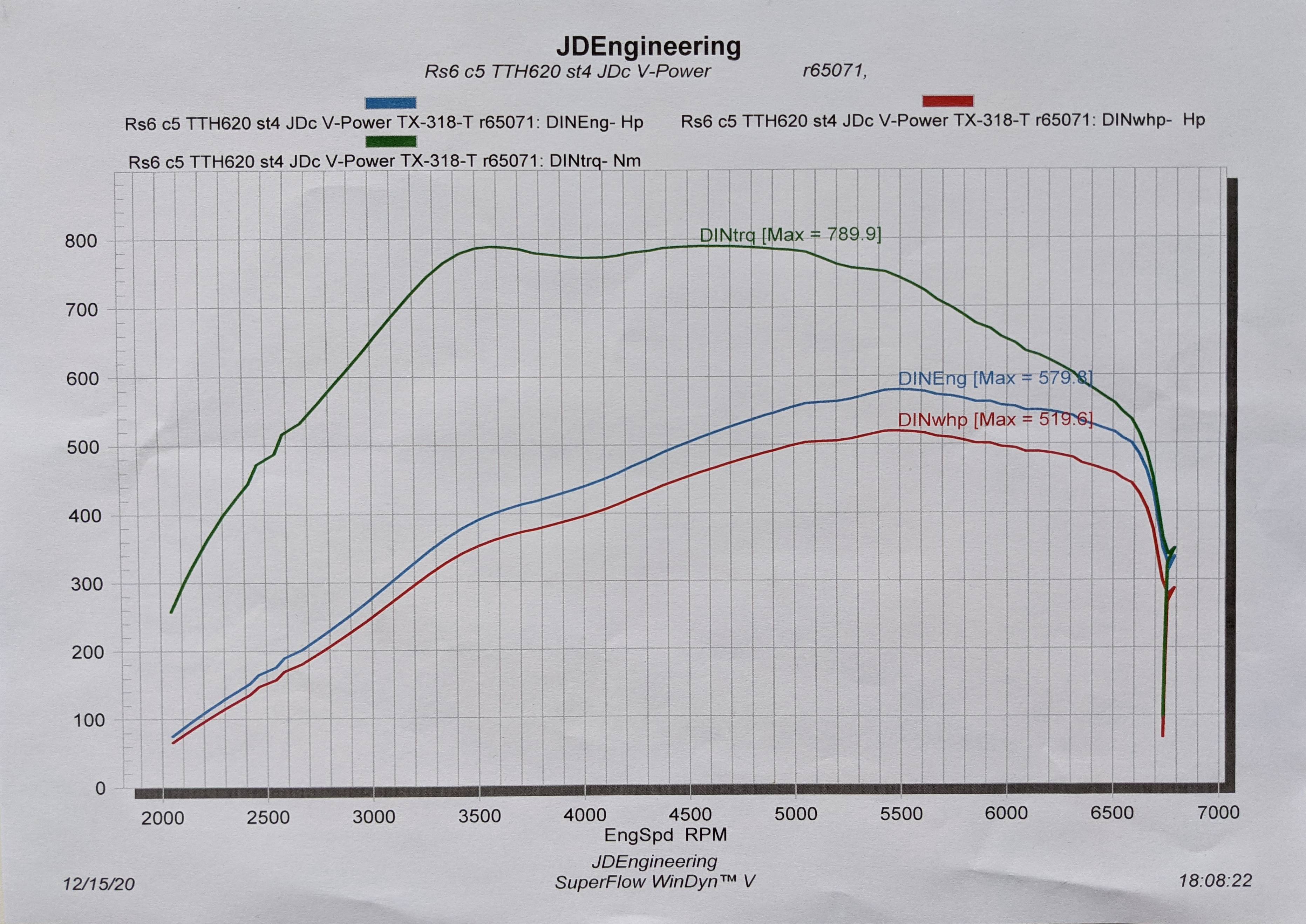

Final stop was JD Engineering so Martijn could map it for me. We ended up here 580bhp / 790Nm. At this level the shift is smooth in every situation. It's also what Teo recommended so happy with that.
