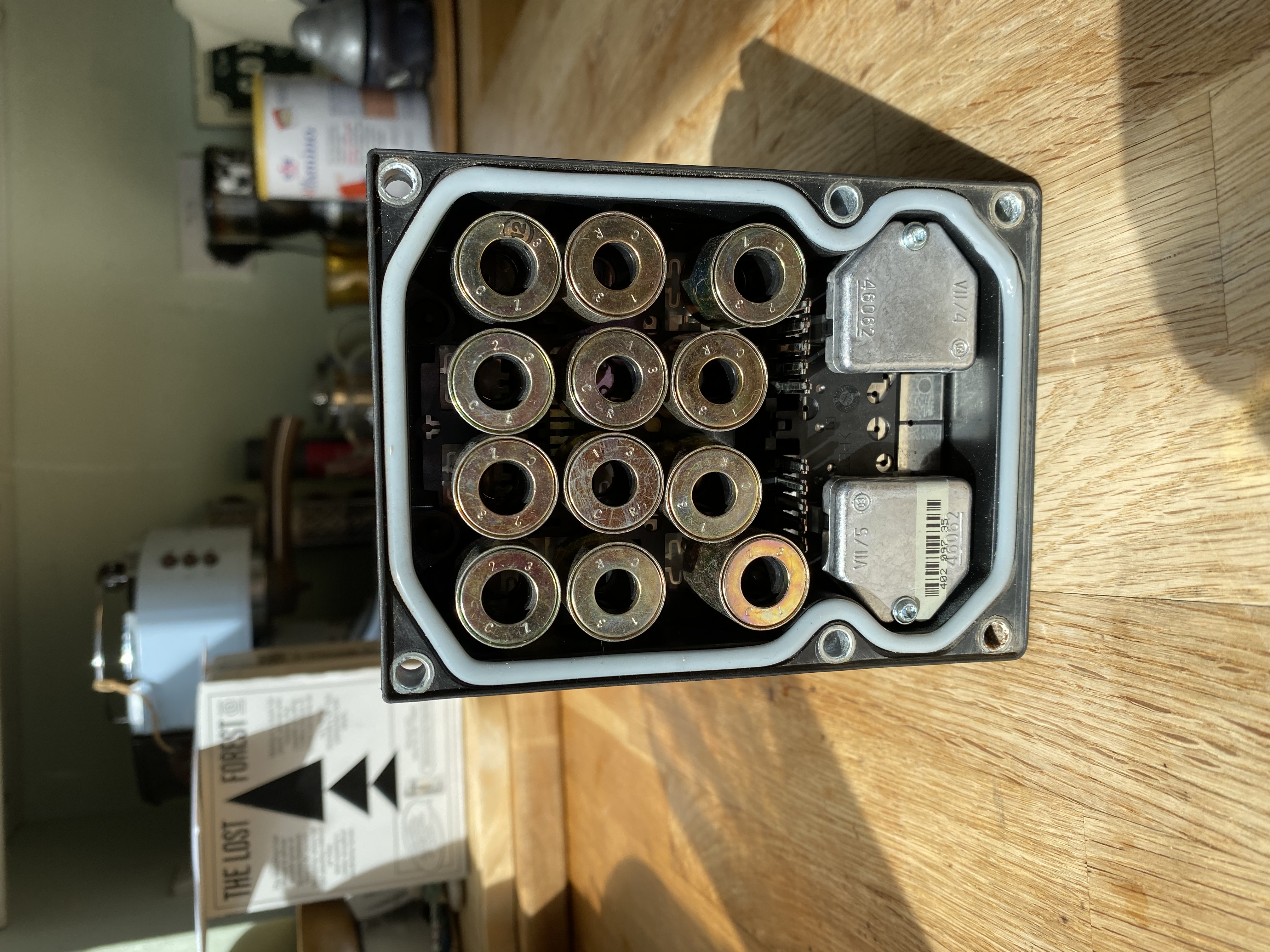

Little update on this, I got the module off. It came out without needing to remove the washer tank. The bolts were all accessible with the arch lining moved, I did remove the three retaining bolts on the washer reservoir to wiggle it around and that gave me the room to manoeuvre the unit out. I’ll still take the washer reservoir out for a clean, I just wanted to see if it could be done with it in place. 🤪
It’s getting collected tomorrow and sent off to ECU Testing and I’ll hopefully have it back next week.
