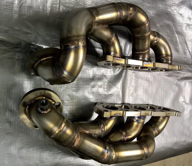

To add to my last, there is a bit of science and testing involved in getting a system working across the whole RPM range and staying legal in a road car. That said, if you copy a good system design that has proven itself, there will be no difference between the brand name and a good exhaust Shop made (or even DIY if your welding is up to it) product.
These are my RS4 manifolds so you can make a system from pre formed bends and do away with the expensive pipe benders, if you can weld, that is.
