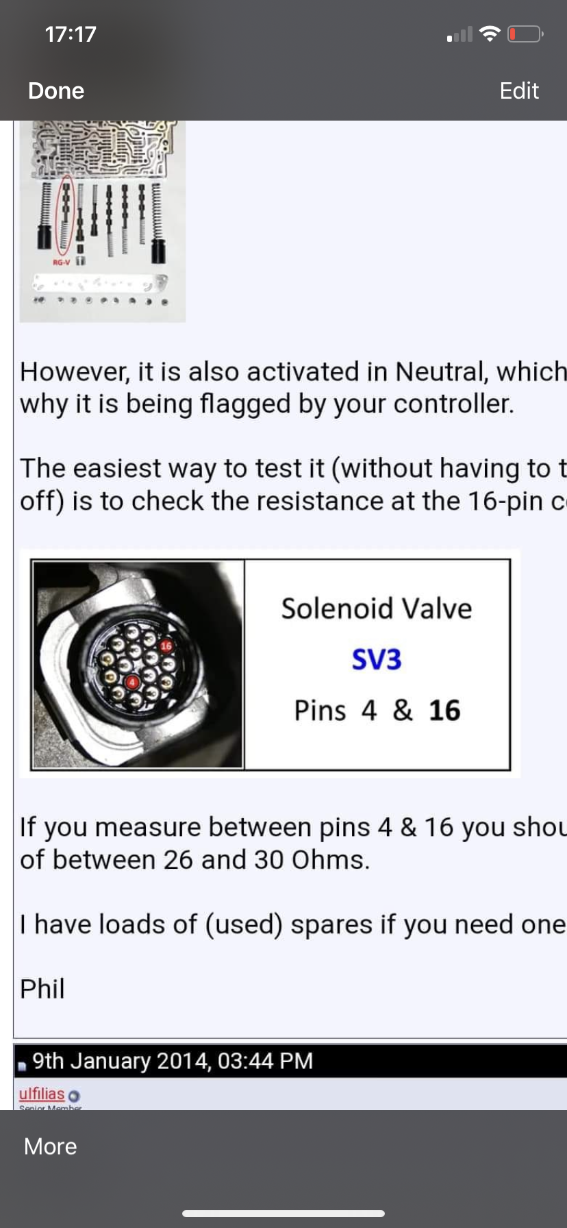

-checking the reading between pin 4 and 16 on the harness at the front of the trans (reading fine) and cleaning that connection

Testing the pins on the connector and getting a correct ohms reading shows me that the solenoid is okay though ?
