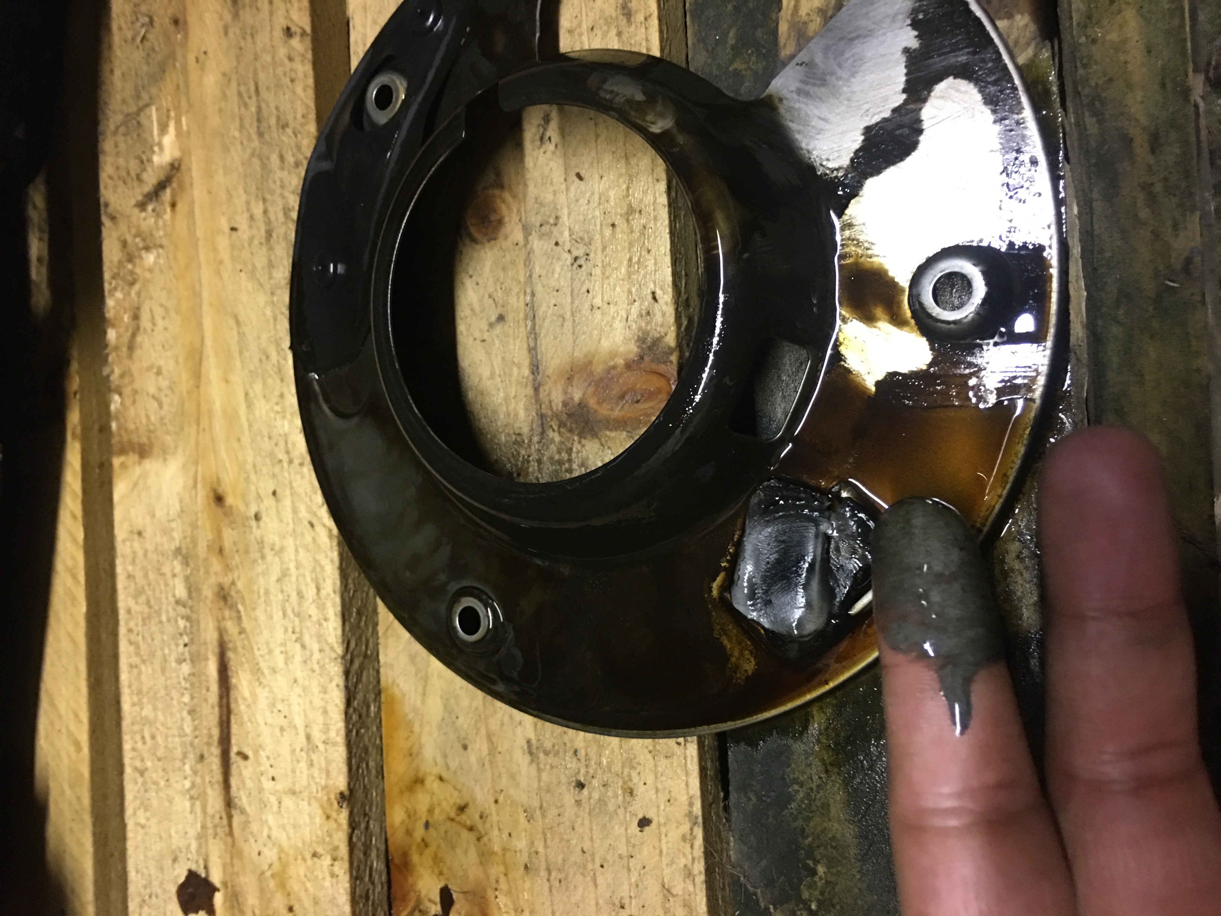

So far the Same as the 28 as explained above, so I won’t bore you, front diff magnet was FILTHY but no big pieces or dept is of 1mm
