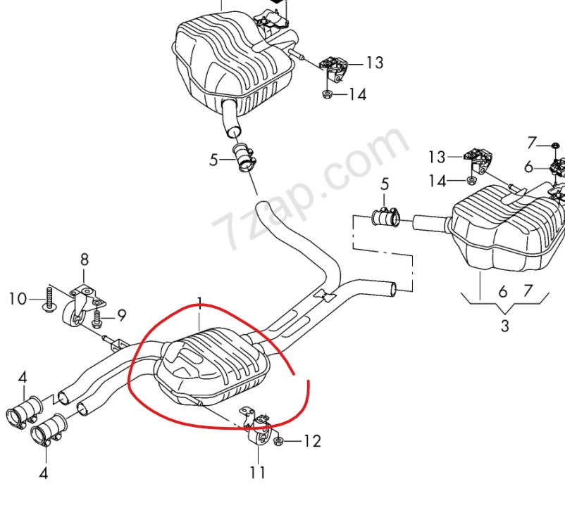

There are 2 boxes to remove. Did you only remove one?
2017 RS6 PE Nogaro
Re: Centre resonator delete testing video
There's one centre resonator - this is what I removed.
There are another 2 small silencers as part of the downpipe sections. Not those.

Oh right. Mines a face lift and had the big box and some smaller ones too towards the back boxes
2017 RS6 PE Nogaro
And the boxes I marked in blue you left original?
Yes Tadass, those are still in place, with the exhaust flaps/valves on the tailpipes. I wanted to keep the valves, so I had some level of control on the volume. Next step is decat, so I'll be interested to see if they can control the volume at all!

I wouldn't say the milltek non-res was insane. It certainly is a great sounding exhaust but not much louder than when I did a front and centre resonator delete (I removed the centre big box and the 2 smaller front ones that most people think are the cats).
A decat with standard cat back is also not insane but I think is one of the best exhaust combos on this car; it gives a good power increase and best sound and is not that expensive; downsides are obviously MOT and that you will most likely need a remap (less of an issue now that most of these cars are out of warranty).
Decat with front and centre res delete is starting to get very noisy, and the point at which I think you will reach your 'little bit of regret' point. Obviously everyone is different and some think the standard exhaust is noisy enough so this is just for viio and not a general recommendation.
The smaller boxes are towards the front, not rear, even on facelift.MountainMutant wrote: ↑Fri Oct 23, 2020 6:50 pmOh right. Mines a face lift and had the big box and some smaller ones too towards the back boxes
