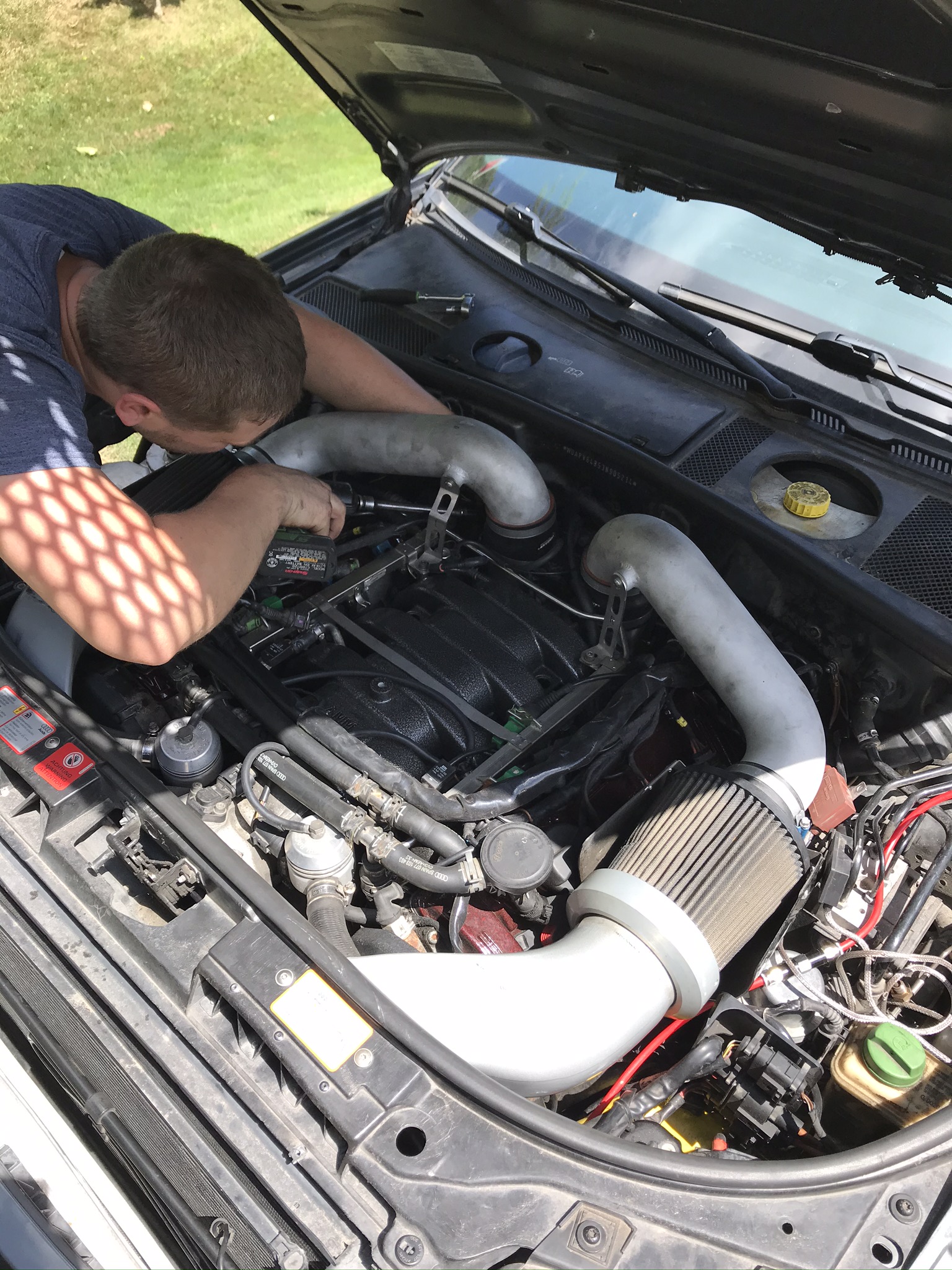

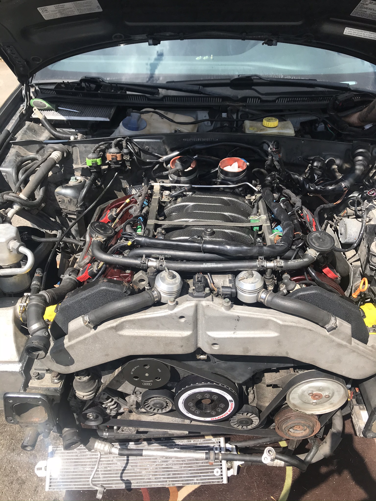

Well the beast is back! After my ATI fluid damper failed within hours of installation and after 18 months of blood sweat tears and $$$$$$ my RS6 is back ripping :)
Latest upgrades:
Water to air intercoolers
S6 heads
Ported intake
1.8T IaT sensor

Very cool. 😎 What sort of power are you running?

Post by Hixrs6 » Sun Aug 30, 2020 8:12 pm
Ty! We haven’t dyno tuned it yet But I’m hitting about 24 psi on 100 octane. I have to hook up my water meth again because the one nozzles corroded but I figure it’s around 600 crank plus because 100-200 kmh is around 7.5 seconds

any S6 heads fit the RS6 block ???

Post by Hixrs6 » Thu Sep 03, 2020 9:24 pm
V!per wrote:
Tue Sep 01, 2020 4:07 pm
I’m not sure to be honest. I believe these are b6 s6 heads? But I’m assuming any 4.2 heads will bolt up. The torque difference and sound is worth it in my opinion. I’m going to get my tuner to retune once I set up water/meth back up and I’ll get some dump numbers

I take it the S6 heads give a higher compression ratio?

Post by Hixrs6 » Fri Sep 04, 2020 9:54 pm
Gregstv wrote:
Thu Sep 03, 2020 10:13 pm
The chambers are all the same, just the pistons are different so I believe it’s same compression
