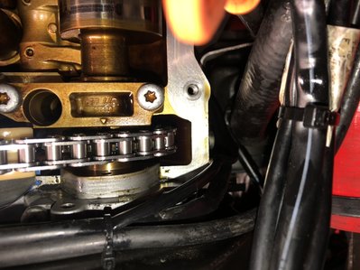

So where did the timing error come from?
Re: Camshaft Timing
That's a good was question.
I just reset everything, the tension first (it was in spec, but I reset it anyway) and then retimed it all.
Crank pin and cam lock fitted perfectly before and again now.
However, on the before pic you can see the the ex cams were exactly centred on the cam cap. Now they are very very slightly advan ed compared to the cap marks.
Only thing I did differently was once the tension was set up, I cranked the motor a few times on the starter to bed it all in before finally setting the timing. I also eyeballed the bank 2 ex cam vs the cap - so I knew it was a bit more advanced this time.
(Final setting ex bank 2 pic attached) Anyway, I can only conclude it was stacking up tolerances on the belt Vs the pulleys and the wiggle room on the bar Vs the odd washers.

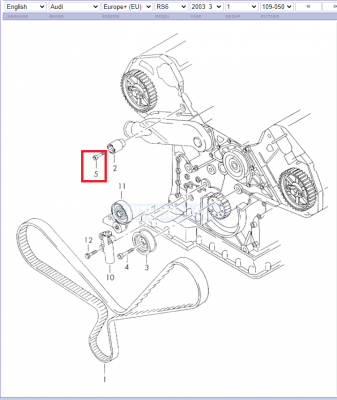

Re: Camshaft Timing
Potentially - let's check. I think you mean part no. 5 on the diagram?

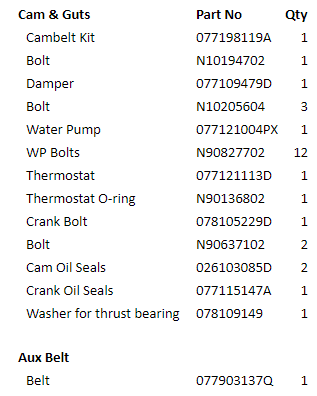

However I think the roller and bolt might be included in the cambelt service kit 077198119A - do check.
If helpful, for the service I was discussing at the beginning of this thread, here's all the parts I ordered, including the service kit, waterpump, crank oil seal and so forth:

Had downloaded this list some time ago. I will cross check the rest against your list to make sure I have ordered correctly.
The full parts listing for all items I replaced - full timing belt kit, all tensioners, pulleys, bolts, seals etc:
