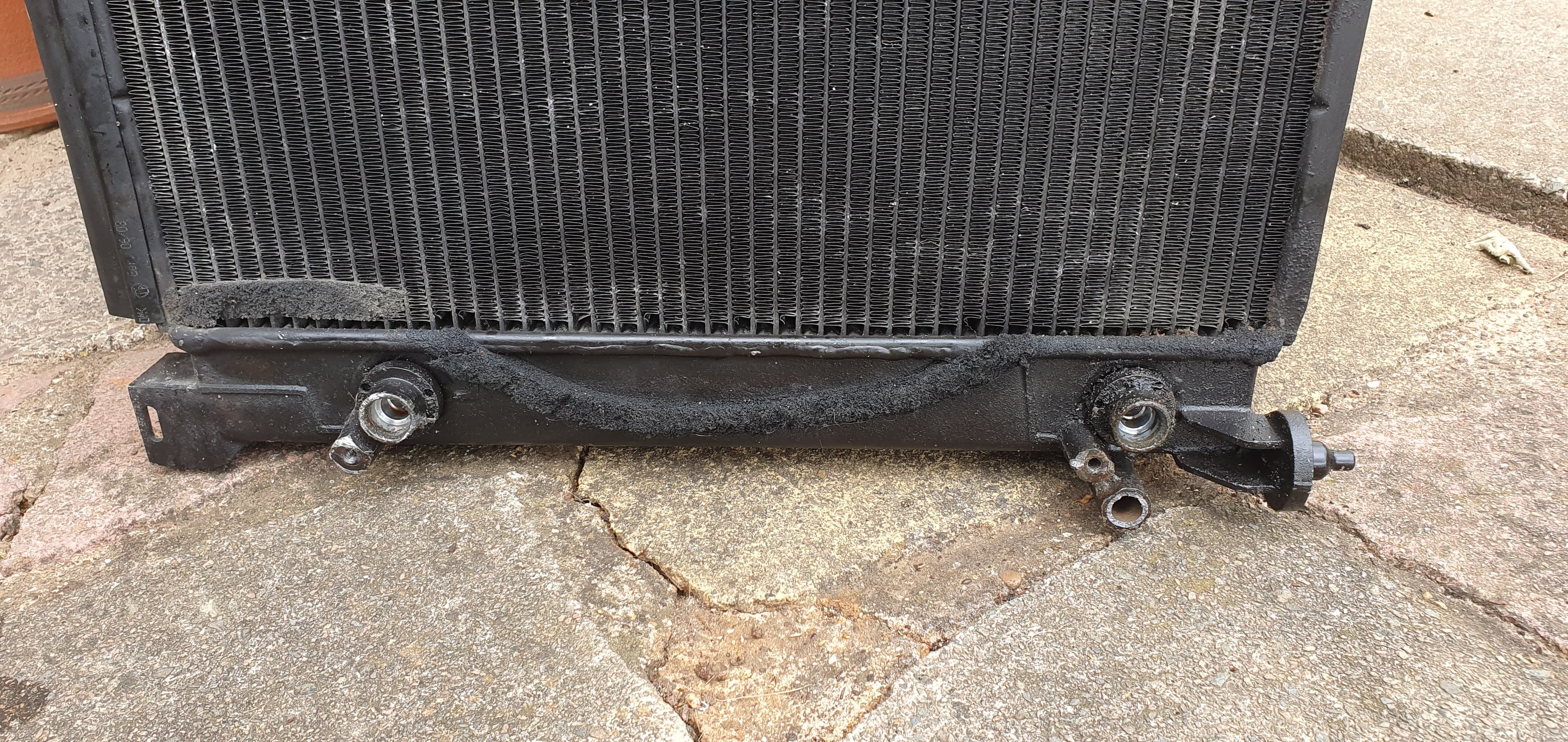

Hi guys,
My radiator has gone on my 04 RS6 saloon, and I’m struggling so much to find one! I’ve got the old one off and taken some photos.
The part number I need is 4B3121251F which is on b/o at Audi and also, over a grand!
Tried to get mine refurbished but no joy there either.
It’s got the extra pipe for what I believe is the auxiliary cooling.
If anyone could help me track one down, I would much appreciate it.
Many thanks :-)

The extra pipe is for the afterrun pump. You can change the plumbing so that it circulates like the early 2003 cars and always let your turbos cool down to 90 degrees which you should be doing *anyway*.

I’d be interested in one but would need to check which rad I currently have before confirming (can the difference be seen without taking the bumper off?)
Ajc
Posts: 765
Joined: Sun Mar 27, 2016 7:27 pm
Location: Cheshire
Re: Can’t source a radiator!
Post by Ajc » Thu Jul 16, 2020 1:59 pm
From what I remember the extra cooling loop can be found on the back side of the rad on the n/s so you may have too take one of the silver air ducts out too be able too see it . It’ll be tucked under the front panel so you can’t see it easily however it does run from top too bottom . I have this rad in mine however I don’t have the aux rads behide the ic’s
