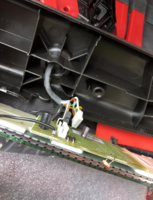

Firstly remove your rear view mirror (RVM) from the windscreen. To do this rotate the RVM arm anti-clockwise by 90deg, mine was very stiff but it did pop off. Disconnect the cable that was hidden behind the trim cover. You can see the mounting plate and electrical connector here.

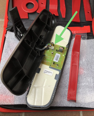

Now you need to split the RVM housing. Start by splitting the glass face surround. Using the appropriate tools pop the surround off. (You can buy an excellent trim removal kit on eBay for very little money)
Once the glass retaining trim is off the glass will move forward, you can then access the connection block. Give this block a little wiggle and it will pop out.
Now you have the mirror away from the housing you’ll need to separate the control board from the duff glass.

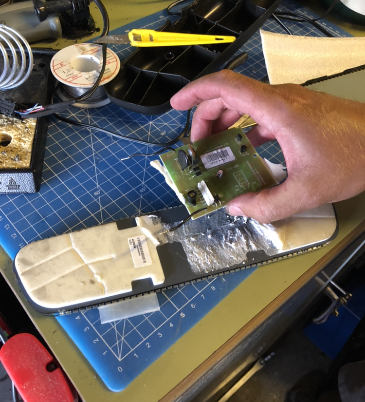

Simply use your soldering iron to heat the existing solder a separate the cable from the glass contact point.
Now gently work the board away from the old glass. You can use a knife or fishing line. Whatever you use TAKE YOUR TIME!
Now John suggested checking the light sensor solder at the board, apparently this can be problematic and is worth checking now. Give the sensor a very light wiggle. There should be no movement in the solder or sensor. If there is you’ll need to clean up this solder and reapply.
Now apply double sided tape to the new glass in the same area the board was sitting on the old glass (obviously on the correct side). Before sticking the board down make sure the light sensor is going in its hole.
Now resolder the boards wire to the new glass connection points.
