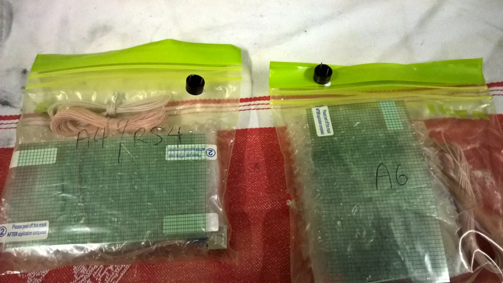

Steve, sorry for the highjack but I’ve just seen this on FB. Looks very smart.
I asked the owner for more info but he didn’t seem to interested in looking for the info. He did say it was done in Germany.

Hi Chris. I did see a fellow member on here had a “coloured” uprated screen fitted. Don’t know what type. Yes looks good in the photo.
Pleased you don’t have to do this very often. It’s a pain. But pleased I no longer have to look at faded/missing pixels.

Got two of those, one for the RS4 and one originally for the allroad. I understand that the allroad one is a slot in for the RS6. Just that I have new DIS on both cars and have been waiting for the DIS to start playing up before changing them out. Memory is a bit dodgy but I remember them coming from Russia. The ones that I have seen fitted have looked fantastic.
