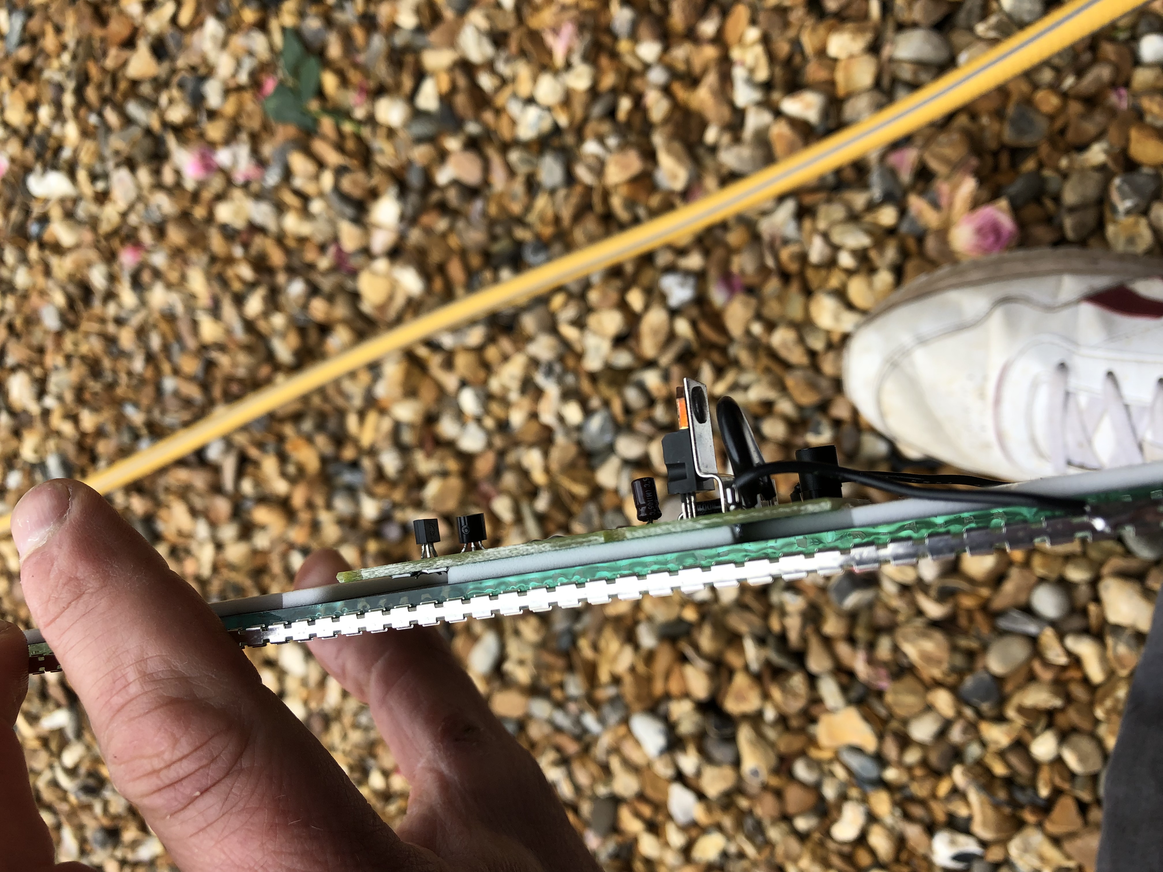

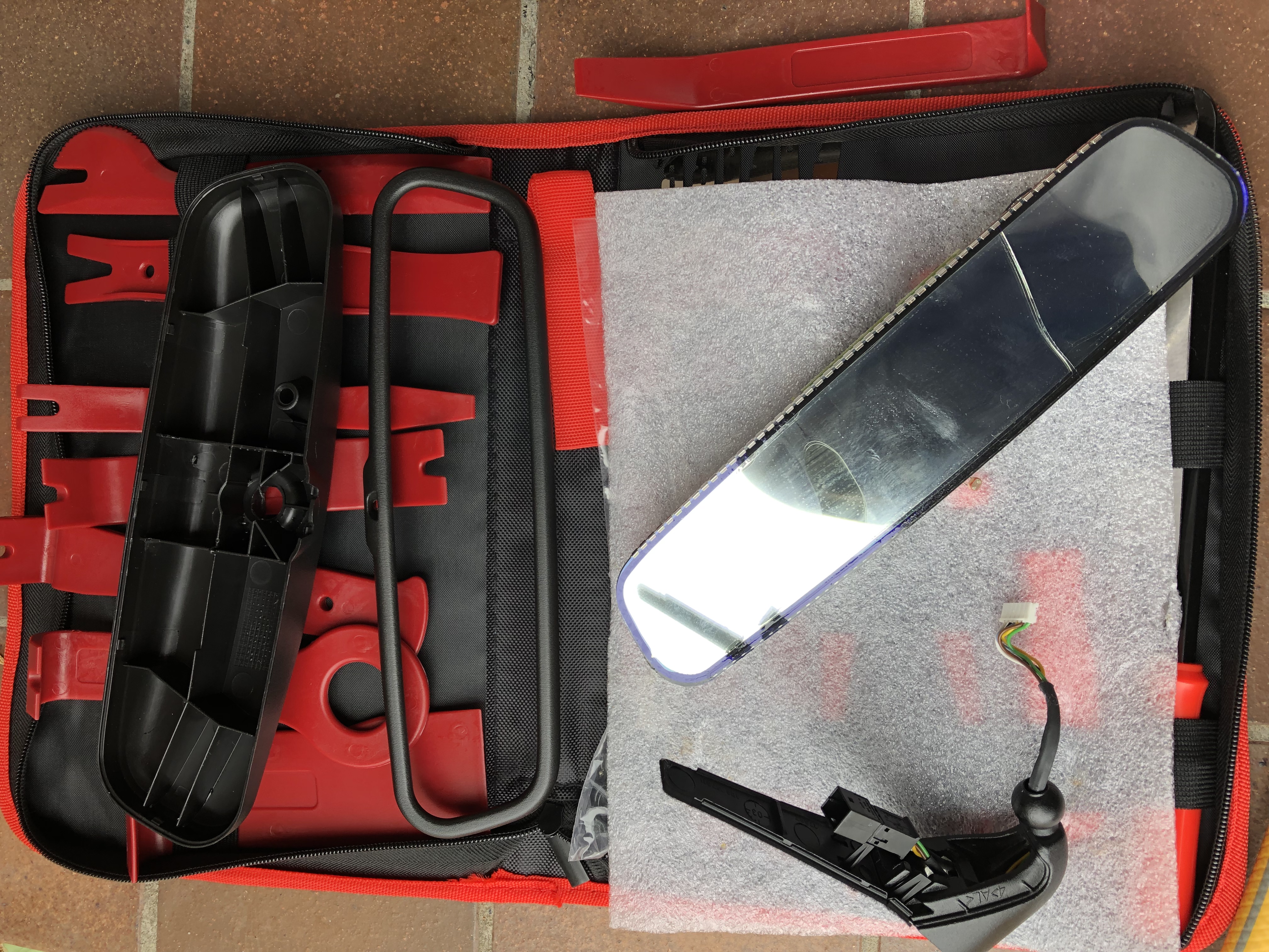

So essentially the mirror breaks down into four part after taking it off the windscreen.
I’ve now got the mirror separated and will see what options are available from here. Any ideas where to start are more than welcome.

My research has come up with a few possibilities.
1, Buy a new unit. They’re still available but cost around £350.
2, Buy a used unit. Will probably fail under the same sort of stress. (£70-£120)
3, Buy a used non dim mirror. (£15-£25)
4, Buy a replacement auto dim mirror glass.
Now to me number 4 makes sense, the obvious problem is finding the auto dim mirror glass. As luck would have it I’ve found someone who does this kind of work and oddly enough they’re members of the RS community, MirrorJohn (although he’s not been here for a long time).
I’ve contacted John through his eBay store, briefly explained the situation and invited him to visit this post and hopefully find a solution for us.
Here is a link to his eBay store.
https://www.ebay.co.uk/itm/224040938436
Fingers crossed we get a result.
