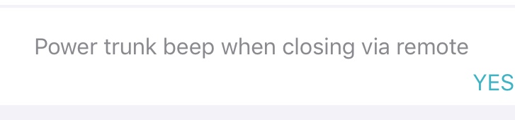

Does your car has keyless option? I couldn’t find in carista options list where you can close boot with remote control
Maybe you can post your setup from carista?
Here is mine:
download/file.php?id=55134&mode=view
download/file.php?id=55136&mode=view
