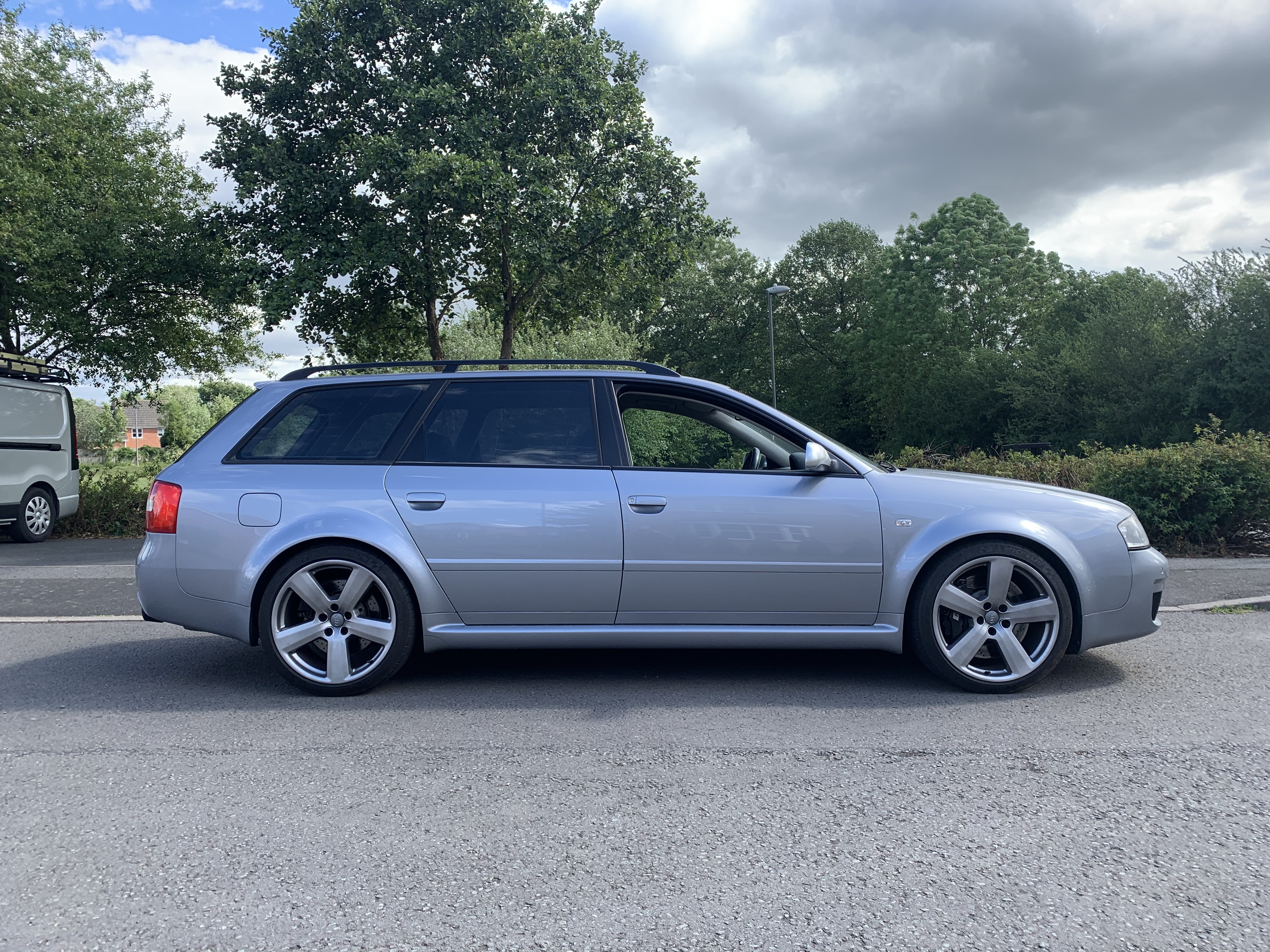

The only issue I have noticed I’m not sure about is the rear right corner seems to sit lower than the rest. Has anyone else had similar issues on these ?
Human Joist
Posts: 487
Joined: Sat Aug 02, 2014 6:04 pm
Re: Urgent suspension help
Post by Human Joist » Wed Jun 10, 2020 6:28 pm
So this is now after two days
This is just after it was fitted. Seems the suspension has settled a bit. But almost a bit more at the rear
