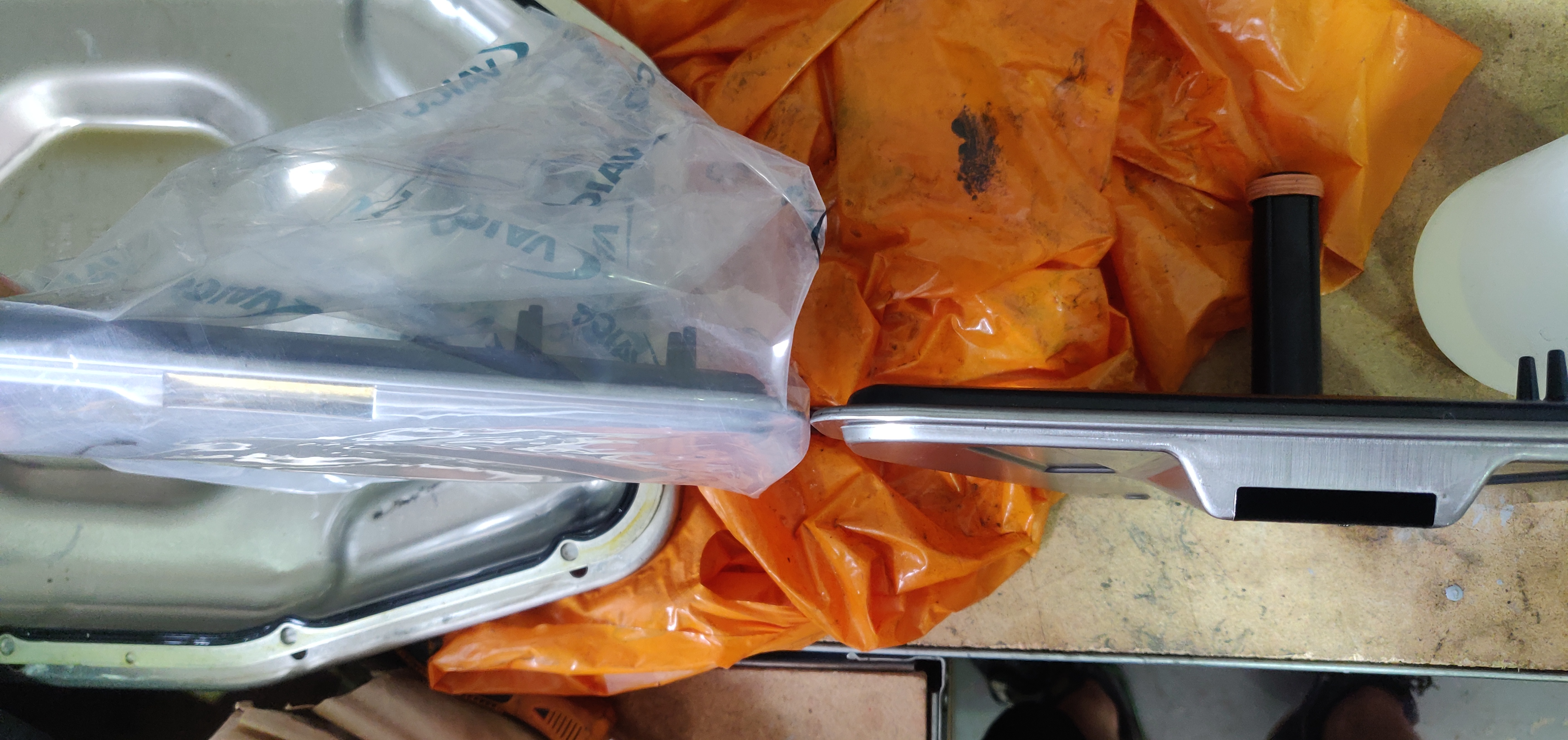

Hmmm another issue. Despite specifically saying it will fit the RS6, the filter is different. The filter that was on the car has a lower pickup. I'm going to guess that this is fairly important and it would be better for me to just clean out the old unit and return this one?
Picture attached

Also, the ZF part number on the original is:
ZF 0501223001
Searching this seems to get more accurate results than even the Audi part number I was given.
https://www.ebay.co.uk/itm/283877193324
Doesn't seem like there's much available in the UK though

Done, did the fill last night but it was too warm to check level, so just d that now. Haven't opened her up yet but she's driving fine so far. Ended up cleaning the old filter and gasket and using those.
