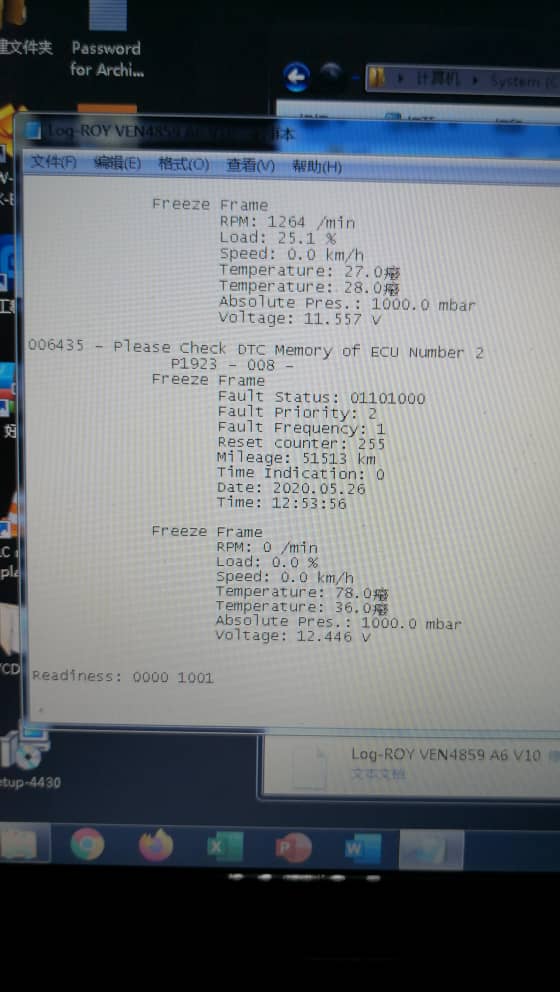

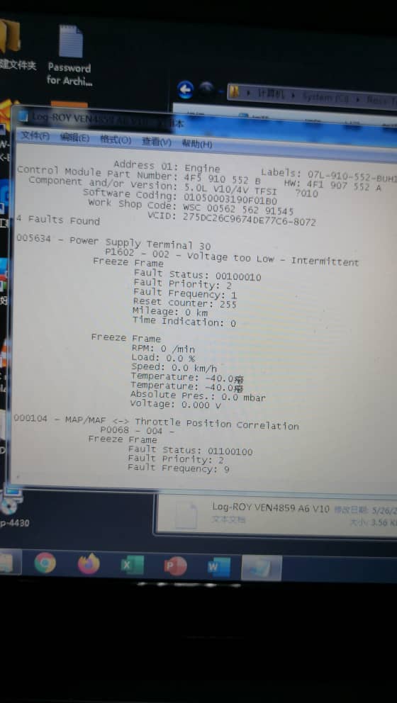

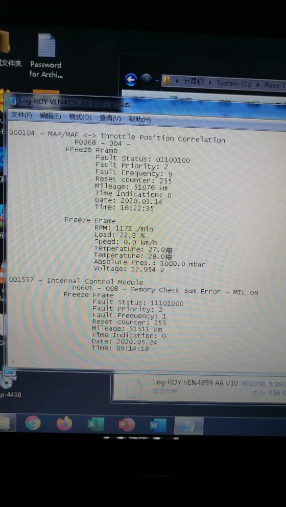

I managed to get a Vag Com check today, the error codes are P0601 and P1923, so it seems to be something electrical. There was no mis firing or low rail pressure codes etc, the guy with the Vag Com said there were no errors relating to mechanical issues & he thinks it's either the ecu or the remap that's caused the issue. The car is back with the guys that did the tuning now. They were closed today...but at least i managed to get the error codes today & they will check again tomorrow & we'll take things from there.
Has anyone had to replace an ecu? I believe we use MED9.1 & it's the same as other VW & Audi models, so just wondering if it's the ecu that dead, i wonder if anyone else has had the same or similar issue & any idea what caused it?
Roy

Re: EPC and Engine Check Light on - Any advice?
Error code details attached for reference.
Roy
Roy
A checksum error. I dislike pointing fingers but that shouts 'remap' to me. To quote a guy I used to know who was weird enough to enjoy digging into assembler code, maps and EPROM flashing - "They say it's the ECU. It's NEVER the ECU". I think 'NEVER' was an exaggeration - 'rarely' would have been a better word.

My brother used to work for Motorola at the plant that manufactured ECUs. He said they were always getting ECU returns, and 99.99% of the time they were no fault found. It was ALMOST always everything else that interfaces with the ECU that was at fault.Jim Haseltine wrote: ↑Tue May 26, 2020 4:30 pm"They say it's the ECU. It's NEVER the ECU". I think 'NEVER' was an exaggeration - 'rarely' would have been a better word.
Checksum error might sound like a tune problem - but what would have changed between no-fault and fault? If the tune was at fault, wouldn't the light have been on all the time?
