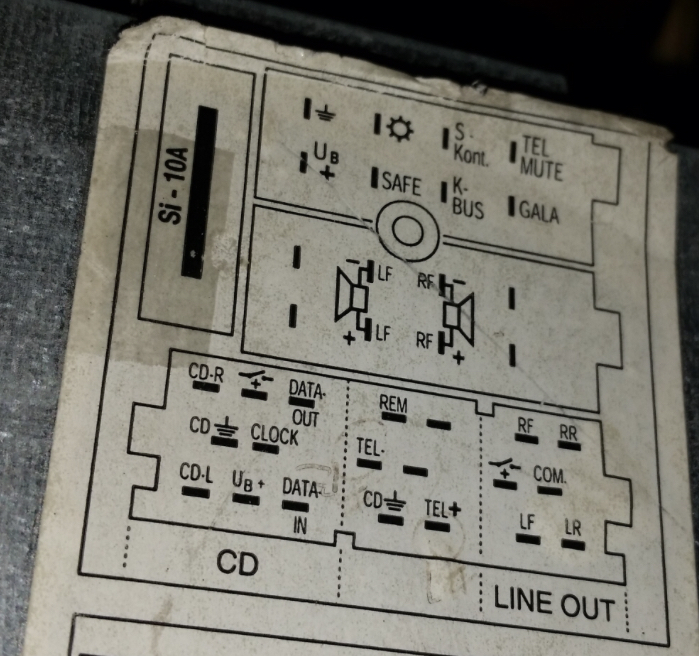

Now remove the head unit. You now need to test the voltage between the earth and the SAFE pin, you should be getting 12v however I was only getting 3v. You can also check the voltage at UB+ as this to should be getting 12v.

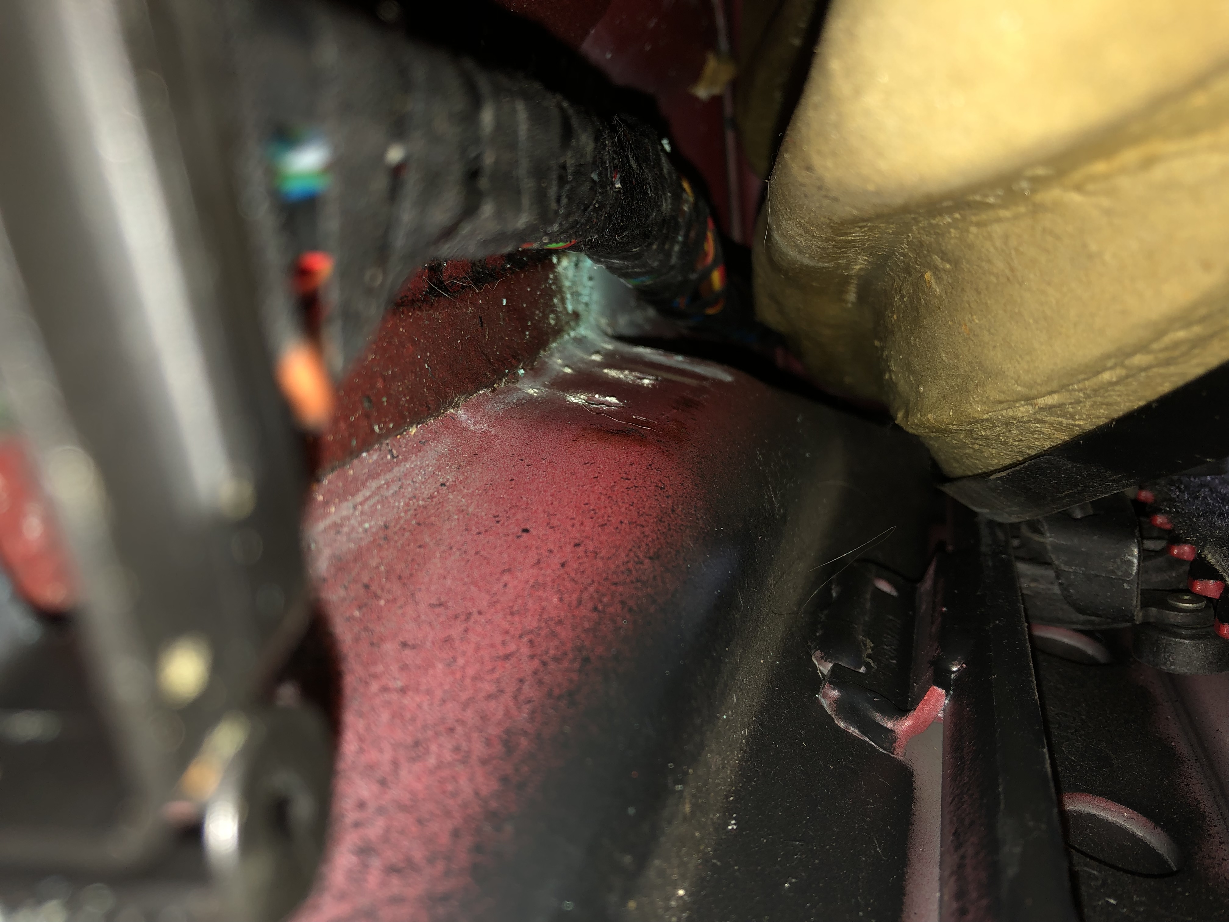

After a lot of research I found that there was a connection under the passenger seat by the transmission tunnel. Knowing this and the fact that this area can get damp with scuttle drain hole issues I thought it best to check this area out. I moved the seat as far forward as I could, pulled the carpet by the tunnel and the seat runner out and took a picture of the cable run. As you can see there is copper oxidation, a sure sign that copper cable insulation has failed.
Unfortunately from this position I couldn’t really see what was going on let alone fix the problem so I set about removing the seat.

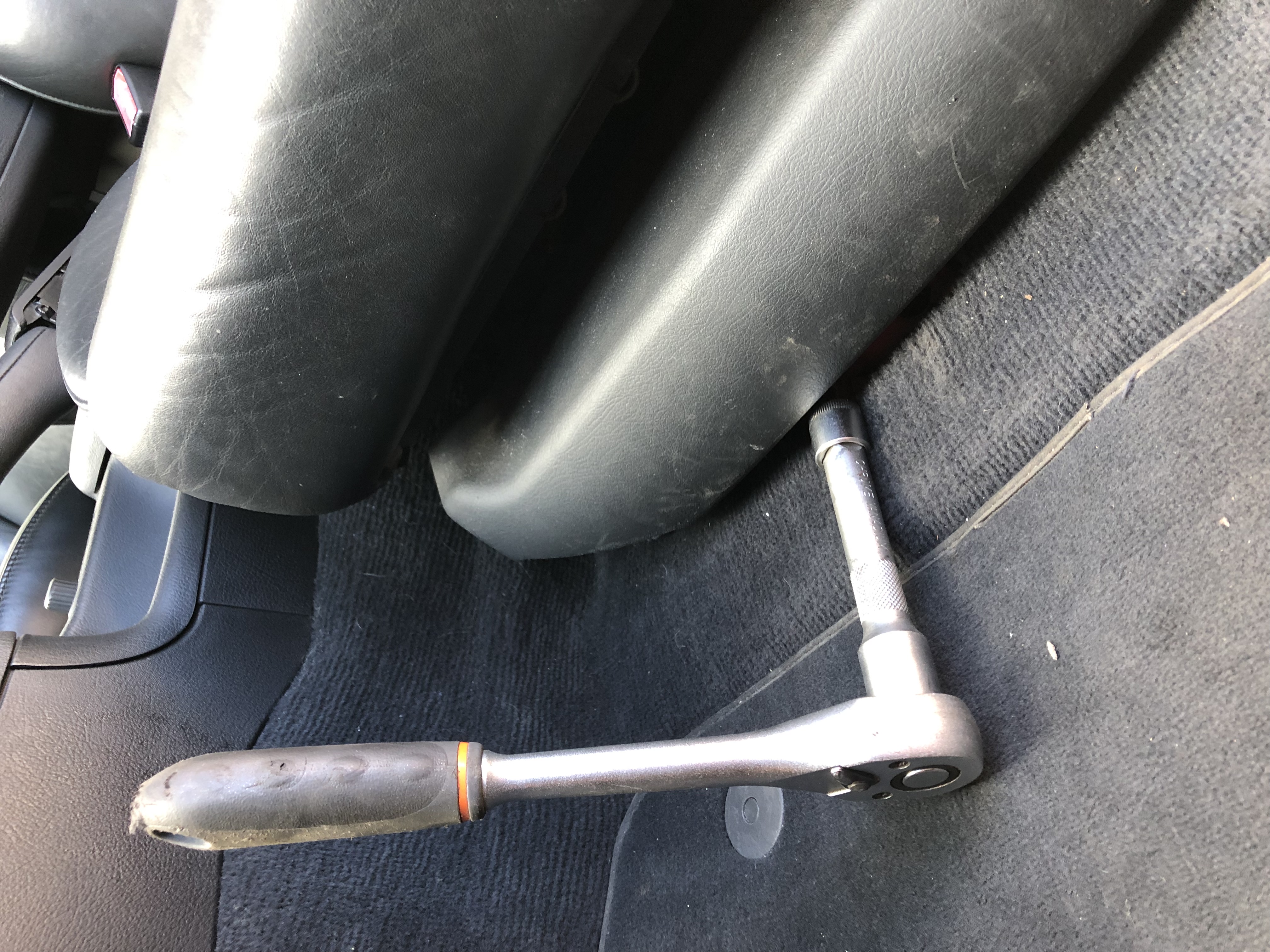

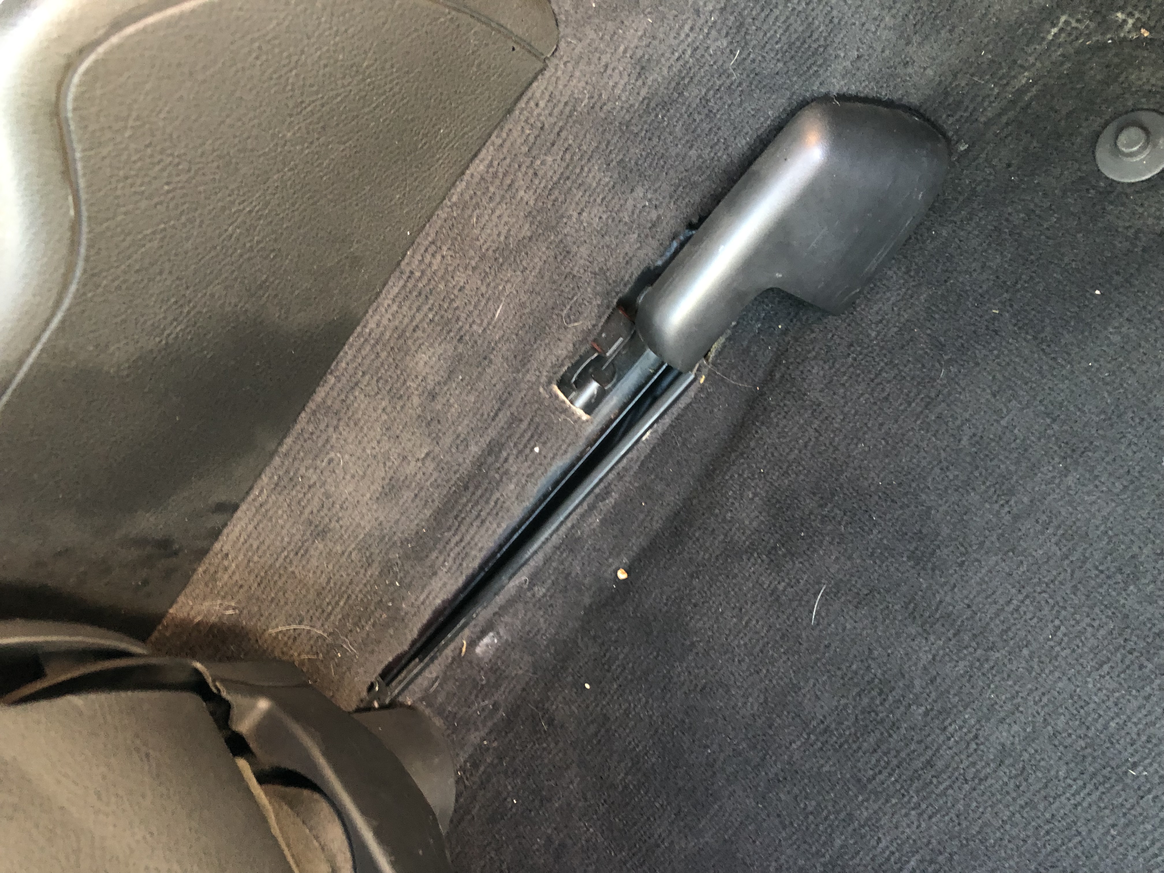

Remove both side end caps from the seat runners, they just popped off.

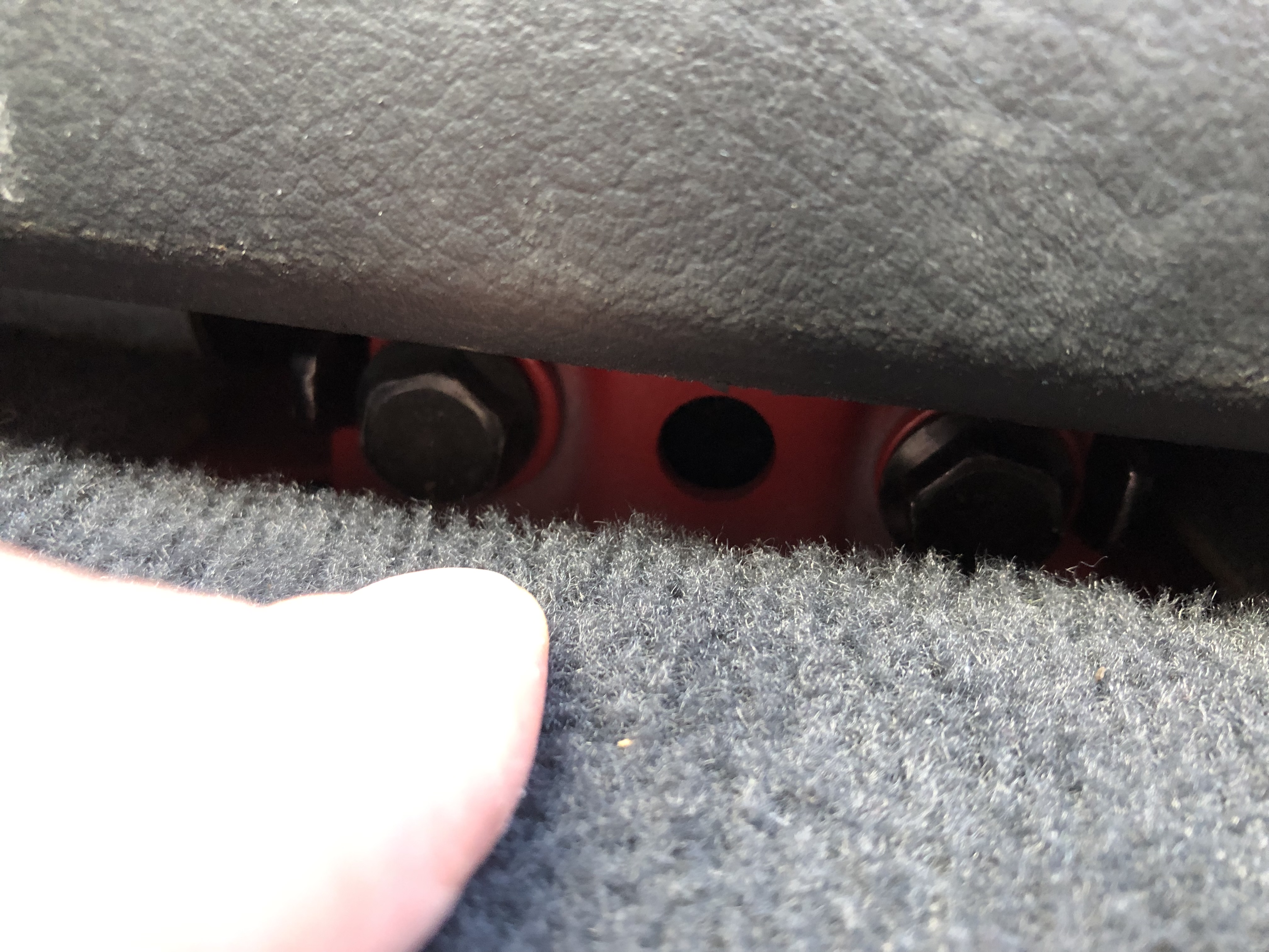

Then, with the electric seat adjuster, move the seat to near it’s furthest most position. Now remove the two 13mm bolts from the front of the seat under the plastic trim.
Unfortunately to be able to really get to the issue I had to cut the carpet a little from the front end of the seat runner cut toward the under seat vent. The cut is around 6” and is totally hidden when the seat is refitted.

Now you’ll find that the all the red and orange strip cables are joined together in this one connector (there were seven lines in my connector). Gently twist the connector and the cable will come away.
Peel back some of the insulation and join the cables together. I used a wago block but use your preferred method.
Now reconnect the battery and check the voltage at the headunit connection block. You should now be getting 12v across the SAFE pin. You can now plug your RNS-D back in and enter your code.
