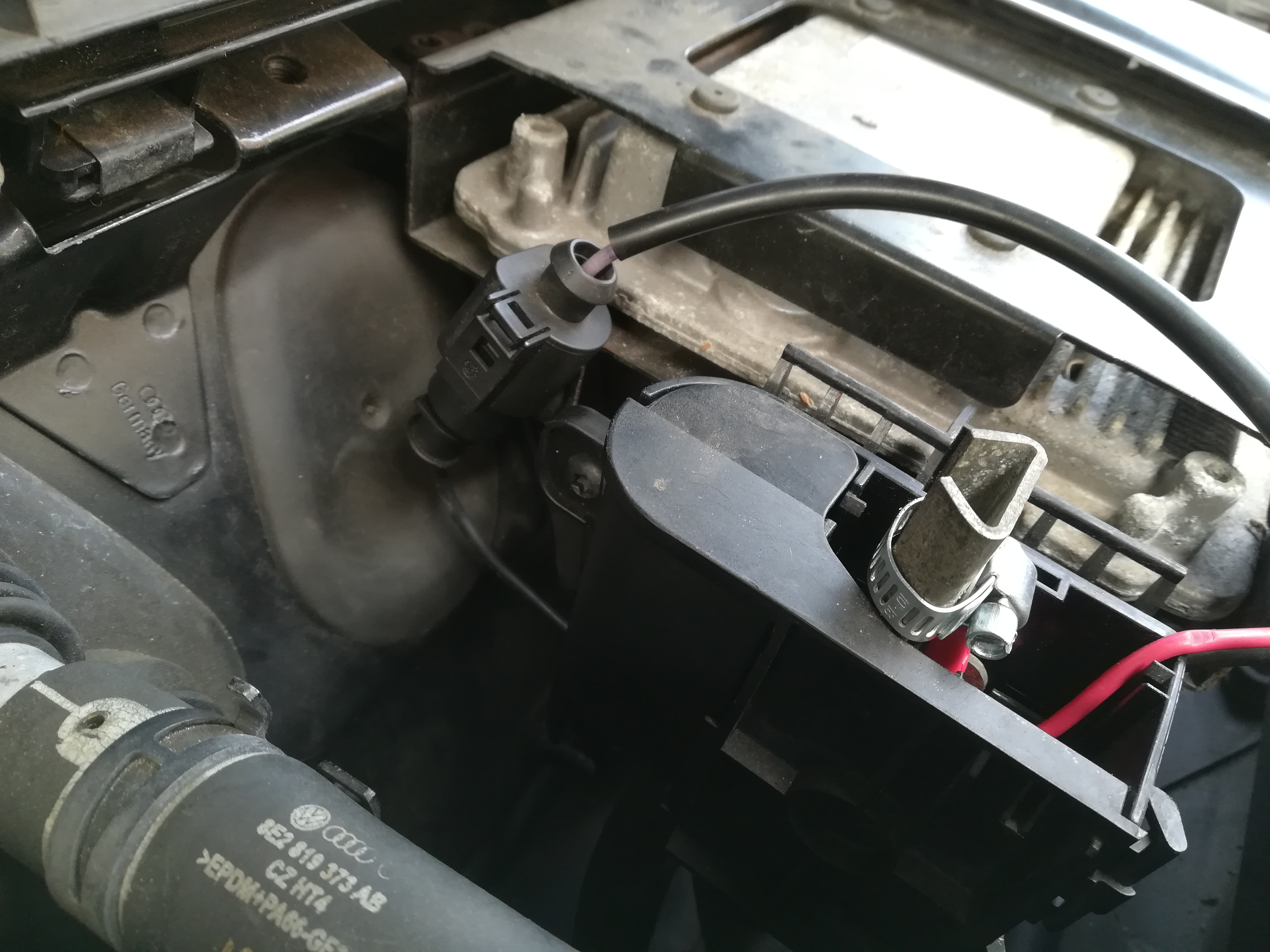

Another thing to check is the following connection next to the positive terminal under the bonnet: This is the wire that has 12v put through it to trigger the starter motor. Check which side goes to the ecu if you're going to measure it.
If you get power through this and the car wont start, this will also confirm your relays etc are ok.
