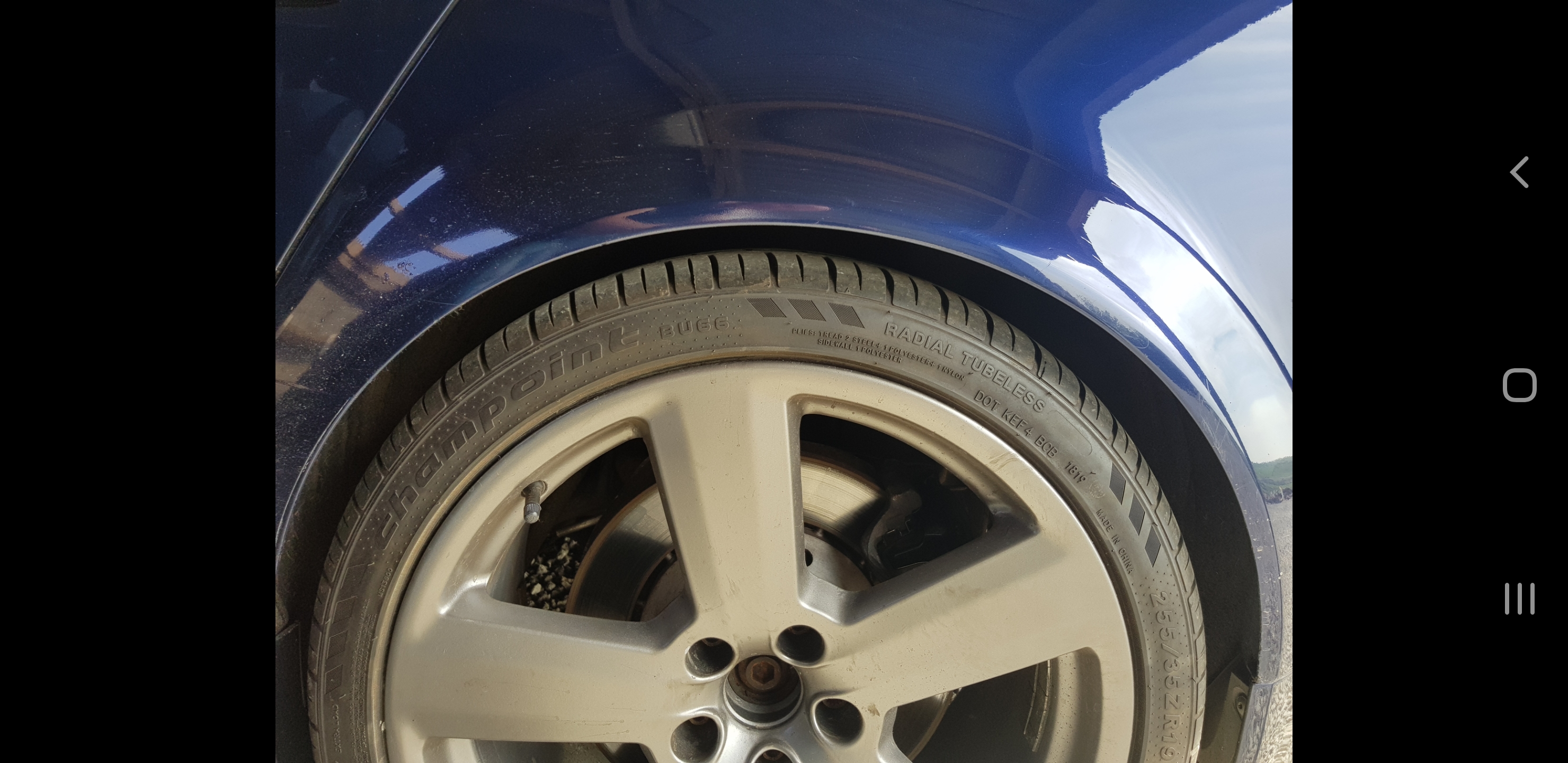

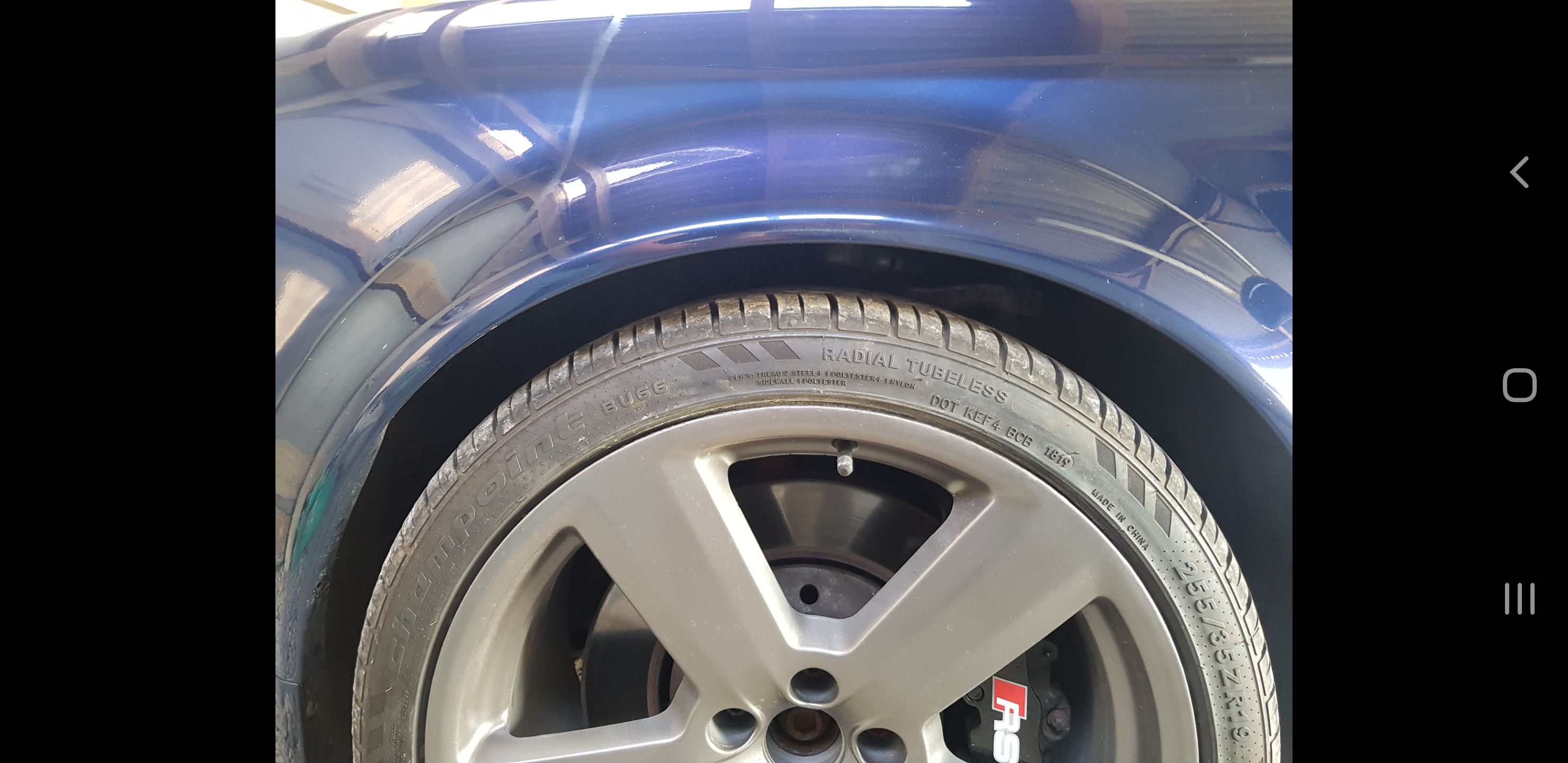

I guess you saw my post on the other forum Matt? Its nowhere near as high as an Allroad but comparable to other '6s I have seen at AITP.
The whole lot cost me £235 but Larkspeed have the Konis at £130 each for fronts and £120 each for rears. I think springs if you cant get stock use H&R 29298-1 about £200.
Sorry for using screenshots but it wouldn't let me upload the originals.

Re: Koni Sports and original springs adjustment
Looks like OE height.
