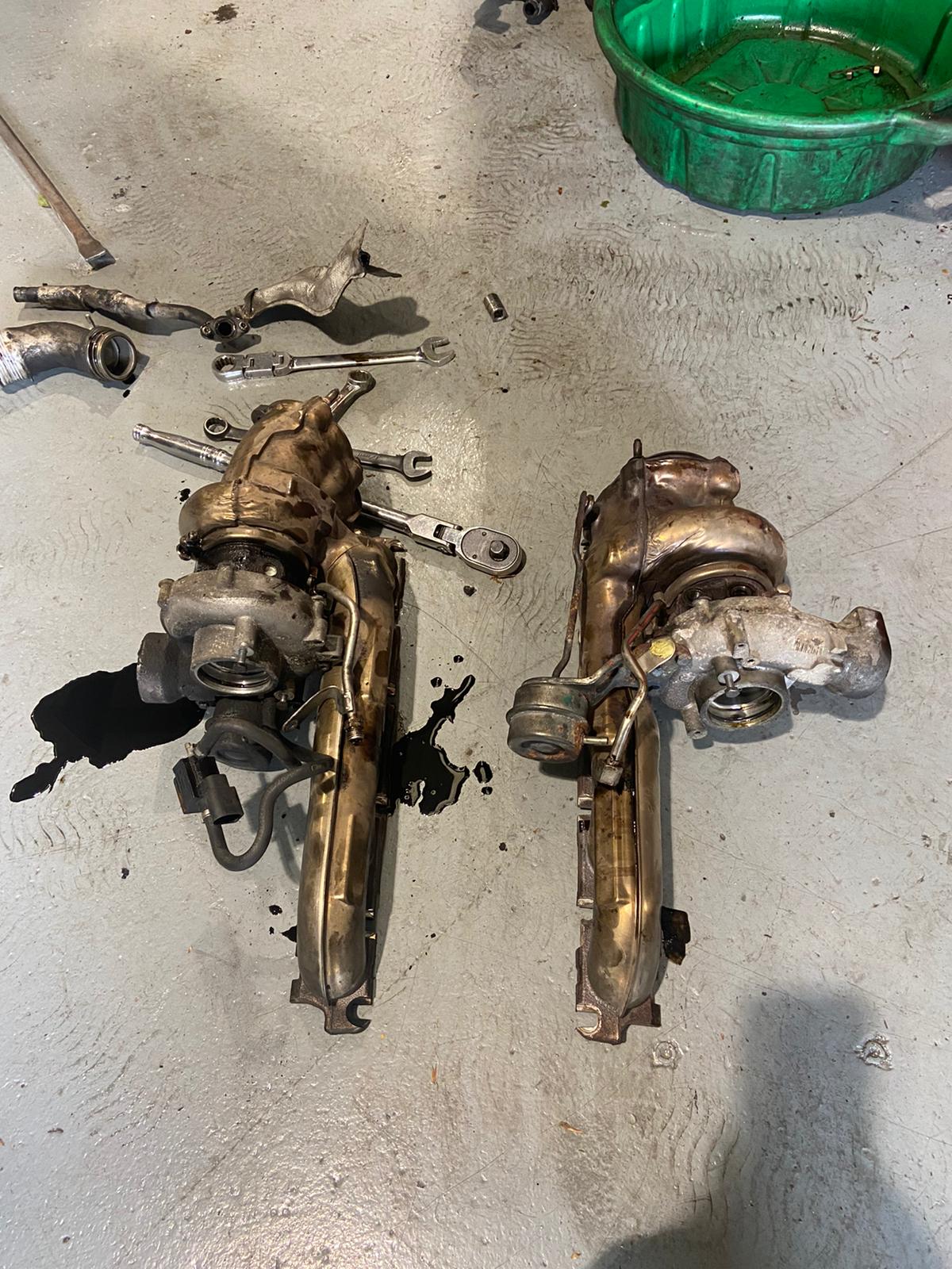

So after 4 weeks of ownership the car started to smaller a bit
Only smoked if left after a drive
Started to smoke on and off for a few days so thought I’d leave it parked up and wait for MRC to reopen to get checked over
Anyway emailed MRC and they said I can drop it off and Doug would have a look at it when he has time
Emailed them back to get details etc but no reply
So left it parked up for about a week and started to drive it again
No smoke
Then 1 day after started to smoke again
Anyway dropped it off to Dave @allmotion and have been informed it’s the turbos
So car is mrc stage 2
Will be going the hybrid turbo route so once engine is out turbos will be sent off to get rebuilt
Then will be getting dropped off to hardknockspeedshop for 3” system all the way
Then back to Dave for a remap
Anything you guys should recommend changing while engine is out?
50p oil seals were done about a year ago
Along with coolant pipes
Shaz

Right hand side turbo is leaking bad

It certainly is! Was the engine removed to get them out?
Biturbos don't usually fail together, but If one of the turbos has gone, the other is probably close behind.
Nick

Yep engine out job
Rocker cover gaskets are weeping a bit
So will get them changed
Also had a very tiny coolant leak which also will be getting sorted
Then off to the lads @hardknockspeedshop to get the 3” system made
