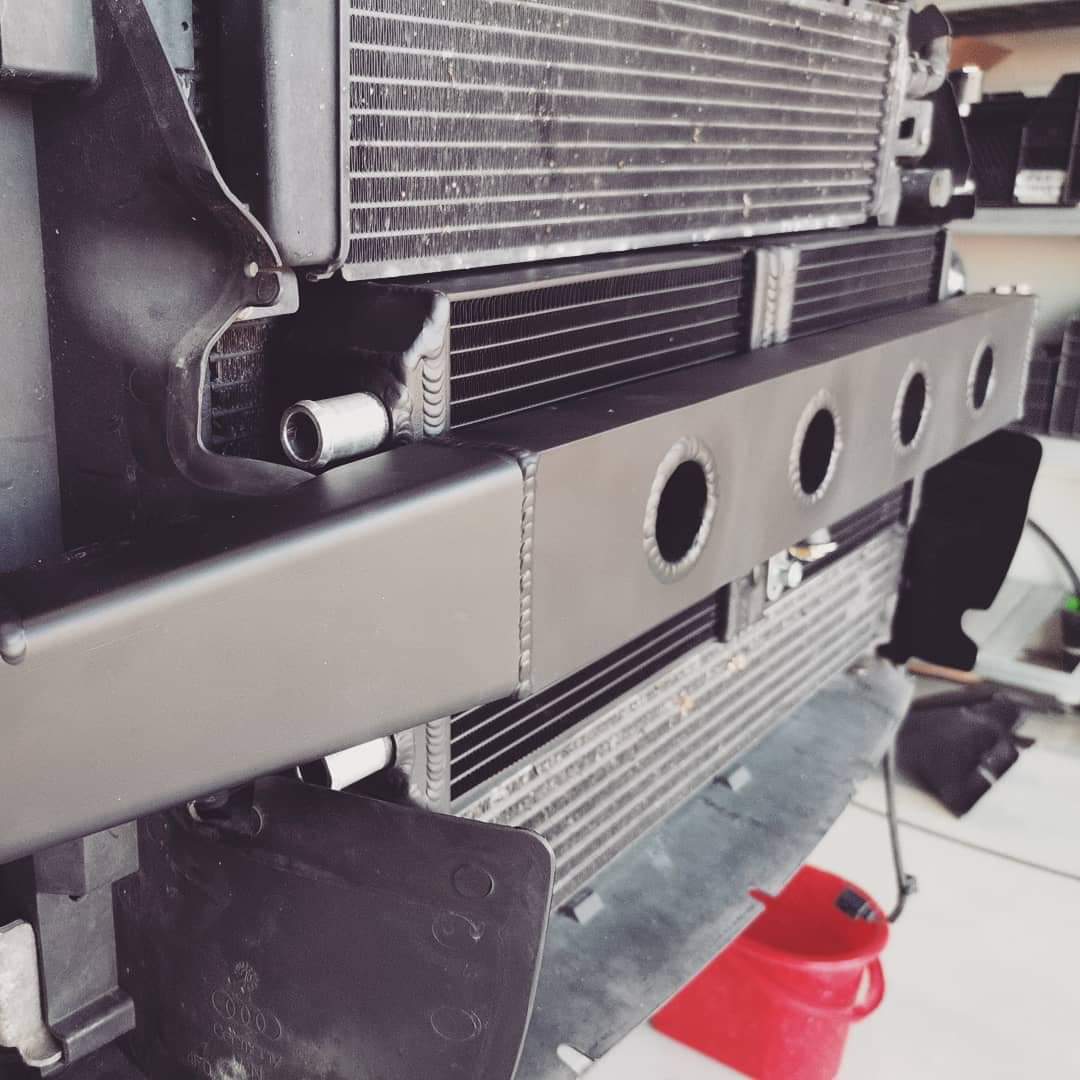

I'd guess that they'd be deleted as there's little or no room behind them. Actually, there's little or no room anywhere.welwynnick wrote: ↑Tue Jul 23, 2019 9:25 amIt seems like the IC is taking the space occupied by the water heat exchangers behind the IC's - so where are they going to go? Further backwards?
Re: New intercooler offering on its way
Check out Wagner Tuning´s Instagram account. There you can see how they solve it. They delete the ones behind the intercoolers and put a bigger radiator in the front with a modified bumper reinforcement.Jim Haseltine wrote: ↑Wed Jul 24, 2019 9:54 amI'd guess that they'd be deleted as there's little or no room behind them. Actually, there's little or no room anywhere.welwynnick wrote: ↑Tue Jul 23, 2019 9:25 amIt seems like the IC is taking the space occupied by the water heat exchangers behind the IC's - so where are they going to go? Further backwards?

They seem to be taking it pretty seriously, and if RS Engineers are involved, I wouldn't be surprised if we see one thousand bolt-on horse power pretty soon.
I'll be interested to see what RS/TTH/THT get out of this, in particular the shape of the power curve, which often reveals a lot. The stock IC is a bottleneck, so these should help open up the top end.

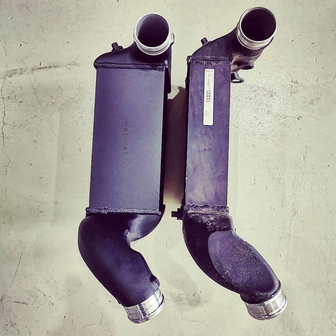

Wagner have launched their new RS6 C6 intercoolers, though only on their German and US websites, and they're not available until next month.
As you'd expect they're quite expensive given that there are two new auxiliary coolers and a new bumper beam - 2490 Euros or dollars
I estimated they would be 8809 cc each, and they actually come out at 8730cc. They're larger than any other coolers for the C6, or B5 or C5 for that matter.

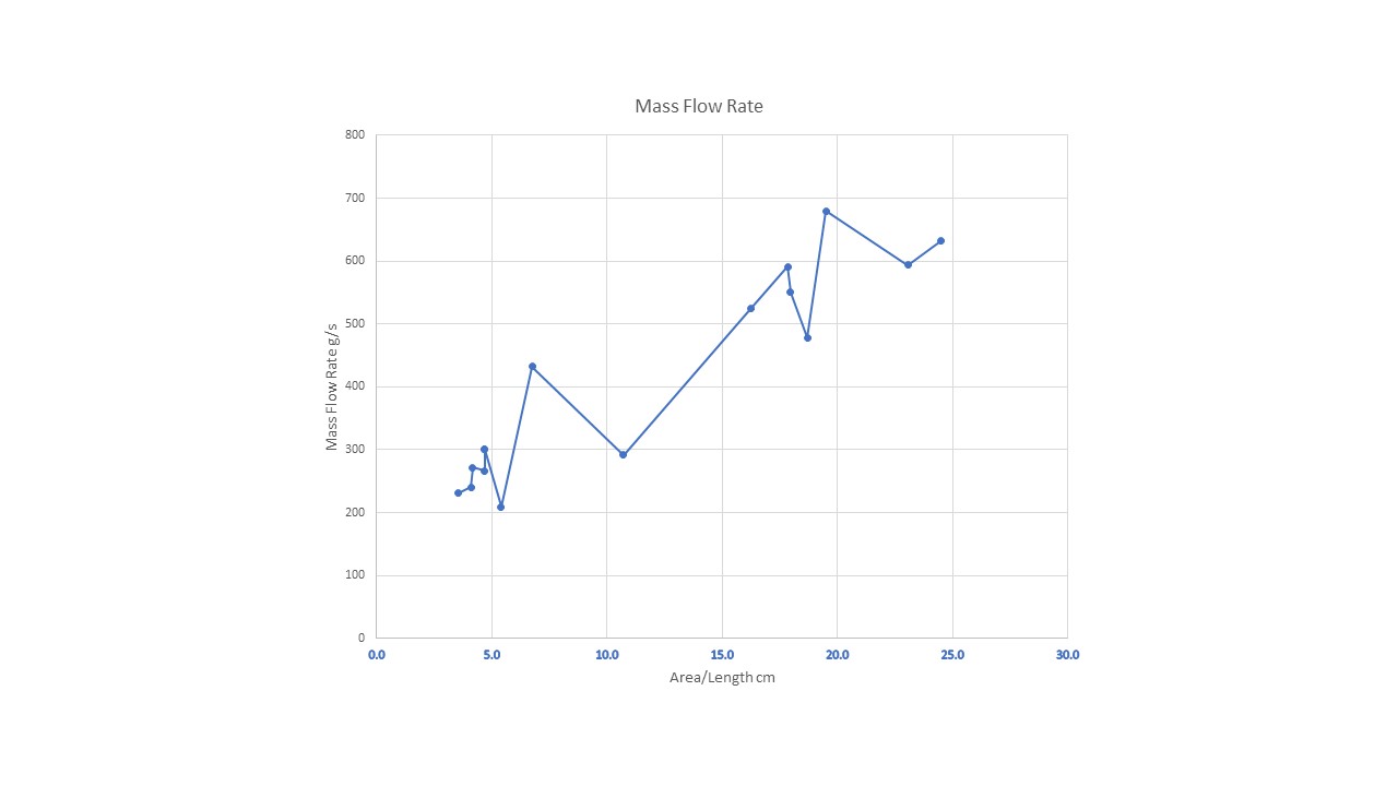

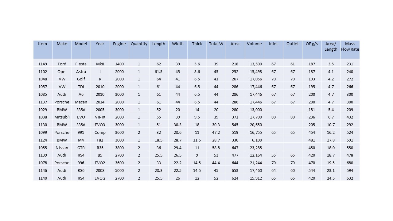

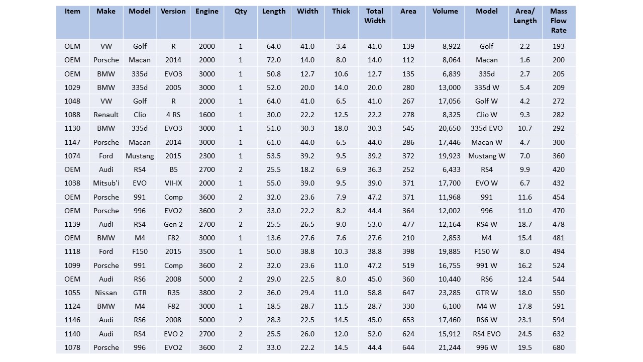

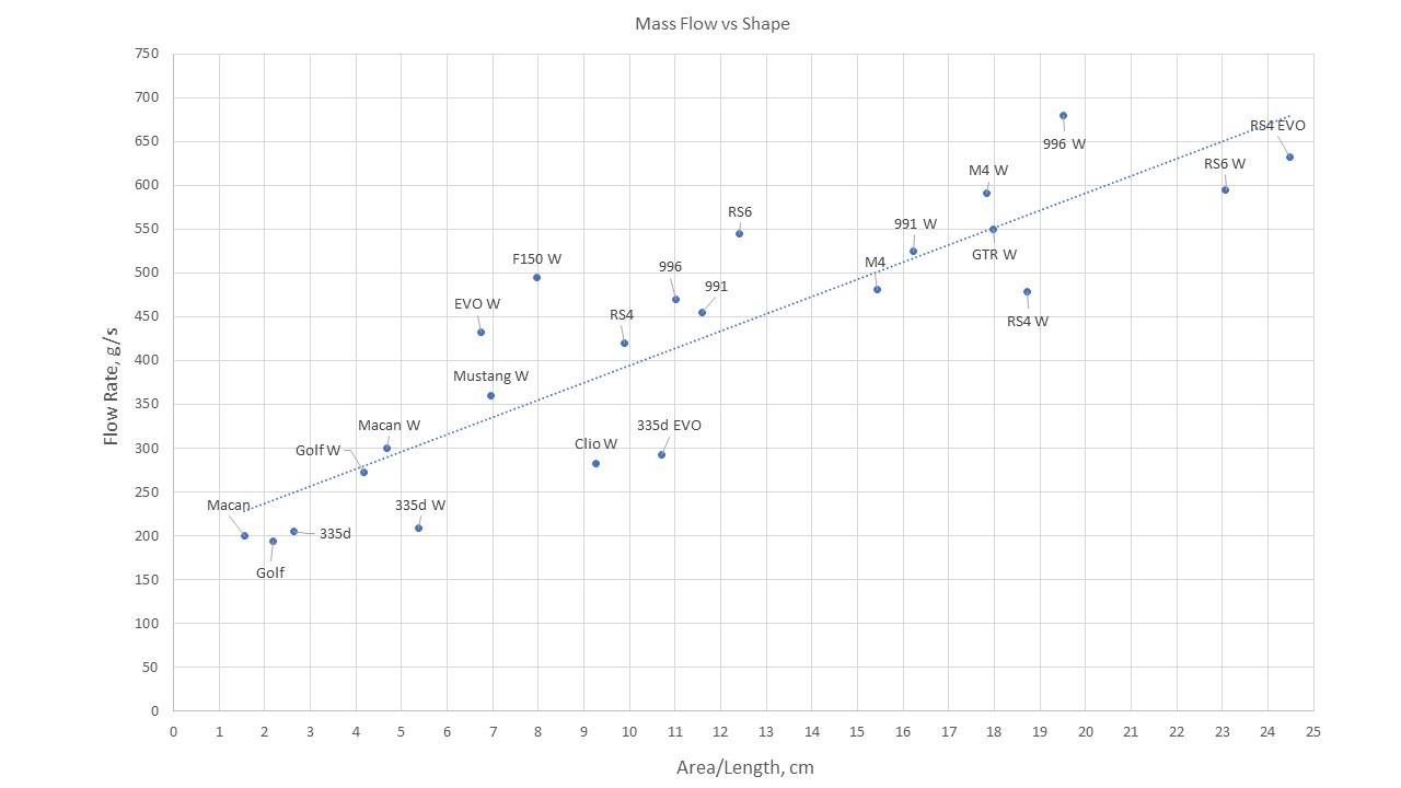

Well, I got bored with social distancing, and thought I would try and find out what made intercoolers tick.
So I took advantage of the information that Wagner Tuning published, and compared some intercoolers.
I took the dimensions (in cm) and flow rate measurements and looked for trends and correlation. I calculated the frontal area, as seen by the ambient air passing through, and the cross-sectional area, as seen by the charge air passing across. I also calculated the volume of the intercooler matrix, which I think is the most important overall parameter from the point of view of cooling capacity and flow capacity (it's also consumes cost and space). I then compared the parameters against each other. Sometimes there were no significant trends, but a few combinations looked interesting.
Area/length is an arbitrary measure of the shape of the IC - whether it's short and fat, or long and thin. It's the number of sq cm total cross-sectional area seen by the charge air, divided by the cm length of the tubes the air has to travel down. It predicts that thin IC's have small area, low A/L and high restriction, and short IC's have high A/L, low restriction and low pressure loss. It's analogous to an electrical resistor, or a thermal conductor, where charge or heat flow through a material is proportional to the cross-sectional area, and inversely proportional to the length of the conductor. Do heat exchangers behave in a similar way?
Quantity: 1 = FMIC, 2= SMIC
Length = distance travelled by charge air through heat exchanger matrix
Width = width of SMIC or height of FMIC
Thick = thickness of heat exchanger matrix
Total W = total width (double for SMIC)
Area = Thick x Total W = area of matrix as seen by charge air
Volume = length x thick x total W
Inlet = inlet port diameter in mm
Outlet = outlet port diameter in mm
OE g/s = mass flow rate of stock IC
Mass flow rate = Wagner IC
So is there a correlation between flow rate and the size and shape of the IC?
It's not a direct relationship, but it's fairly good.
Broadly speaking, the higher the A/L the higher the mass flow rate.
Large IC's are better than small IC's.
SMIC's have higher flow than FMIC's.
Large charge air ports flow better than small ports.
The BMW M4 is a water cooled chargecooler, and flows well for a small matrix.
Neither of the BMW 335d coolers flow well for some reason.
The EVO IX exceeds expectations due to it's large inlet / outlet.
The RS6 has the highest flow of any stock IC (Edit - correction - that would probably be the Porsche Panamera)
The highest flowing IC's aren't necessarily the ones with the largest matrix - they need short tubes and large ports, too.
Wagner took all these measurements at a pressure differential of 175 mbar or 2.5 psi, which is quite a significant drop.
By contrast the max pressure drop across paper air filters is usually about 5-10 inches of water, around 0.3 psi.
So what's the significance of mass flow rate? BHP roughly equals 1.1 x flow rate in g/s.
And the pressure drop increases with the square of the flow rate (or roughly the square of the power).
Nick
Nick
Edit - just realised I should have included the OEM IC dimensions as well; they're all valid data points.

welwynnick
- Posts: 573
Here's the data with the OEM sizes added (minus the GTR and EVO which I couldn't find easily). It makes for a clearer trend:

Well, well. KWE didn't want to be out-done by Wagner, so they've introduced an EVO 2 version of their existing upgrade SMICs that are even bigger:
https://www.ebay.co.uk/itm/Audi-RS6-4F- ... 0290.m3507
4.59 litres per litre is more than double stock, and area / length = 29cm, so it's off the scale. It means the flow restriction should be low as long as the inlet & outlet are big enough.
Nick
By "network" I think they mean "matrix". It's so new there's no pictures and nothing on their website yet.The KWE high-performance intercoolers have the network dimensions: 255x280x160mm = 22.9 litres / pair (which is up there with the biggest Porsche and Nissan upgrade IC's)
Nick

From the Advert -
"The fans in front of the coolers and the water coolers behind the coolers are now gone, it becomes a large one in the middle
Water cooler from Mishimoto installed, this is as large as the 2 series water coolers but has 50% more volume."
So sounds just the same as the Wagner offering but no word yet on whether it also includes a new front crash bar too like Wagner.
