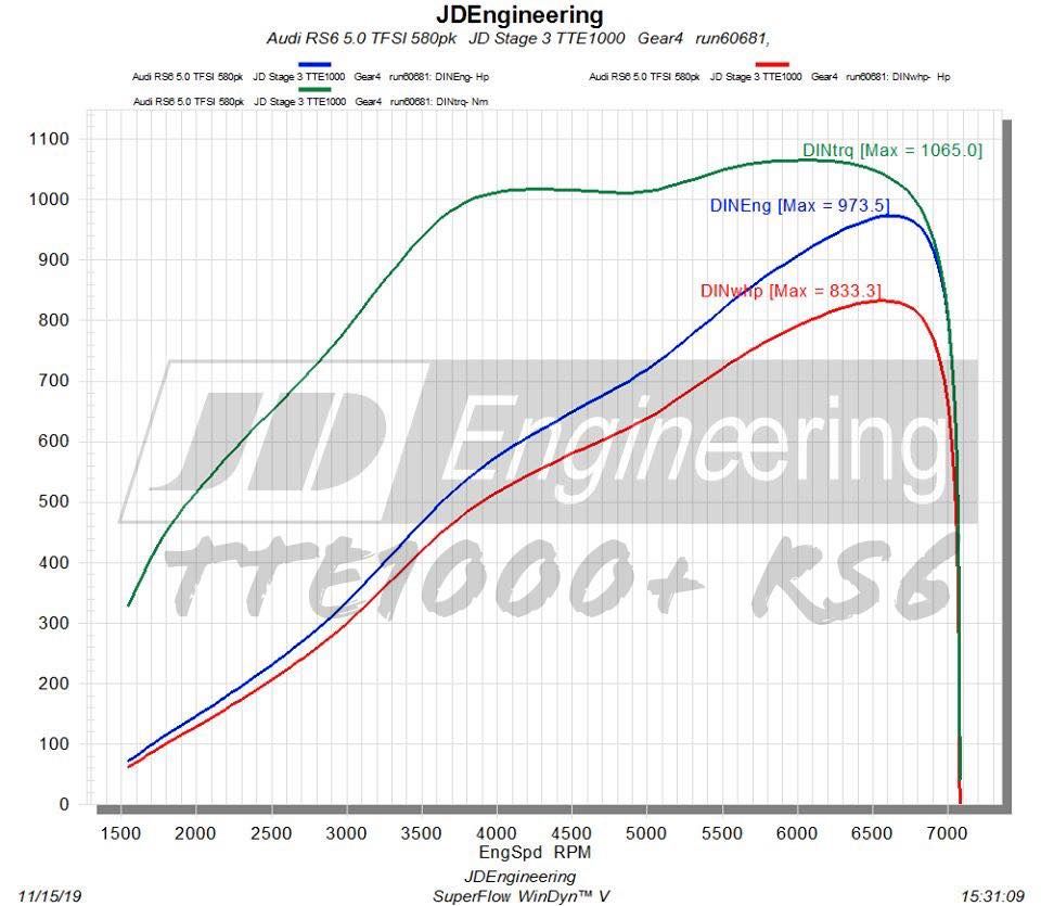

JD Engineering tuned an RS6 stage 3 TTE1000 to 973 bhp / 1065 Nm.
I presume the boost was held back to work with a stock gearbox.
There are quite a few stage 2 cars with stock turbos and 'boxes that make that kind of torque.
