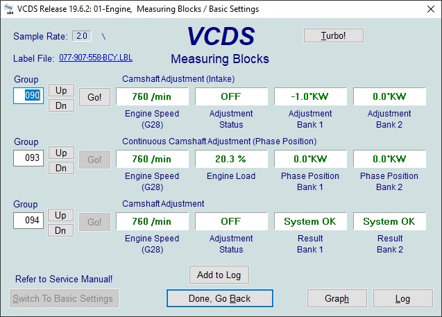

Just a quick post seperate from the how-tos to note that the Vaico camshaft adjuster I fitted as an alternative to OE is good. 👍 They're about half the price of OE, but quality of the unit seems to be on a par with OE (I suspect comes out of the same factory - that casting looks identical bar the audi logo), and cam timing & phasing is spot in.
This is my car this morning - one adjuster is OE with new shoes (sourced as per nobby's thread), the other adjuster is the replacement Vaico one:
Can't argue with that. (And Tony - I left it warm up fully this time so idle speed is correct. :bigblink: )
I'll also vouch for the adjuster shoes from Nobby's thread. You can see on my OE phaser, it's restored the timing spot on as well. Those shoes also look identical to the ones on the Vaico ones and are superior to the Blauparts ones.
Obviously also tested the timing change all works correctly to - all reported corrected out of VCDS.
(Phew - didn't fancy taking it apart again)

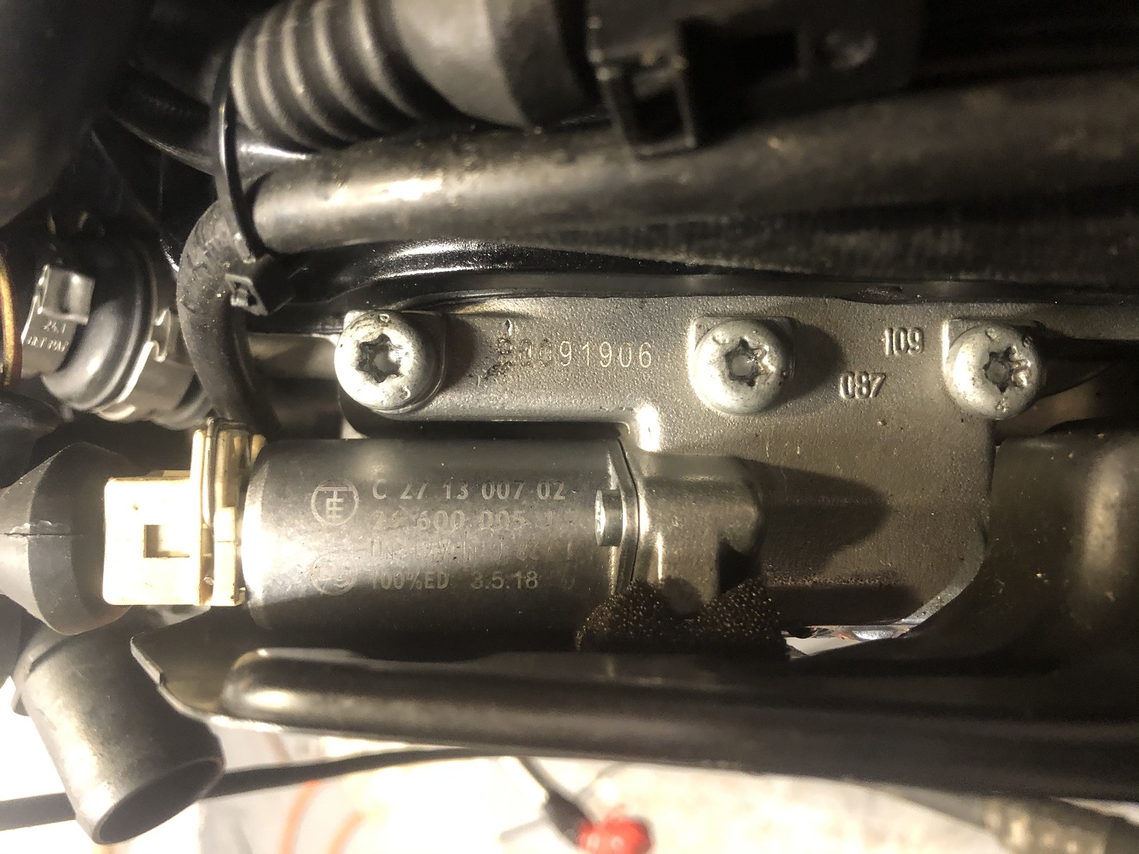

Hi
In the middle of strip down to do these as one failed
Are the part numbers 077 109 088p right and 077 109 087p left???
I’ve found them both in auto doc but it’s saying they’re not compatible with the rs6 but or numbers are the same

That's what the parts catalogue says....
https://audi.7zap.com/en/rdw/audi+rs6+r ... 109010/#30

I ignore their compatibility lookup mostly and just use the OE part number as my cross check.
