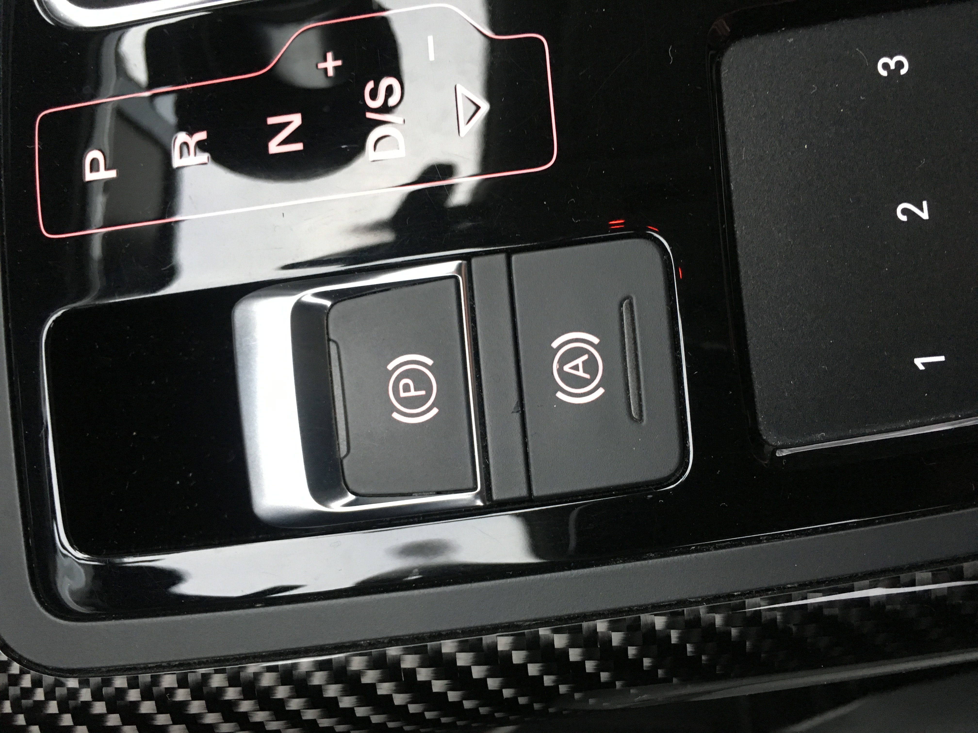

Hi,
I have a 2012 A6 Avant and the handbrake comes on automatically when the ignition is switched off - Great!
I have a 2014 RS6 Avant and the hand brake does not activate automatically, which is a pain.
Any ideas on how I get the handbrake to come on automatically when leaving the RS6, please?
TIA.
Paul.

Thank you.
I can't recall ever pressing that on the standard A6.
I've just had a press in the RS6 and I think it is something to do with auto-release of the hand brake.

I seem to recall there was an option for this with VCDS and I activated it but it made no difference.
That button with the A on it applies the brake when you are stationary and press the brake pedal hard and stops you rolling forward when you release the brake and will only work if you have your seat belt on. This is not the same as automatic handrake activation.
