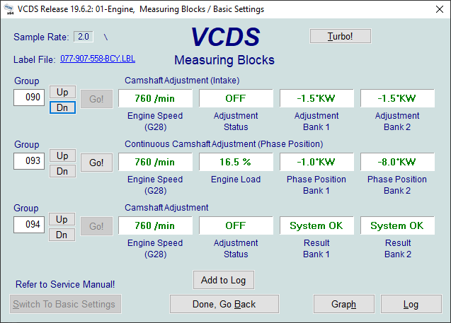

Have fired the car back up this afternoon and the Bank 2 (Nearside in the UK?) phase position is out of spec on block 093, but in spec on block 090 - but I can't explain why. Obviously I'm missing something - but what?

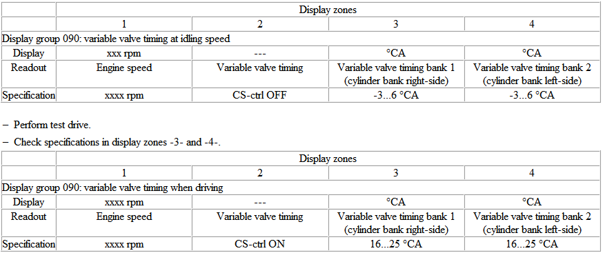

Measuring Block 090 is OK : -1.5 on both banks with the book calling for -3 => +6
But Measuring Block 093 doesn't look right. Or is this a red herring?
Elsawin only makes reference to measuring block 090 & 094, I can't find any reference to 093 in there at all? (see attached pdf)

93 is the one to go by. The 90 is the value of the dephasing after the ECU takes into account (through adaptation) the difference in timing. This is how I understand it.
So if your timing is off (group 93) by, say, 4 degrees which is still in spec, then after adaptation and if your dephasing system is working ok, when no dephasing is required will read 0 degrees.
I’m not 100% sure on the whole cam timing VCDS thing si I’m open to convincing arguments to the contrary.
I guess I’m trying to say that 90 is only useful for testing the dephasing. Not the absolute timing.

8 degrees - this means, if I bang the crank pin back in, I should see the intake cam notch out of line (retarded/trailing) with the cap by about 1.5mm (assuming about a 25mm shaft dia just there)? I will check it. Enough to eyeball, certainly.

What I think is that 93 is absolute timing, but probably crank degrees not cam. So 4 degrees retarded on the cam, not 8.
And 90 is relative timing that validates the adjuster is adjusting.
I suspect that a lot of cars might be out of spec, FWIW. Plus elsawin (pdf above) only calls out block 90 and 94, which is also confusing.
