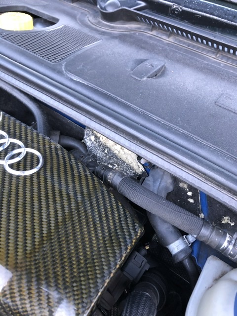

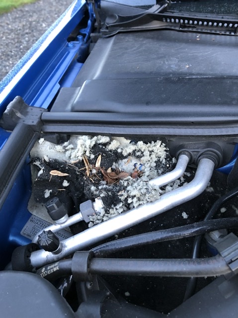

In other news though some mice got in. Anyone any tips on how the remedy this?
