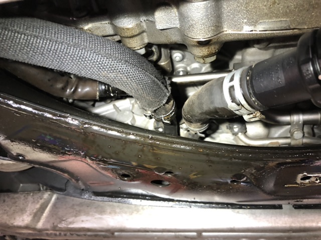

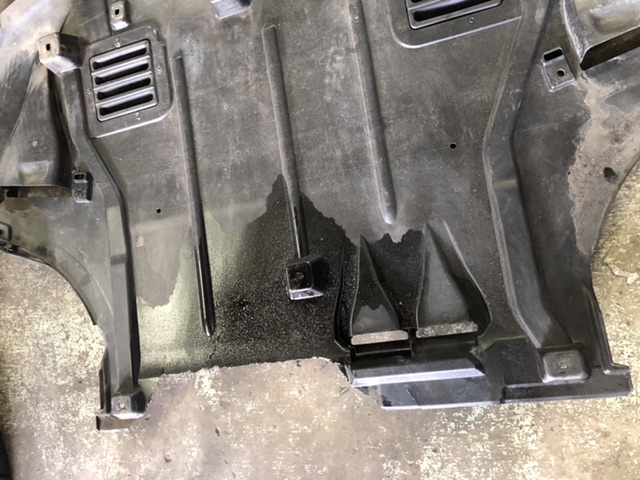

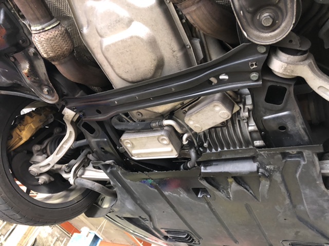

Well ... that didn’t last long. Heh. Found oil on the under tray and took the under tray off. Seeing this (see pics). Any advice? Is it the engine seal or is there something that can potentially be saved?
Re: Oil leak question
Basically if standing underneath facing the front of the car, the leak seems to be around the left side slightly. where the two black hoses are.
it concerns me that the aluminium block has some yellow colouring ... (last pic)

Yep, that's 'the' oil seal which is leaking - although judging from the pictures either it's not leaking a lot or somebody has done an excellent job of cleaning most of the evidence. You're looking from the rear, it's visible (just) from the front by looking up and back between the rollbar support and the subframe. It's not easy to see because of the metal pipes that the two pictured black hoses fit to (with the hose clips conveniently located directly above the subframe - thanks for that Audi).
It won't get better so at some point it'll have to be sorted. When that point is depends on things like how much the leak annoys your OCD, how long you can live with the drips on the ground and whether there are any other jobs you want doing. I lived with mine for 3 years but it had got to a point where even if I hadn't had to pull the engine for other things I'd have sorted it this summer.
See all the oily grit and sh*te on the top surface of the under tray? Don't clean it off. Wipe off the rest of the oil but leave that stuff - it does a pretty good job of soaking up the oil, if you clean it off the oil runs straight off the tray and onto whatever the car is parked on. I've got a drive and a load of concrete slabs that will need a serious degreasing and jet washing once I can move the car.
The yellow colour is nothing to worry about - it's the effect of heat on a slightly oily surface.

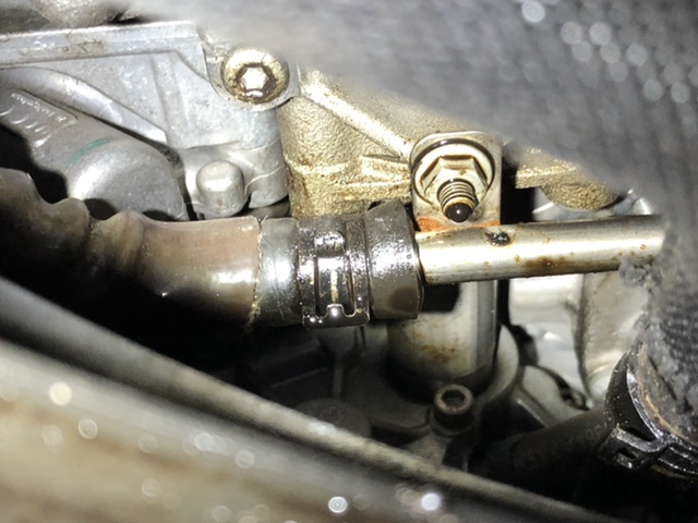

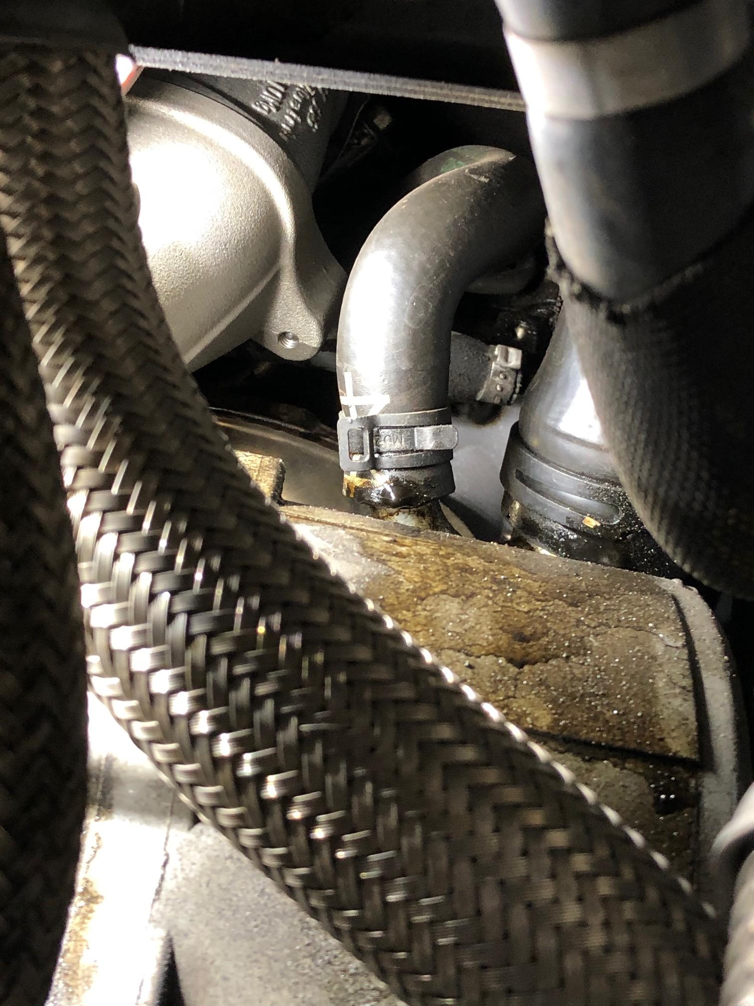

Right. Reviving the thread. So I had the gaskets replaced, without dropping the engine, so it "only" took a month (though the price wasn't (comparatively) too terrible). I was just doing a sanity check on the engine after about 2 months of driving the car (took off the undertray) and was looking for oil leaking.
On the upside, I am happy to note that there are no more drops on the undertray, so there's no "immediate" leakage.
On the downside, I still see a little bit of oil in a few places - but I'm not sure if this is old oil camping there, or if there's a REALLY slow leak that I basically should just forget and not worry about. Would appreciate some opinions, though.
The oil spots I was able to find after spending about 30 mins with a light underneath the car were:
- The pipe in the centre of the picture: the oil felt fresh'ish, though it could've been from the previous leak. - The mounting point at the centre of the picture... ..... this one here - had a drop of oil in it. - This socket had about two drops of oil in it that looked somewhat fresh. - Finally, this hose here had a fresh drop: I'm perplexed at these because none have leaked onto the plastic undertray, so I want to hope these aren't actually real leaks (maybe a bad job filling oil or power steering fluid, which I most certainly dropped when I topped it up?)
Any thoughts on these?

The first pic and the last are the turbo oil return lines to the pump, they can weep slightly.
The RH return and THE oil seal both end up with oil getting into the subframe (either from on top or wicking in from the undertray via the mounting screws - it takes a long, long time to drain, even after degreasing and jet washing my subframe twice it was still draining.
The socket is one of the oil drain points.

In case it would be necessary in the future - there is no reason to drop the engine to replace the pipes. The intake manifold needs to be removed, then you'll have access.
Edit: This is valid for LHD cars. I don't know if there's something on RHD cars that would make it more difficult. The long metal pipe needs to be split from a rubber hose right behind the oil filter housing.
