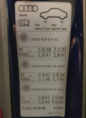

I bought my RS5 with 19". The tyre pressure Sticker on the door says the winters (M&S) are 235/40 R19

Any one know the pressures for the 265 35 19"
Mine does nog have the 19" on the door Sticker
From scouring the internet i have came up with 42 psi front 38 psi rear
I just want to confirm this if anyone has the 265 35 19 on there door Sticker

36psi front 32 rear (that's up to half load). I will go back and heck if you need fully loaded figures.

Re: Winter tyre size
Cheers are those figures for M&S tyres
The ride is better even on dynamic mode
yes that's what on my Sticker but no 19" 265 pressures
