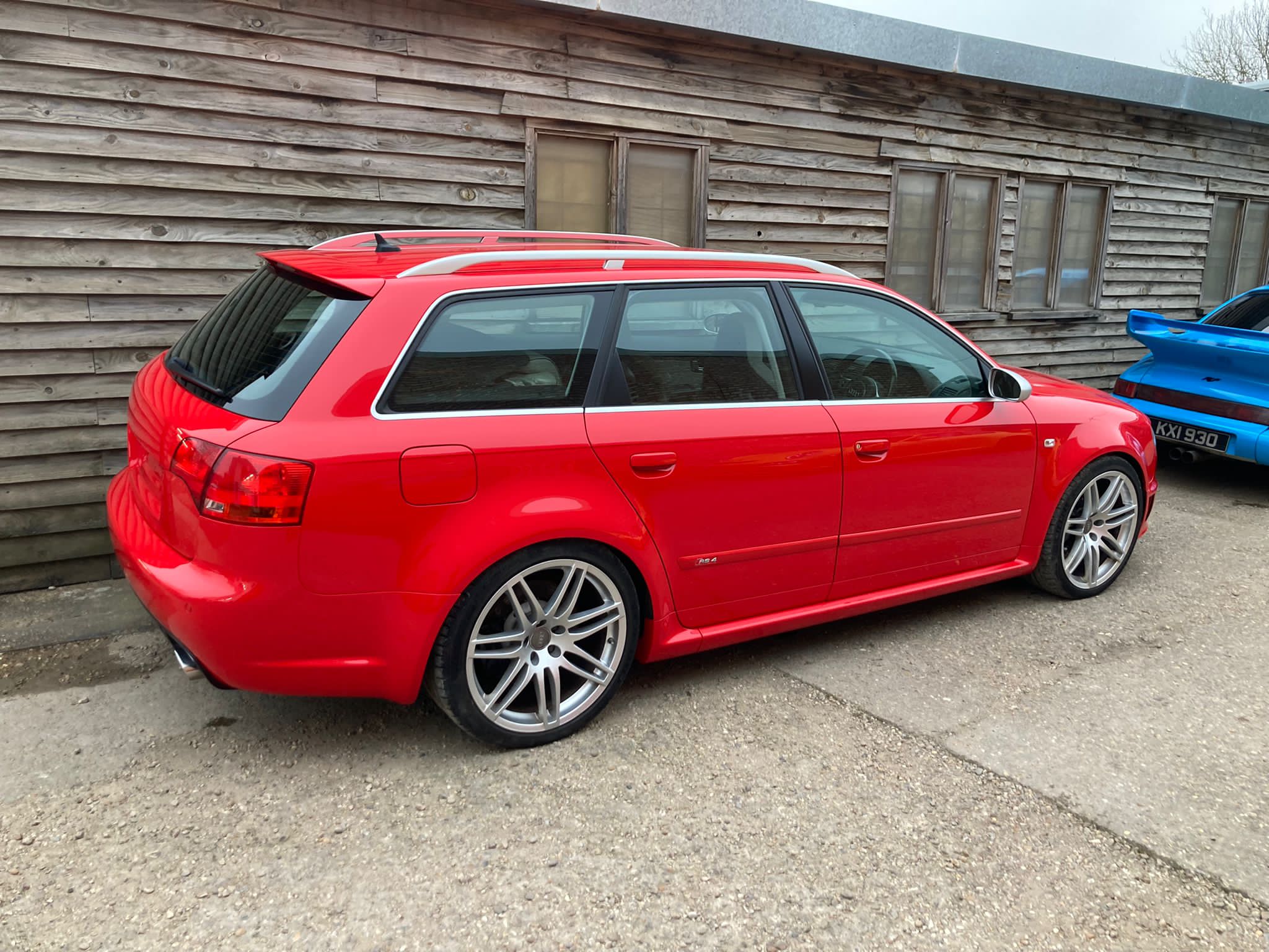

Misano Red RS4 B7 Avant
Re: Martin's RS4 B7 Avant Build
Not the best pictures but it was only after looking at the car on a sunny day that I fully appreciated the quality of the paintwork.
Better than new.

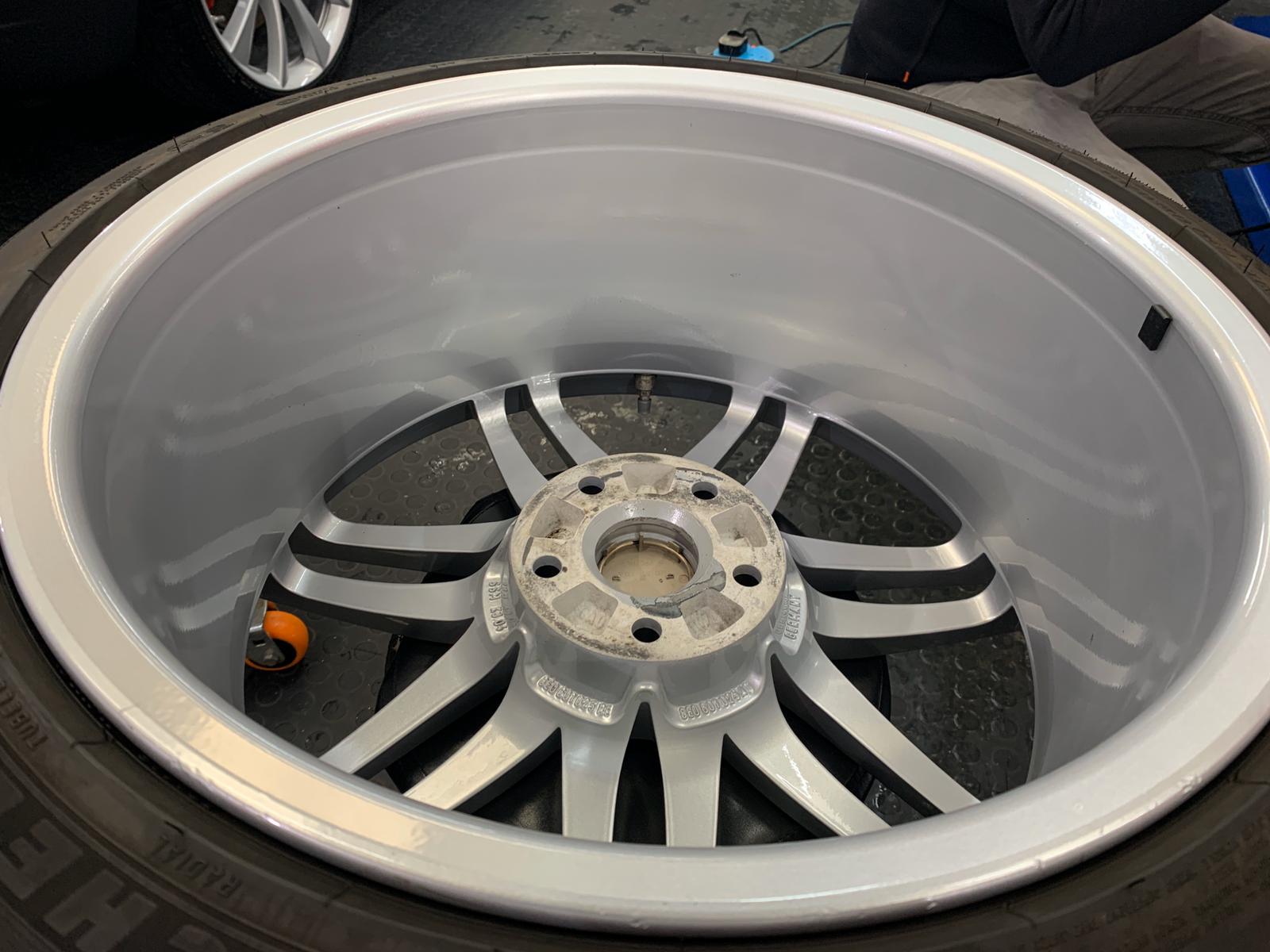

Whilst it was at the detailers I got them to ceramic coat the wheels and calipers, this should make them a bit easier to keep clean over the winter.

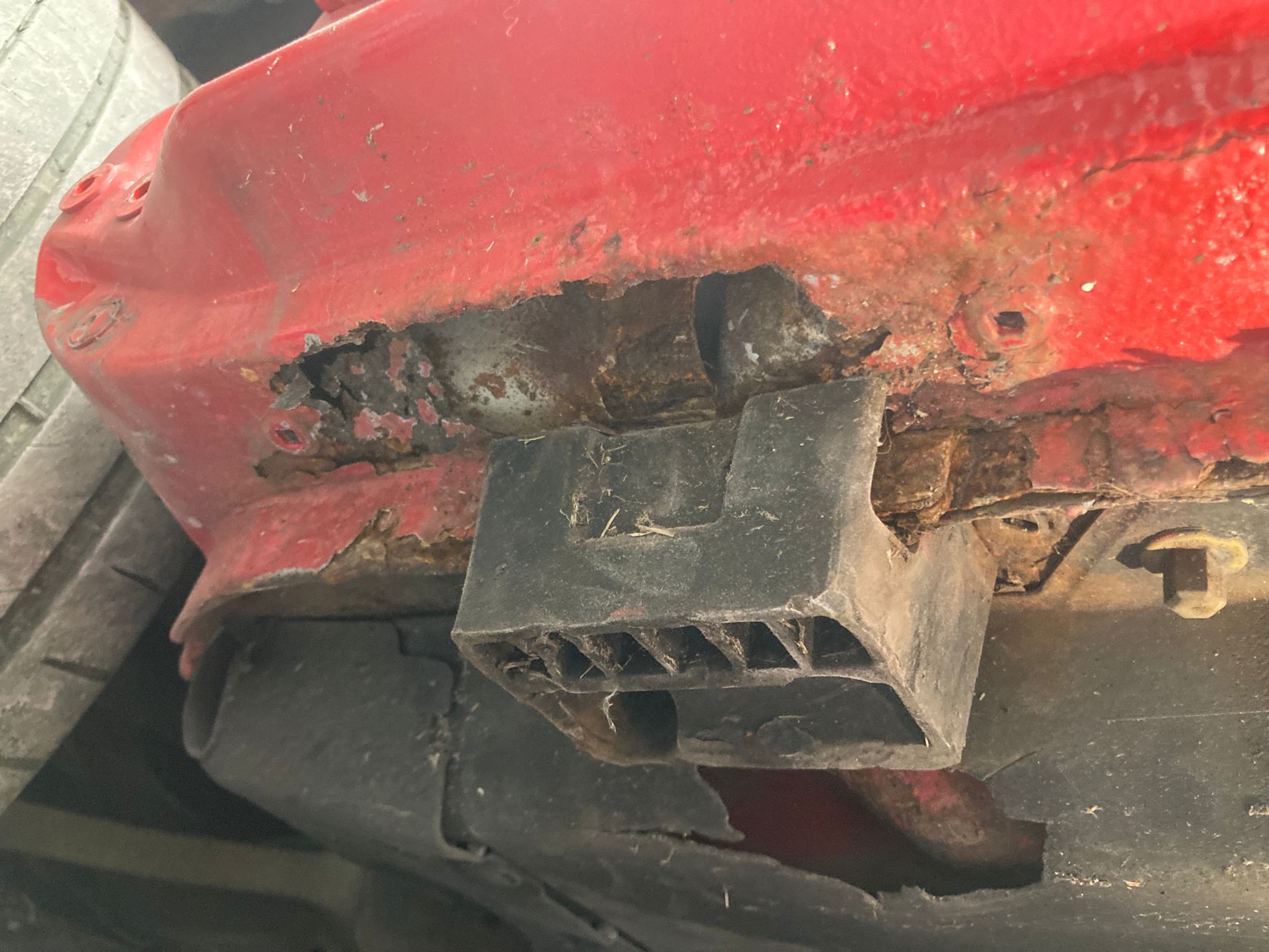

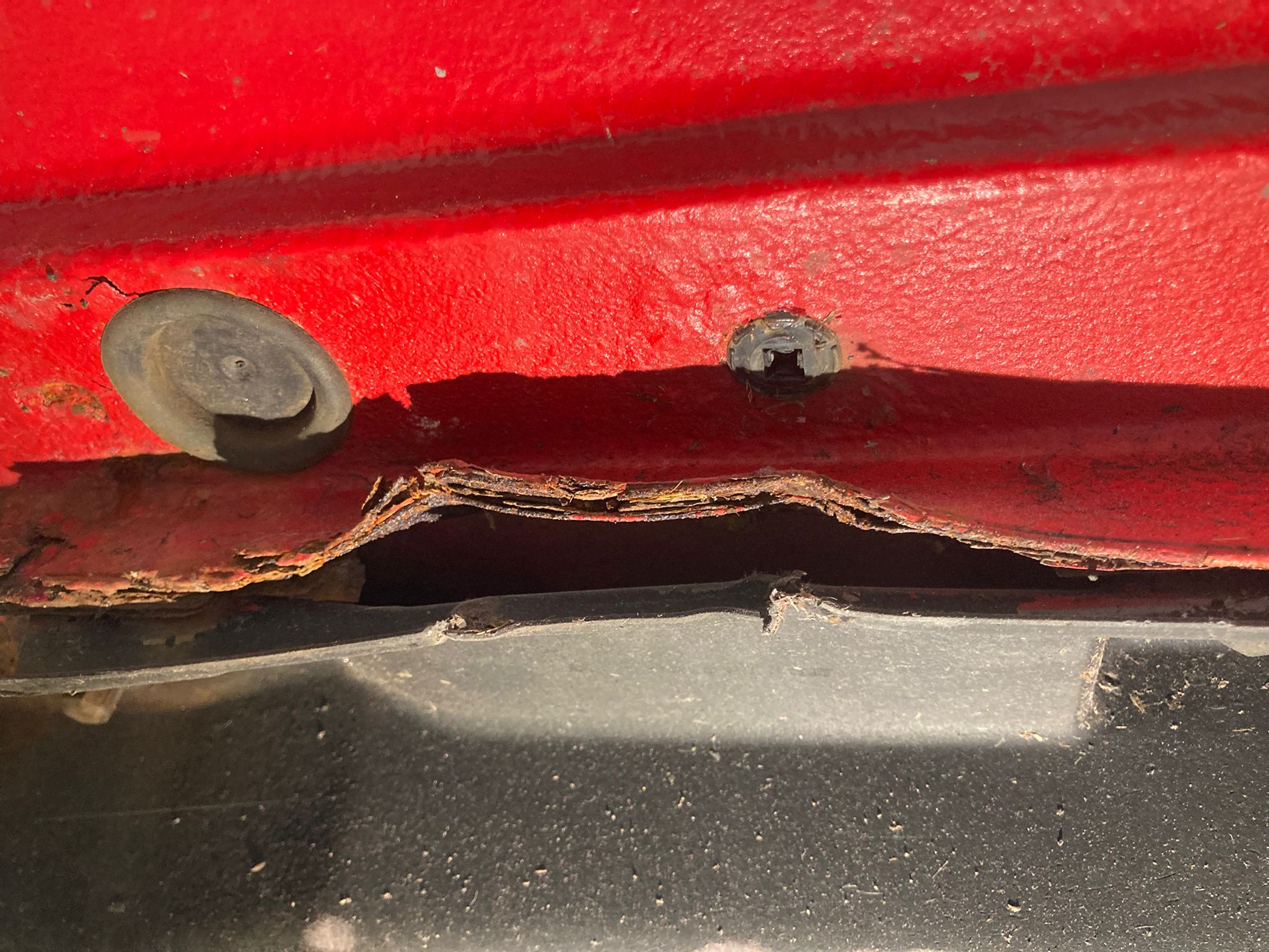

Unfortunately whilst it was in for this work (specifically when the side skirts were off), it was highlighted that the sills were in a bad way....... with the rest of the underside not looking much better
I always knew it was going to need work underneath but you always hope you can get another year out of it...... now it was time to bite the bullet and find a workshop to carry out a full underside restoration. Before it was too late...

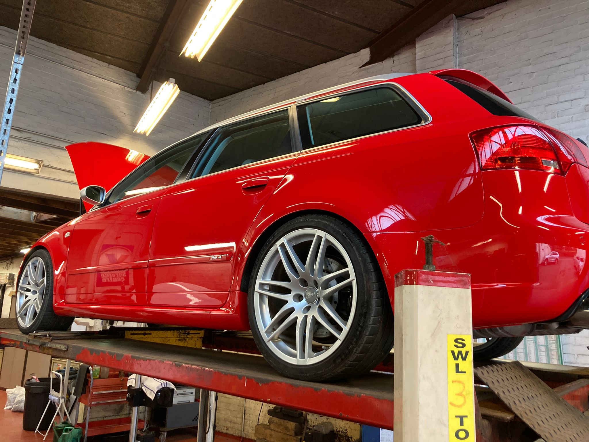

After doing loads of research I managed to find a place to restore the underside of the car. The owner had restored his own RS4 B7 previously and after seeing pictures of the last RS4 he did, I was convinced I had found the right person to carry out the work.
I literally picked the car up from the paint Shop and drove it straight to his workshop. Only a 3 hour drive on mostly motorways, but it felt great to be back behind the wheel again after so long!

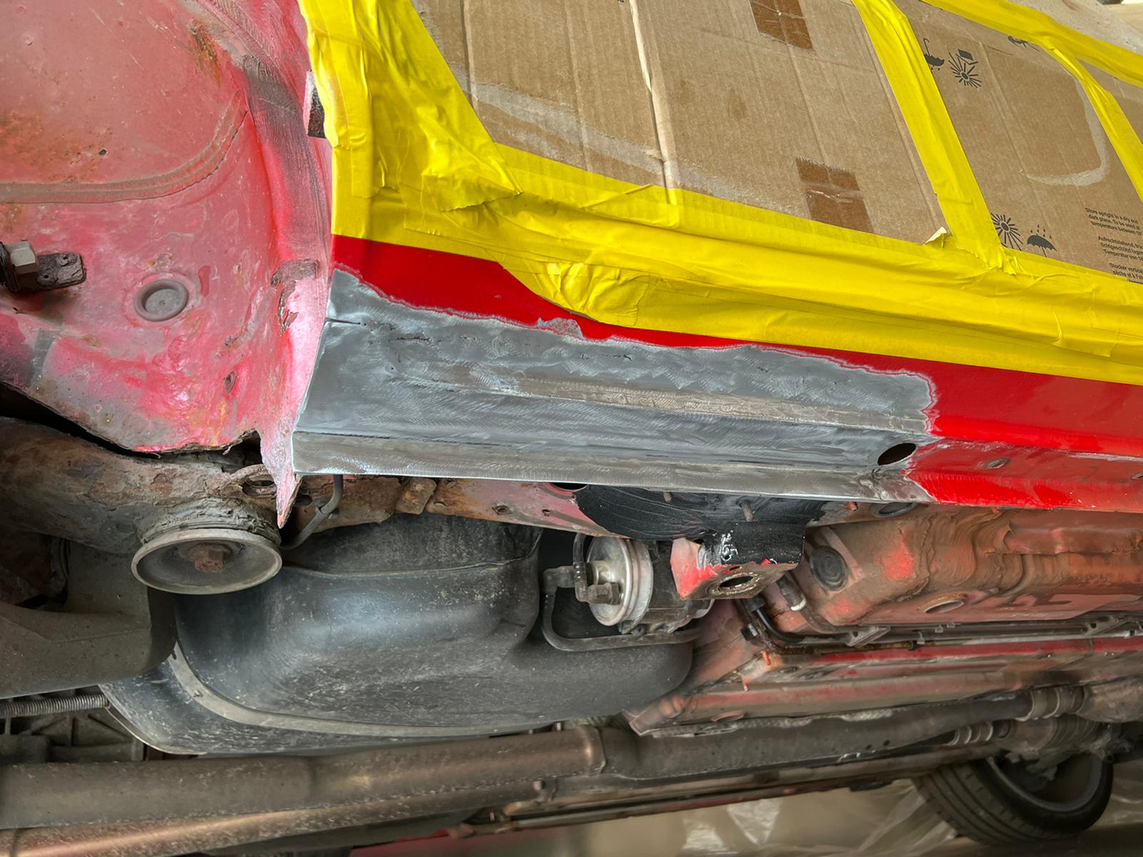

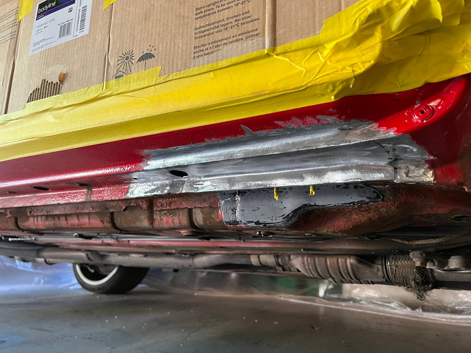

The first job was to get the sills repaired along with the jacking points to allow it to be safely put onto the lift.
As you can see, the sills were in a terrible state! They were hidden by the side skirts so never flagged up on any MOT but I knew I was in trouble when a few month before, I placed an axle stand under the sill, lowered the jack and the car continued to drop back down!!!
The sills were repaired by using a combination of welding and bonding. Thicker gauge boron steel was used for increased strength, corrosion resistance and longevity.
