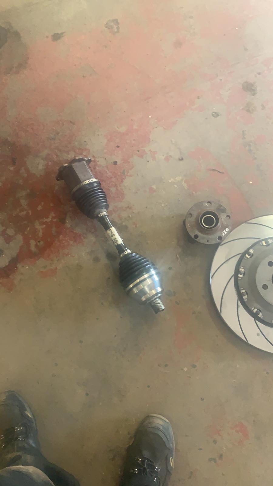

Just to update the thread, went with the suggestions of replacing the CV Joints. Garage couldn't unbolt the CV Joints from the
drive'S though, so I had to order a new set of drives. Surprisingly they arrived from Audi within 48hrs.

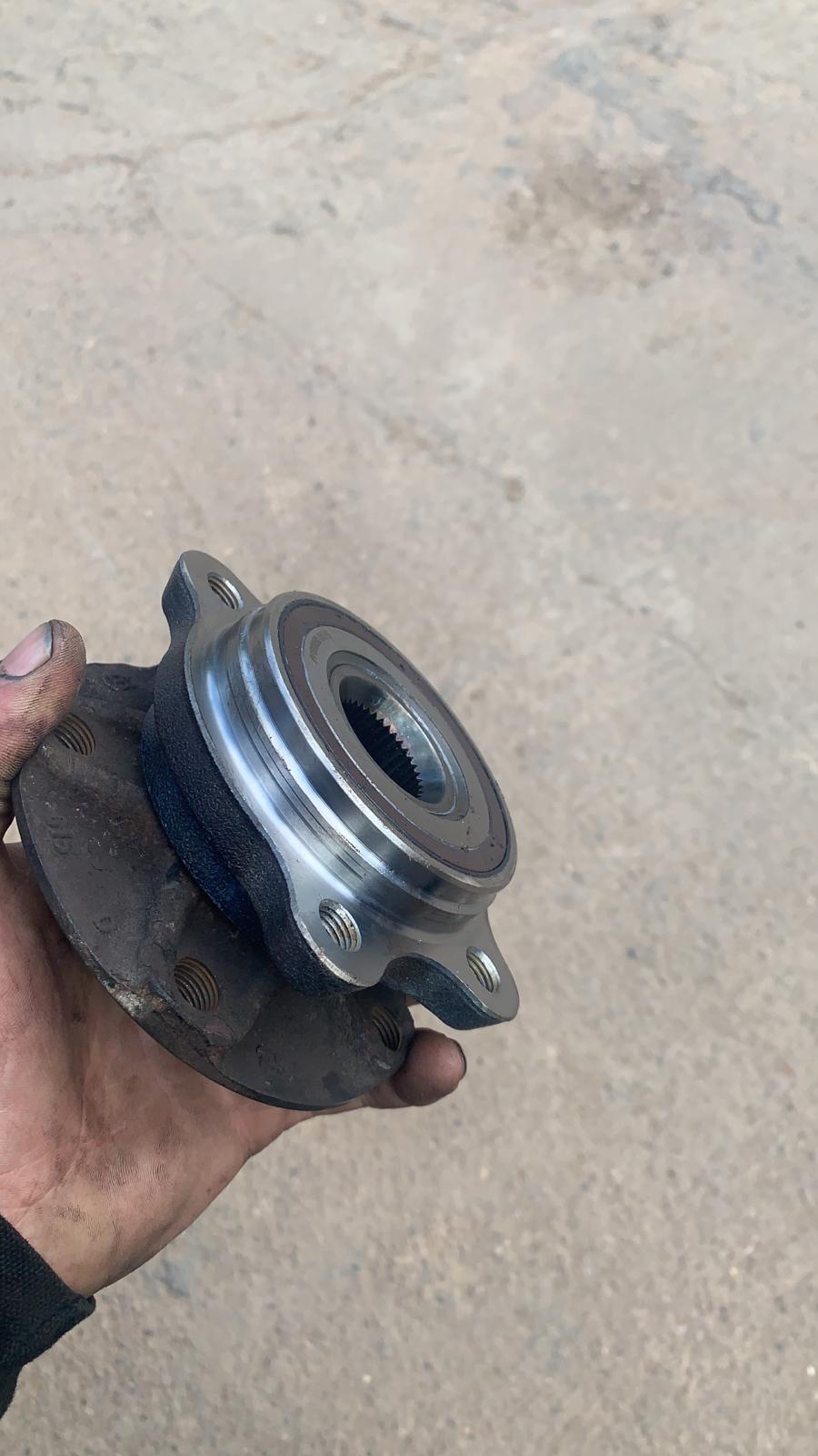

Garaged fitted the new drives yesterday, reversed it out and "clunk". The plan now is to replace to the wheel bearings next, the
saga continues..

Re: Clunking noise
I feel your pain, just done the same on outer joints and wheel bearings courtesy of shed loads of clicking. Gone with Shaftec outer CV joints (£132 for a pair) and wheel bearings from Allwoods which are probably just some random 3rd party at £155 for a pair.
