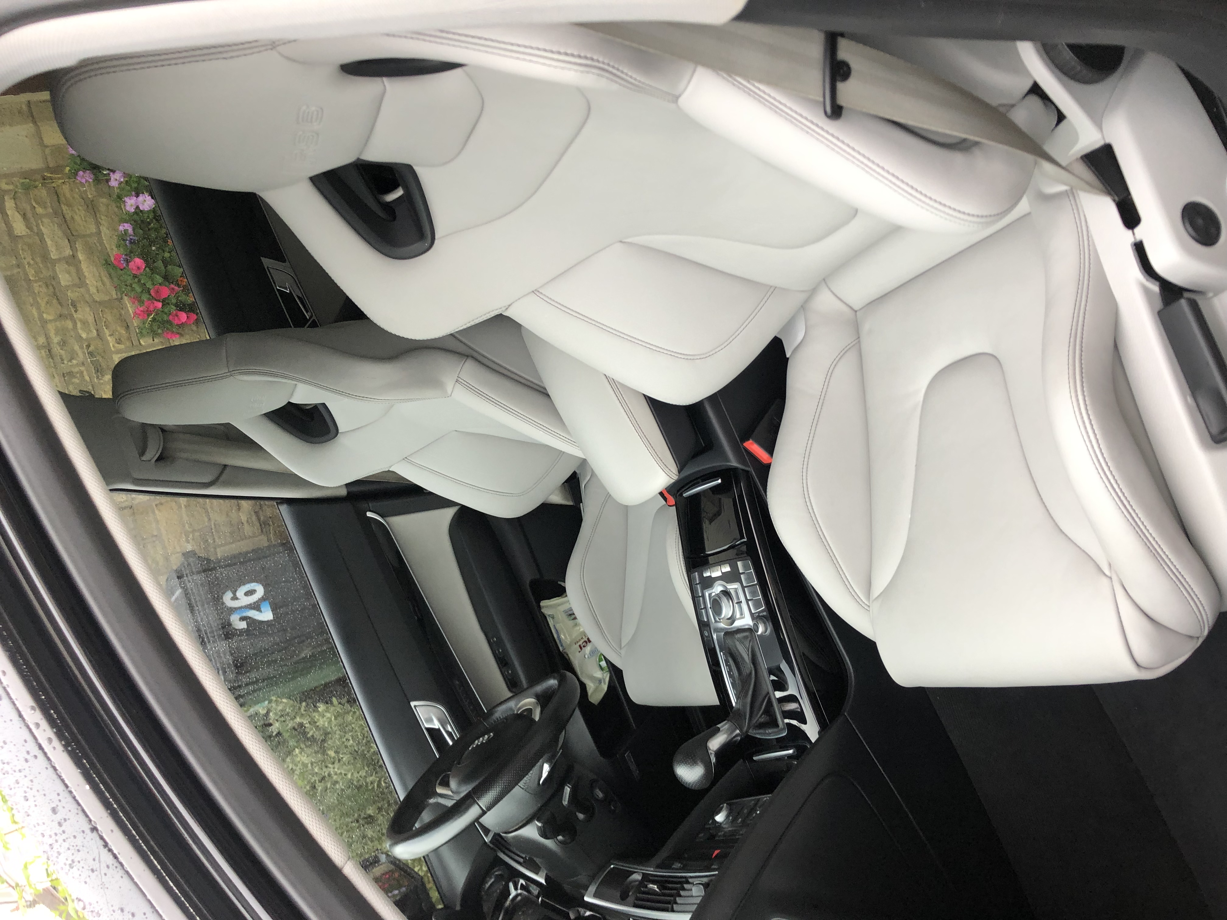

Useful info if you want Wingbacks, there are plug n play! Just need to swap the yellow connector and that’s it! Fully functioning with no airbag lights!
Mine have been retrimmed to match the factory silver leather and RS6 logo in the factory font. So no need to pay £5k for a set of genuine ones. 👍

It was overly expensive but if you have a black interior you can just bolt in the seats. Mine being silver added £2k to the cost. Probably wouldn’t have bothered if I knew the cost up front but they do transform how the car feels
Seats £1700
Heated base repair £300
Leather £500
Trimming (inc, Logos, thinned leather for the backs, fitting) £1000

Yes, there painted to match the leather. Wanted the seats to look better than factory, the backs are plain plastic so I had them trimmed in thinned leather. That meant the bases need to be colour coded or they’d look odd.
