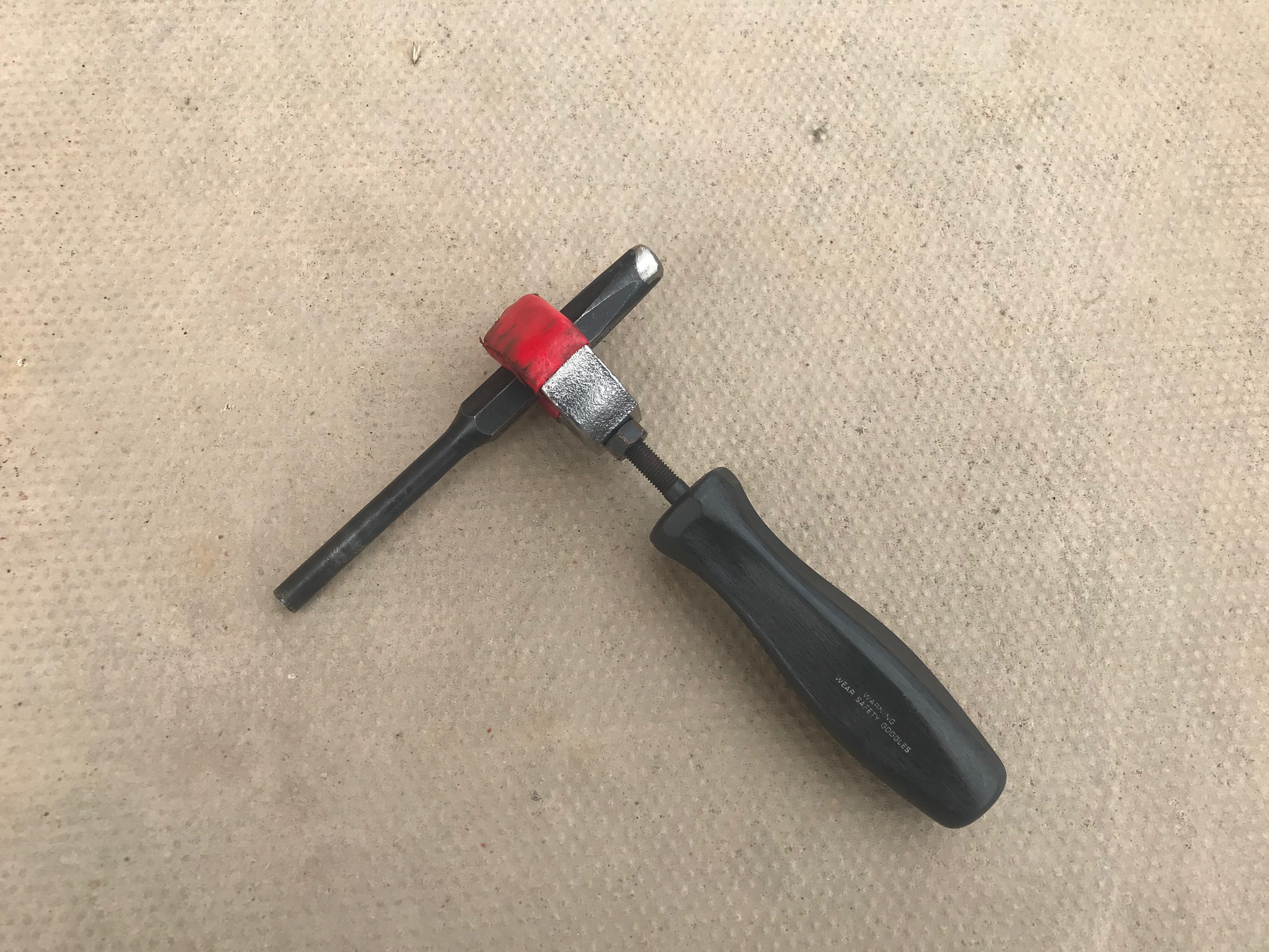

I take it that the pinch bolt was seized solid? I had exactly the same bother a year and a half ago with my Skoda Superb when replacing the upper control arms - same suspension setup, only steel instead of alloy. When taking the nut off the bolt just snapped, which was actually quite lucky as it allowed me to sit the punch in the hole so that you didn't need to readjust the punch every time it was struck. Anyway, after hours of hitting it with a 3lb hammer (and believe me I was hitting it), it had moved say 15mm and stopped. I got my father to help and we were using a 14lb sledge hammer, and again believe me that neither of us are shy using it, it still wouldn't budge - not even 1mm. I didn't want to heat the housing, but I ended up having no choice. Anyway after heating the housing a bit the bolt started coming out no problem.ATinOf wrote: ↑Sat Jul 06, 2019 7:16 pmI cant source them anywhere so far. Brembo dont even list the caliper on line. I have sent them a tech request for info.

I would never have thought that a 10mm bolt could seize like that.
I have heard that the alloy housings have a tendency of breaking when trying to remove the pinch bolt. I don't know whether the pinch bolts on the alloy housings seize up any worse than on the steel housings due to bimetallic corrosion? Although, how it could seize up any worse than what i had I don't know! It may be worthwhile using some Duralac paste when refitting the new bolt to try and avoid the galvanic reaction between the metals. I haven't used it myself but I have heard good things about it.
I keep looking at the pinch bolts on my RS and keep telling myself not to touch them until I need to! I wouldn't mind just taking them out and replacing the bolts and coat them with some Duralac, but as the old saying goes; "If it ain't broke, don't fix it".

Problem is that a lot of the impact is absorbed by movement in the arm bushes. What you need to do is damp it by having an assistant hold a heavy hammer tight against the opposite side of the arm - something I learned many, many years ago when I had to remove wedge cotter pins on a regular basis. Could hammer away for hours with no result but with a counter weight it'd usually take no more than a couple of strikes.

Ahh I see exactly what you mean now. That's a great tip Jim, thanks!Jim Haseltine wrote: ↑Wed Jul 10, 2019 2:42 pmProblem is that a lot of the impact is absorbed by movement in the arm bushes. What you need to do is damp it by having an assistant hold a heavy hammer tight against the opposite side of the arm - something I learned many, many years ago when I had to remove wedge cotter pins on a regular basis. Could hammer away for hours with no result but with a counter weight it'd usually take no more than a couple of strikes.
