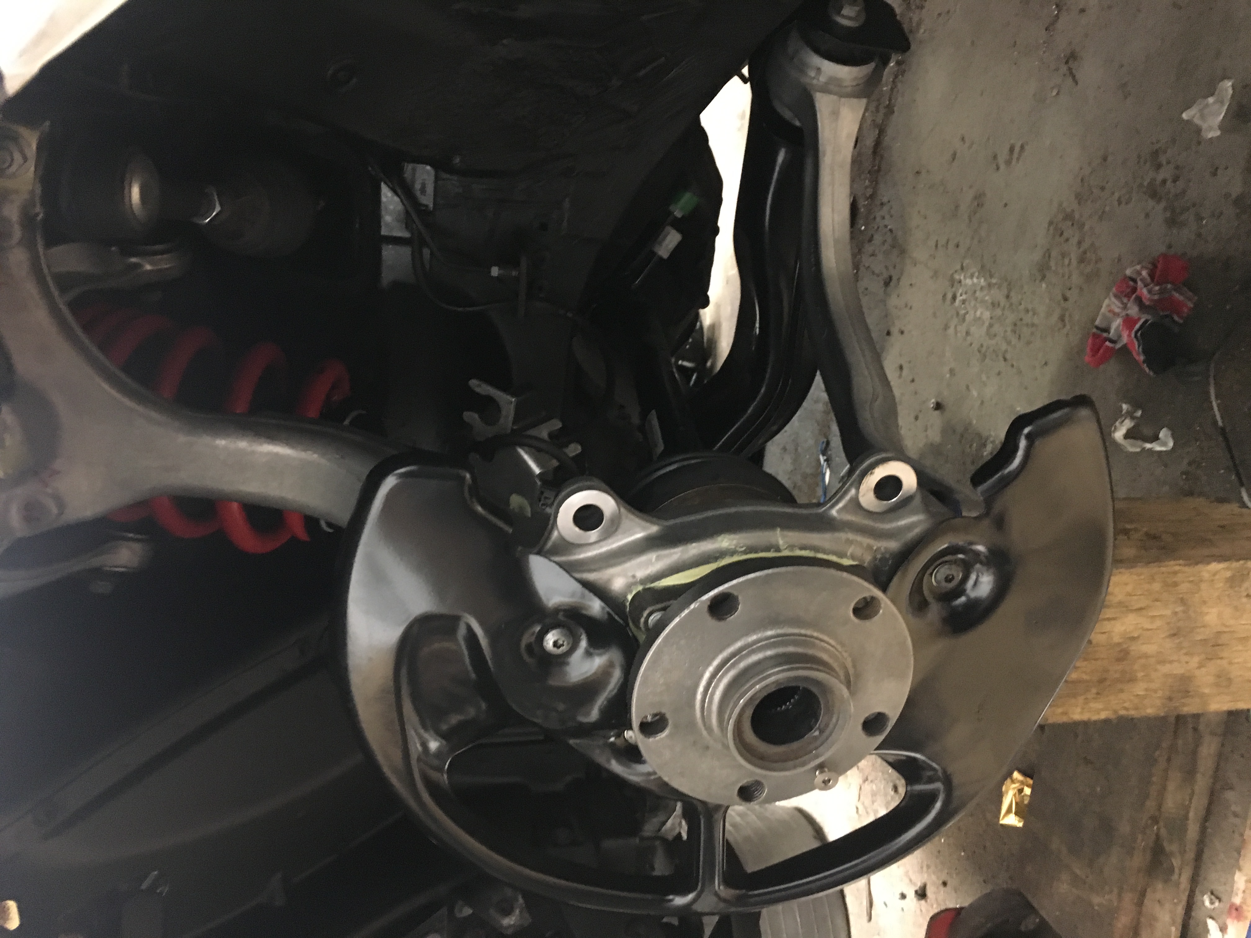

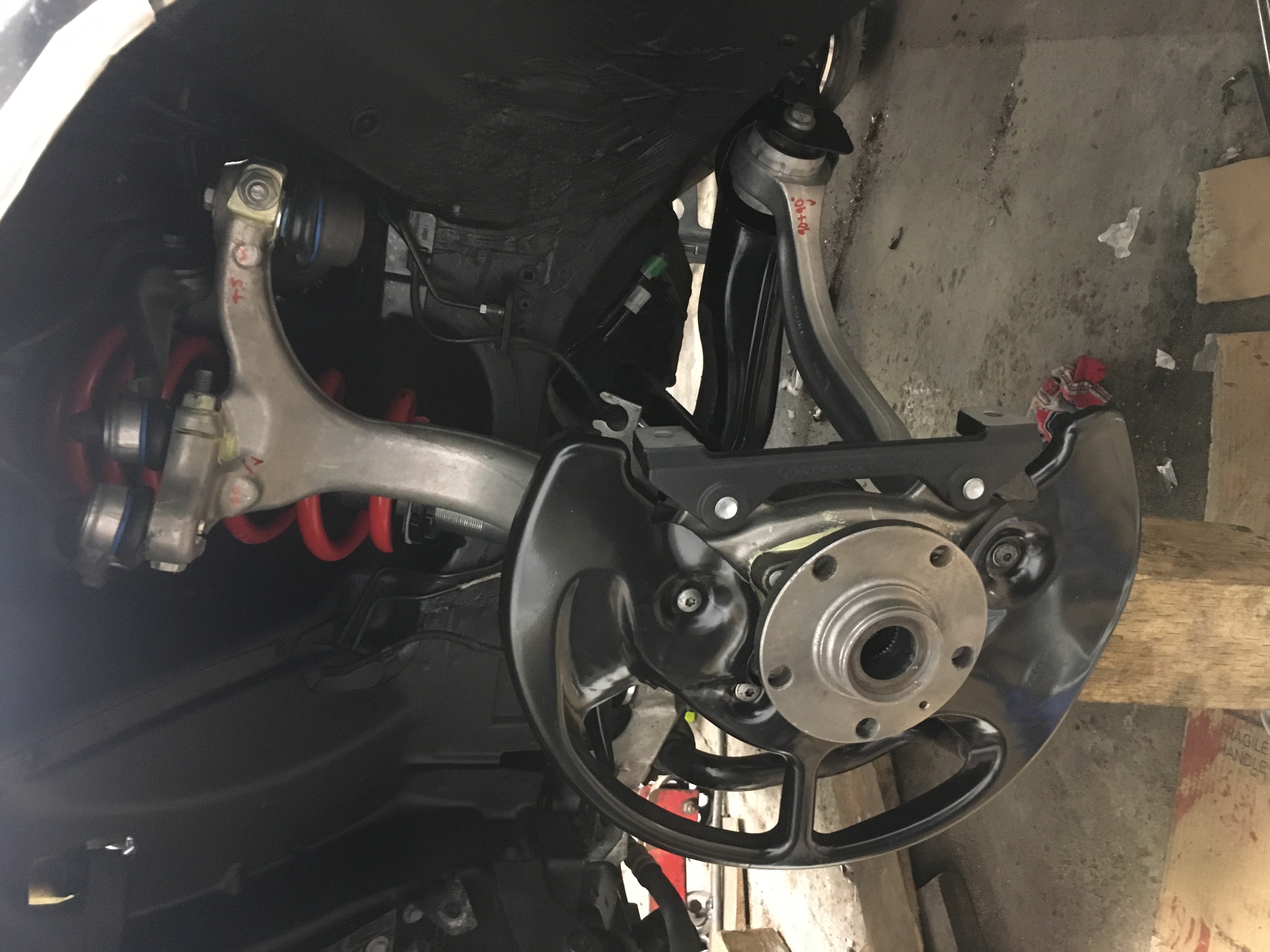

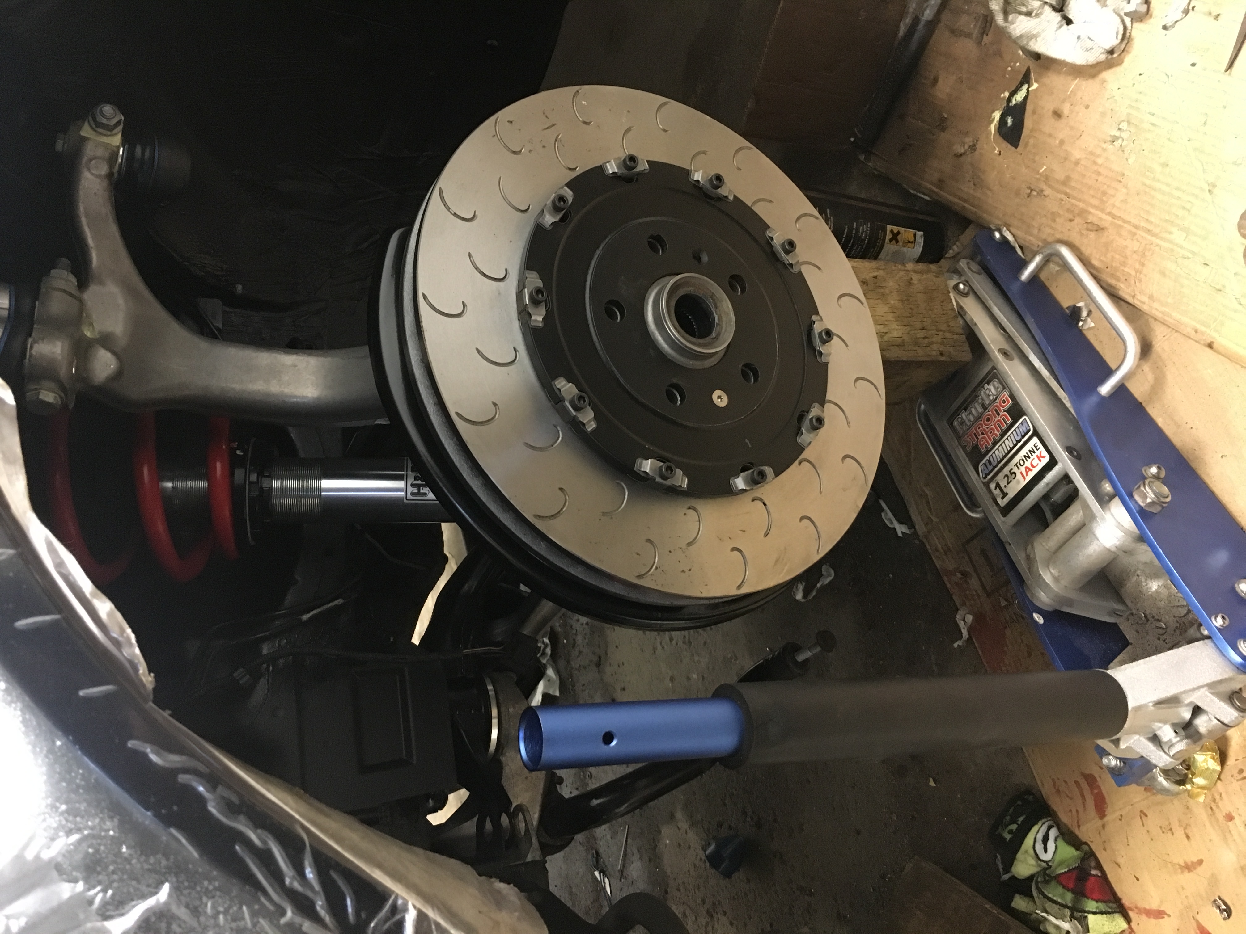

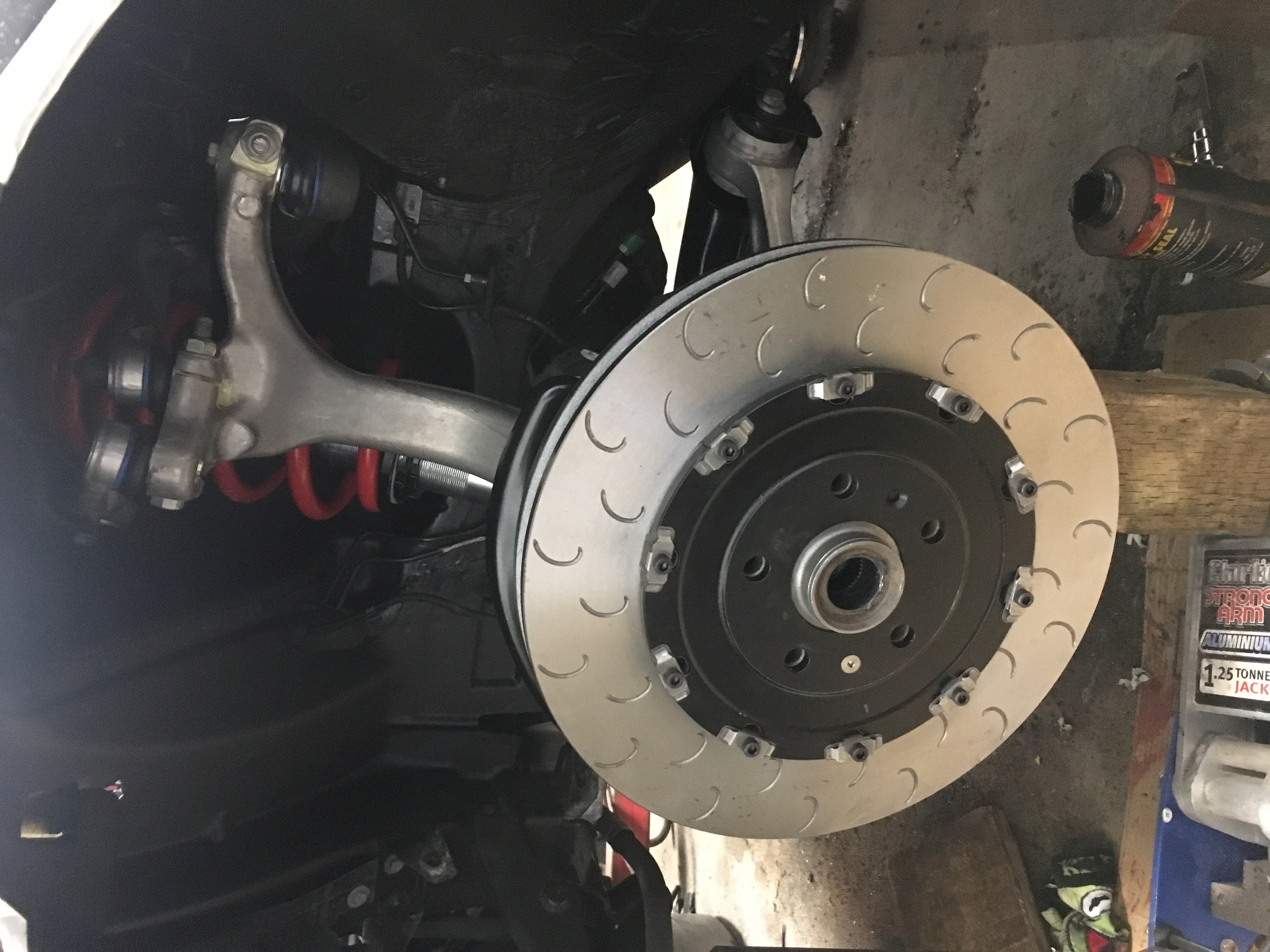

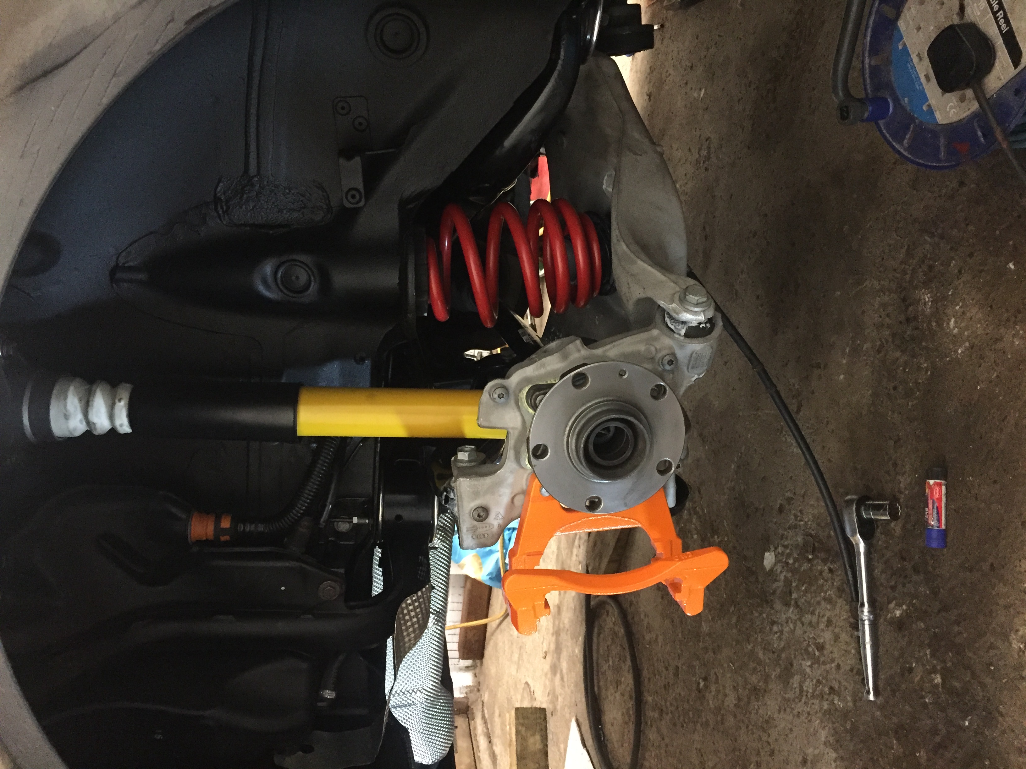

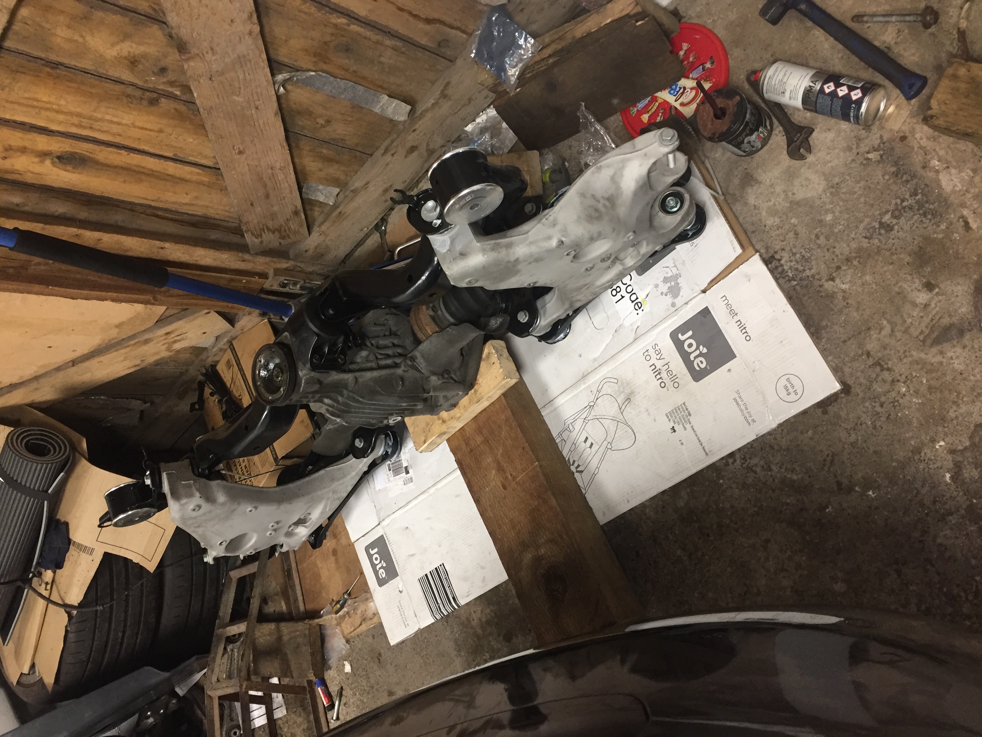

Update time.
I haven't had as much time on the car as I would have liked lately due to family commitments etc
But I have managed some time, I started off fitting the front subframe torqued up to spec with new bolts, fitted the coilovers using the original bolts up top as they don't need to be replaced, next was all the suspension arms, front uprights and hubs all with new bolts torqued to spec at the ride height I will be running and anti seize compound when steel is in contact with the aluminium, original re coated brake shields were fitted also.

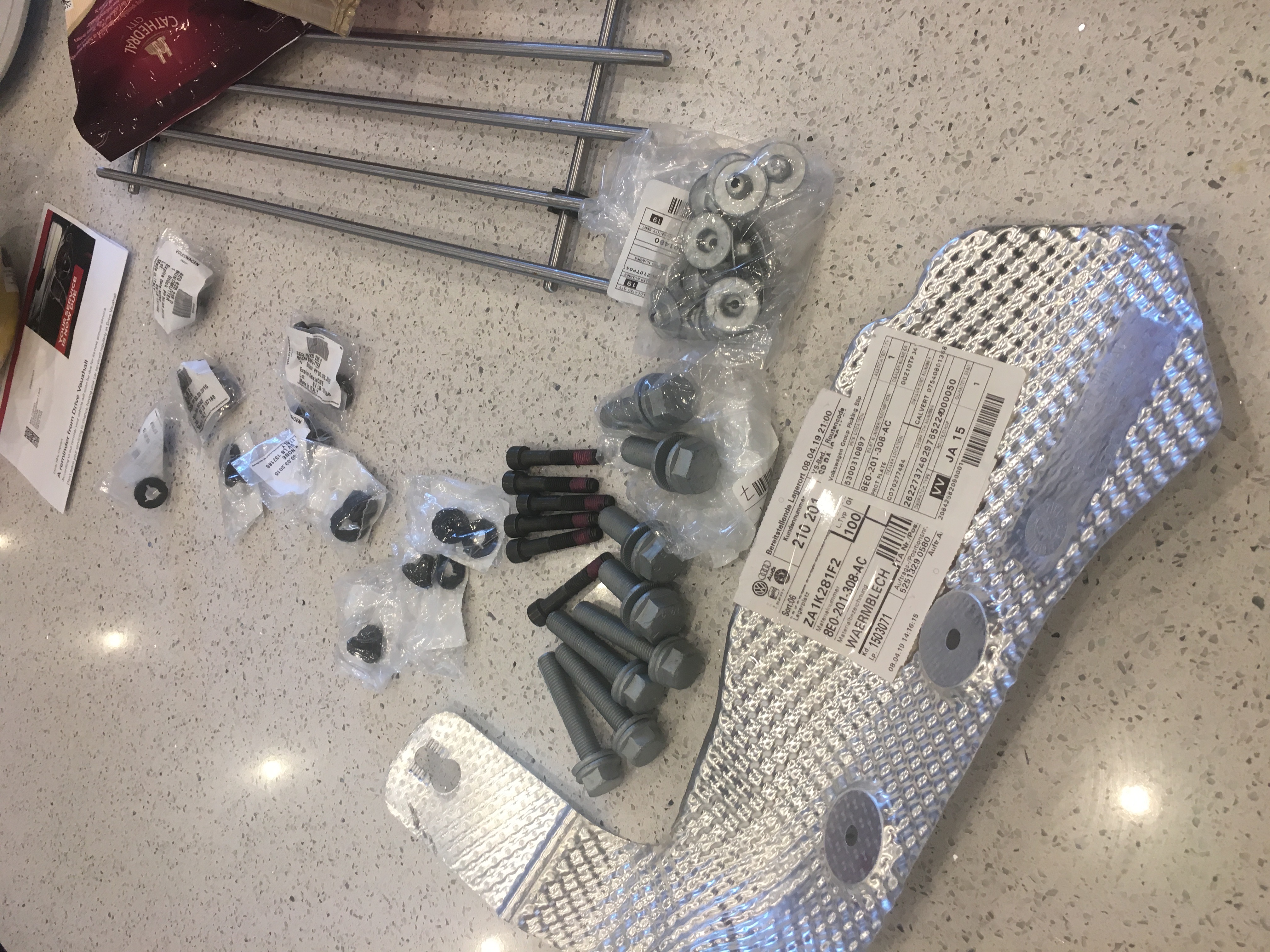

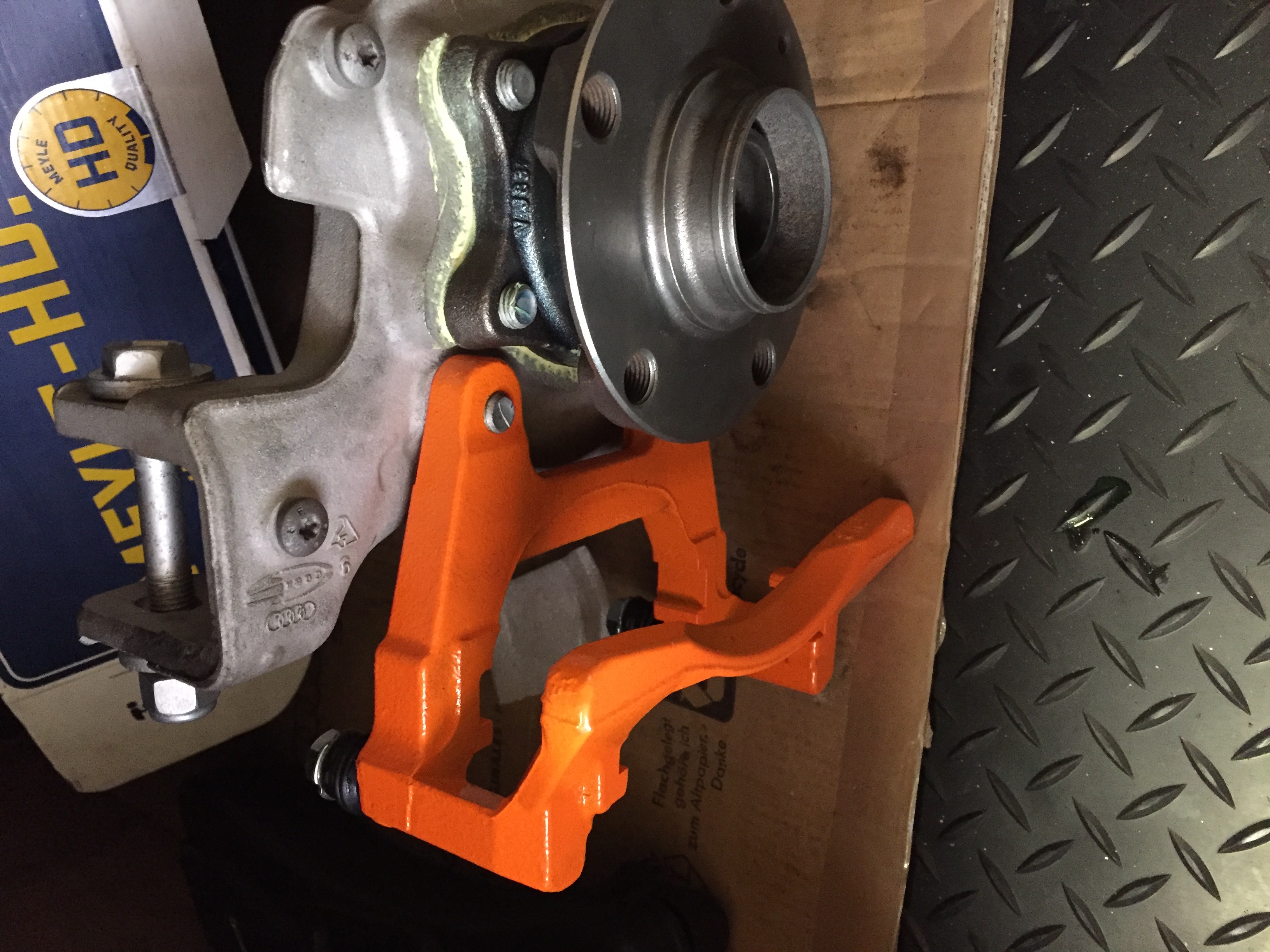

Had yet another trip to TPS to pick up my new calliper bolts, driveshaft bolts, fuel neck heat shield and heat shield nuts along with new plastic nuts for the undertrays.

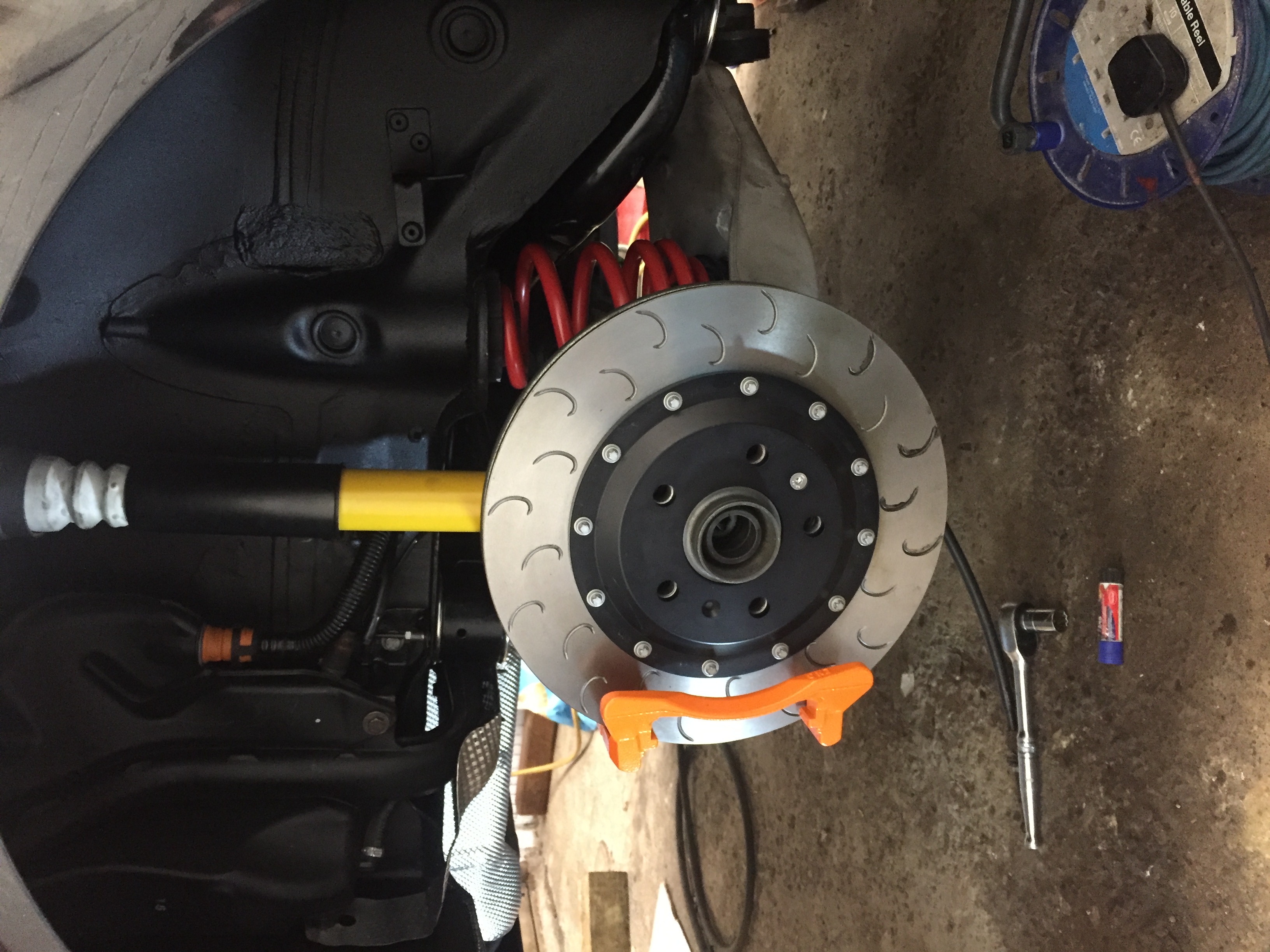

Added the calliper brackets with new bolts torqued up to a hefty 196nm
Bolted on the new reyland discs with titanium countersunk screws
I then had a friend come round to help me lift in the rear subframe but just as he got here remembered the fuel tank had to go in first, fitted a new fuel filter ( mine was dated 2006! And black fuel poured out
) the tank was then fitted followed by the subframe at which point I remembered I needed to fit the rear brake lines and the subrafe and tank had to come back out
with the brake lines in the tank and subframe were fitted but sadly the subframe had to come back out!
Before I sent the rear subframe to powder coat I cut a few grooves in the original upper control arm bolts to clean out the threads and these were left fitted when coated, sadly when fitting the upper control arms one of the bolts wasn't going in right.

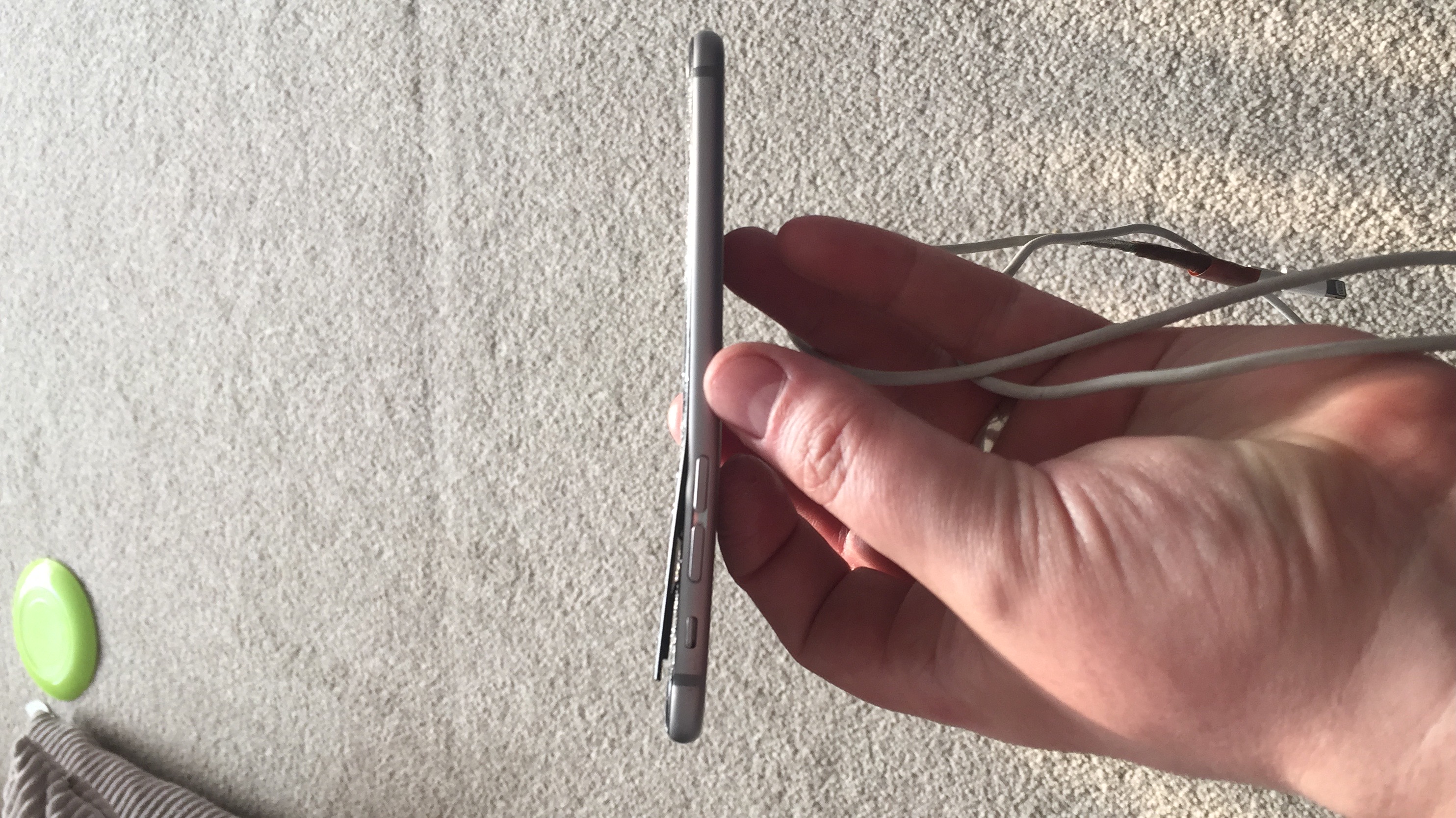

The subrame was lowered but unfortunately fell from the jack, the only damage was to my trusty iPhone 6s!
Unfortunately I have lost over 2500 pictures of the kids and the car, I'm hoping it might turn on with a new screen.

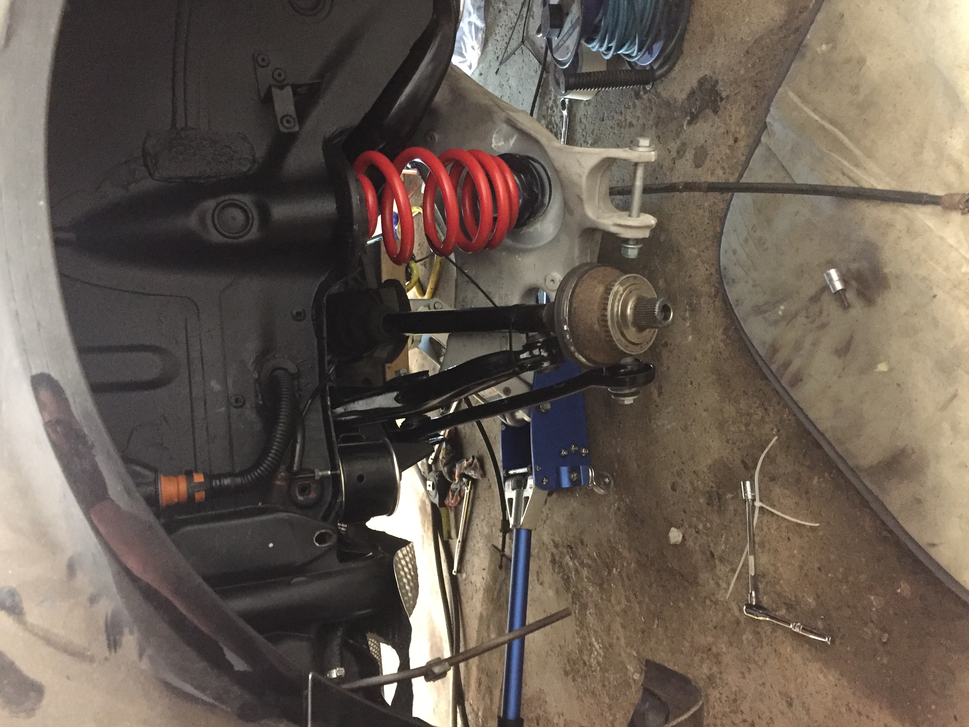

I popped to a local engineering Shop to buy a m12x1.5 tap and cleaned out the threads, fitted the subframe back on the car and hoped it was the last time.

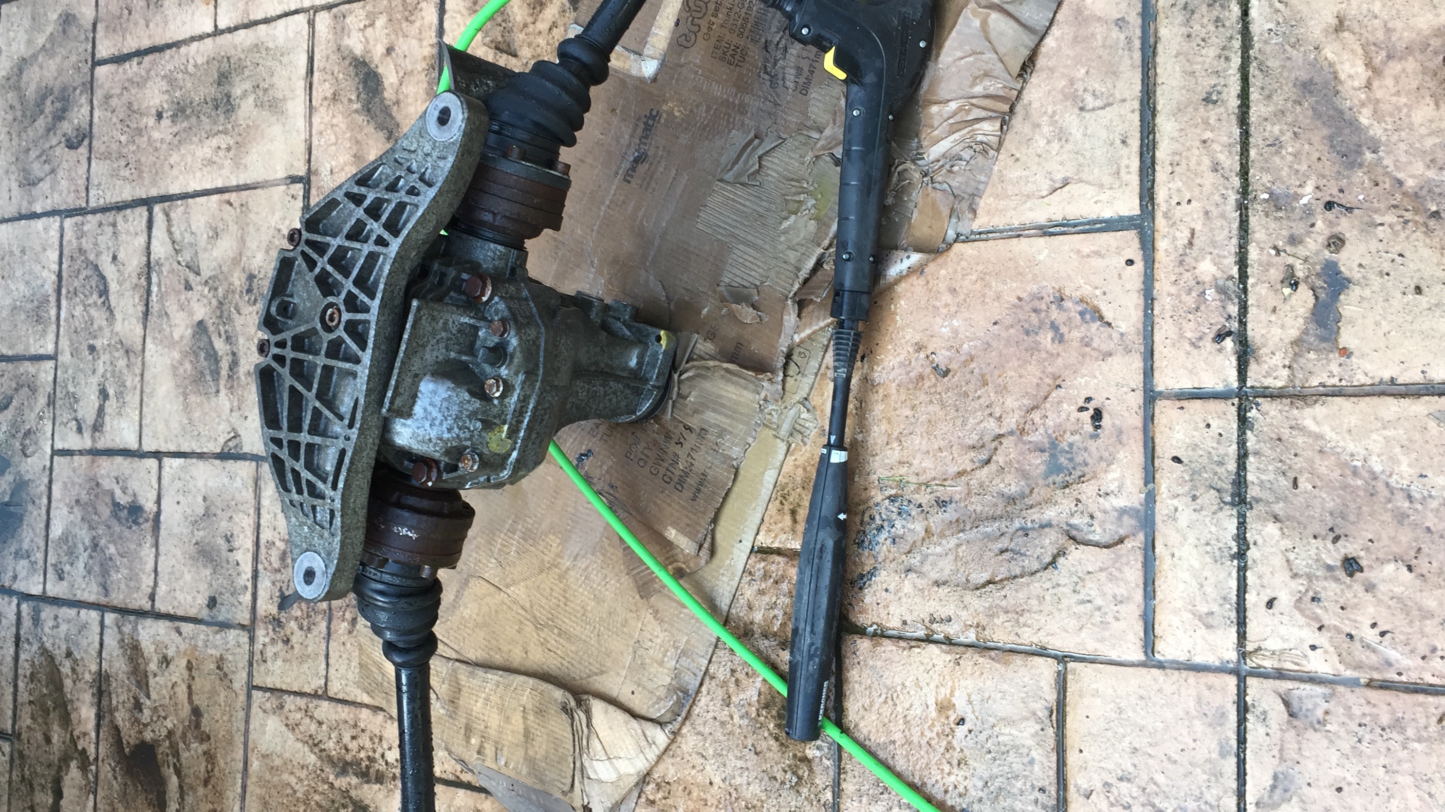

I had a friend come and help me lift in the rear diff and shafts so gave it a quick degrease and power wash.
I unfortunately had to lower the rear subframe again as i couldn't get the lower control arm bolts in

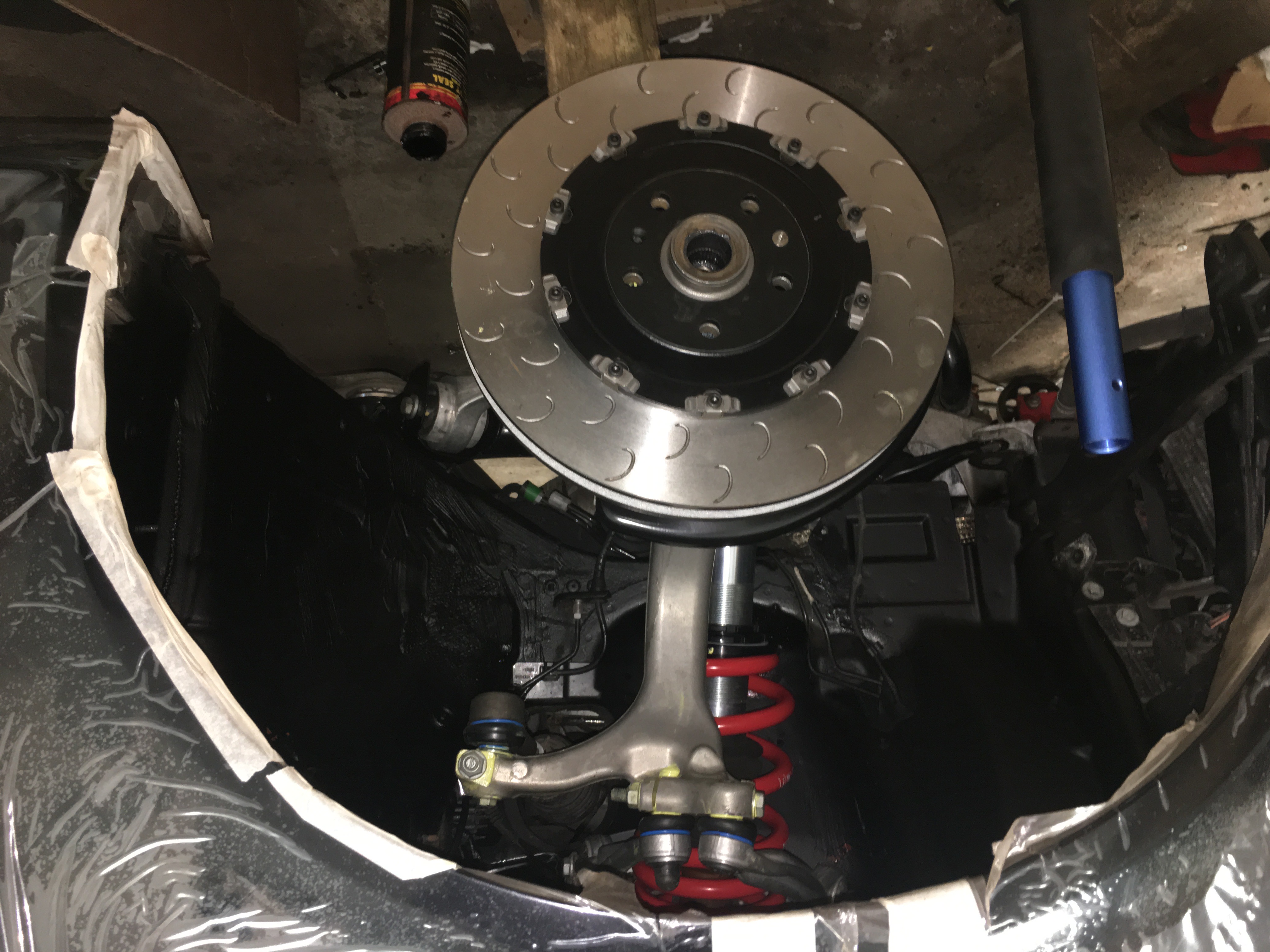

I fitted all the arms while it was off the car as it was just a bit easier.
Subframe back on the car and now has the coilovers, hubs and coilovers fitted again with all new bolts.
That takes me up to date, hoping to get the rear end all buttoned up this weekend with the exception of the exhaust, that needs to stay off as I have just ordered new H&R anti roll bars.

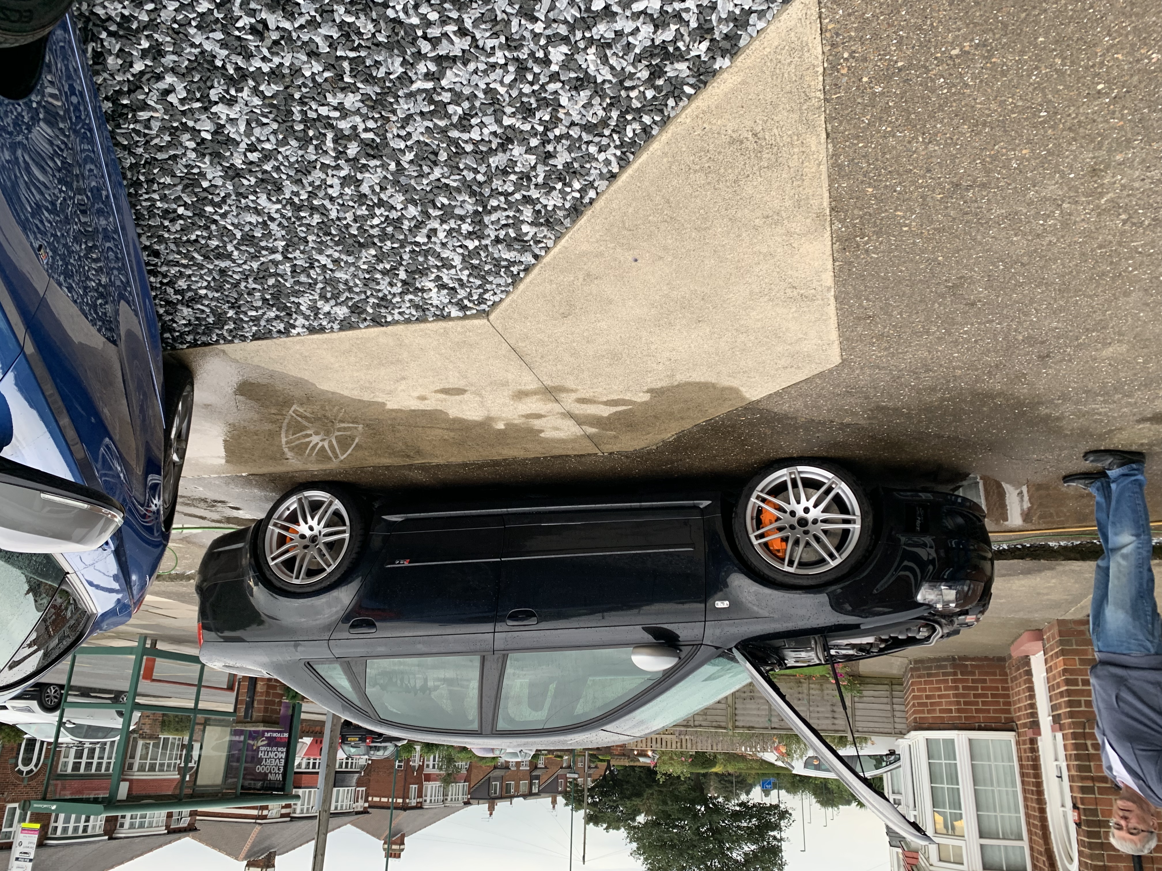

Quick update, after smashing my phone to pieces and losing many of my pictures I lost heart in keeping this updated.
We also rather suddenly decided to put our house on the market and have accepted an offer within weeks which means the Audi is getting evicted to a smaller standard double garage in the new house so I have had to crack on with it, and will in the style of star wars finish the thread as a sort of prequel.
So as of this week this is where I am at.
