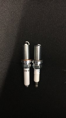

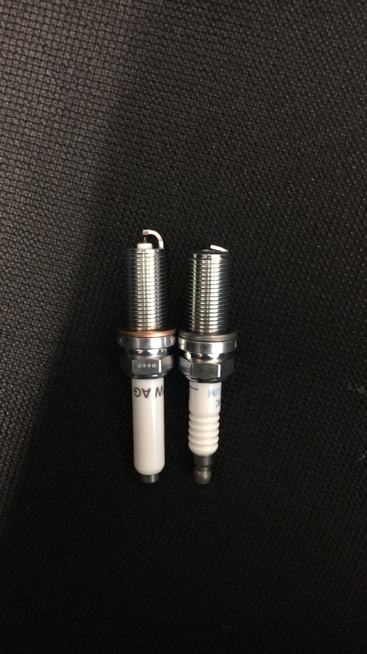

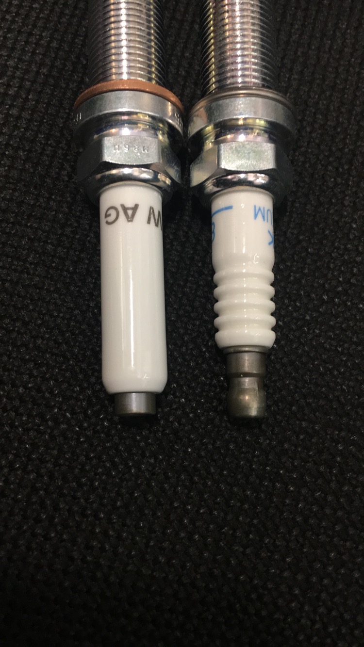

Could someone confirm the correct NGK uprated plugs. My cats at Aylesbury Audi atm and they have said the plugs I have provided are incorrect. I purchased these through a friend who works at Euro car parts, they were mentioned in this thread previously.
https://www.opieoils.co.uk/p-64238-ngk- ... kplug.aspx
Audi sent me these pictures to show the difference bewteeen the OEM and the NGK?! They are completely different IMO

The plugs you have are NGK race plugs R7438-8 which have a different tip design.
The current dealer NGK plugs specced for the RS6/7 are 06K905601M
I would stick with OEM as they work well and have been superceded twice.
