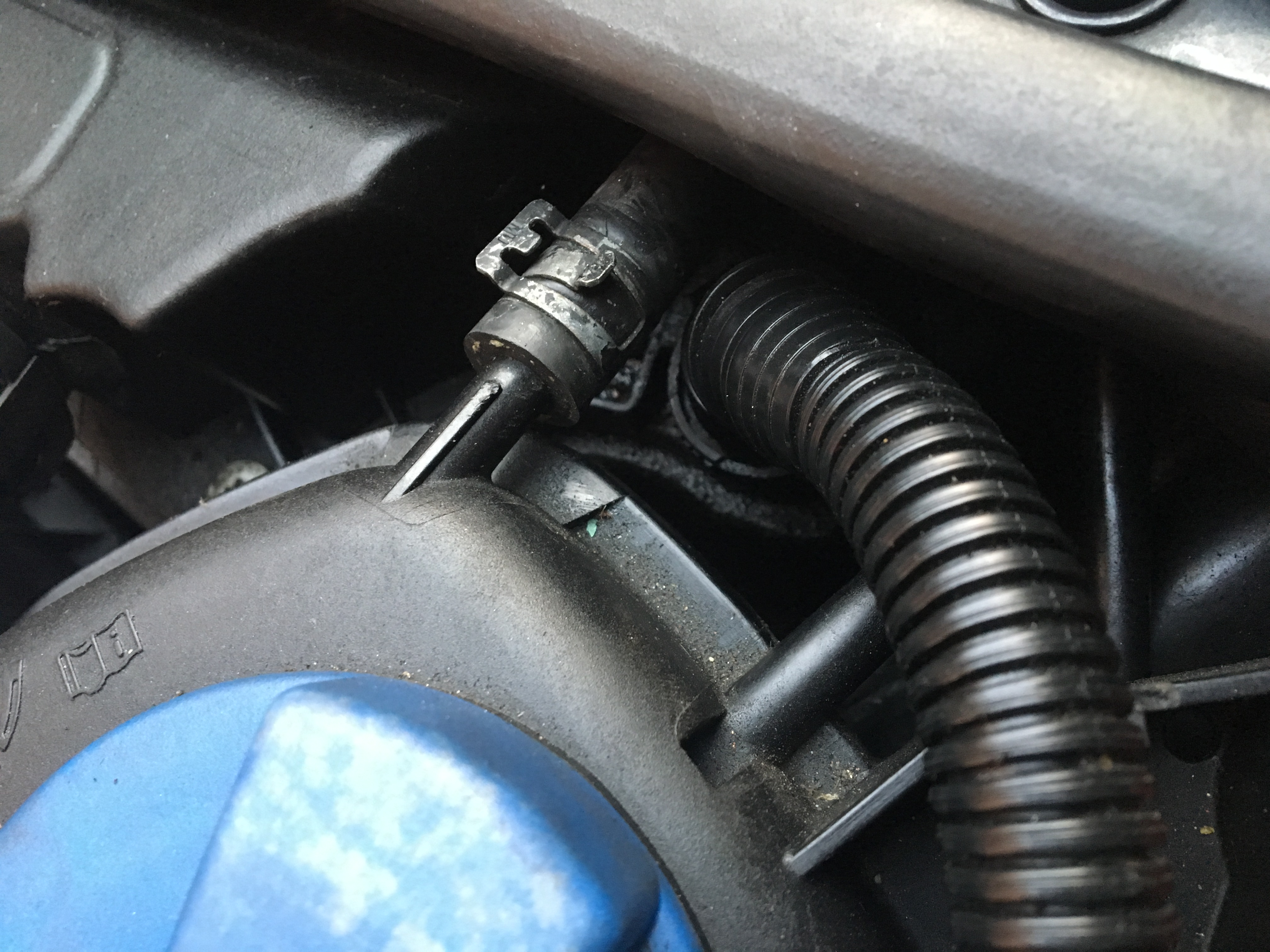

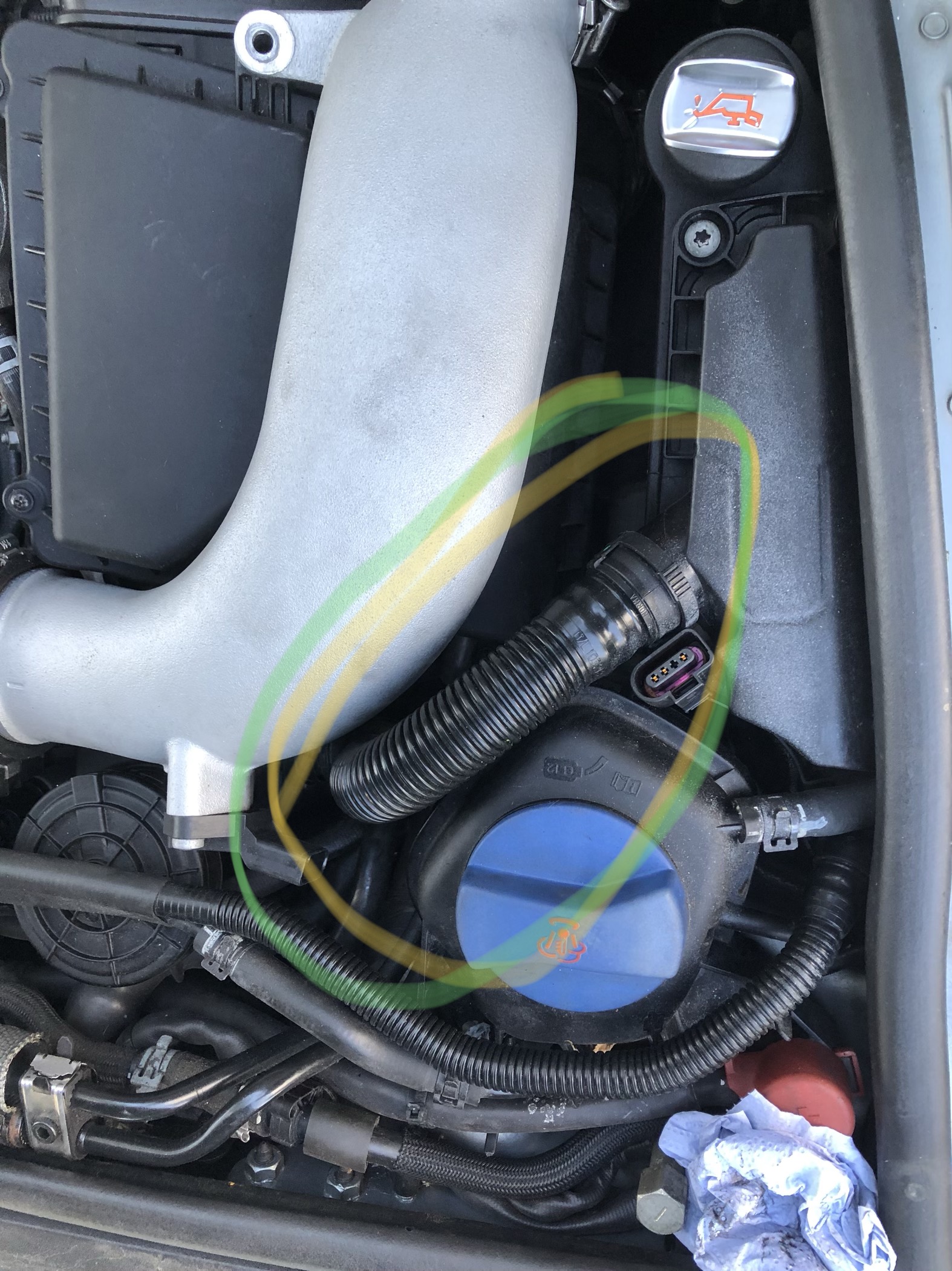

Hey guys,
Today i did some general maintenance on the car such as ‘leaf / debris unblocking’ + also installed new BMC Air filters.
Upon closer inspection under the hood i noticed that the following hose is tad loose (highlighted - Badly i know 😩). Could someone shed some light what is it for before i order a replacement?

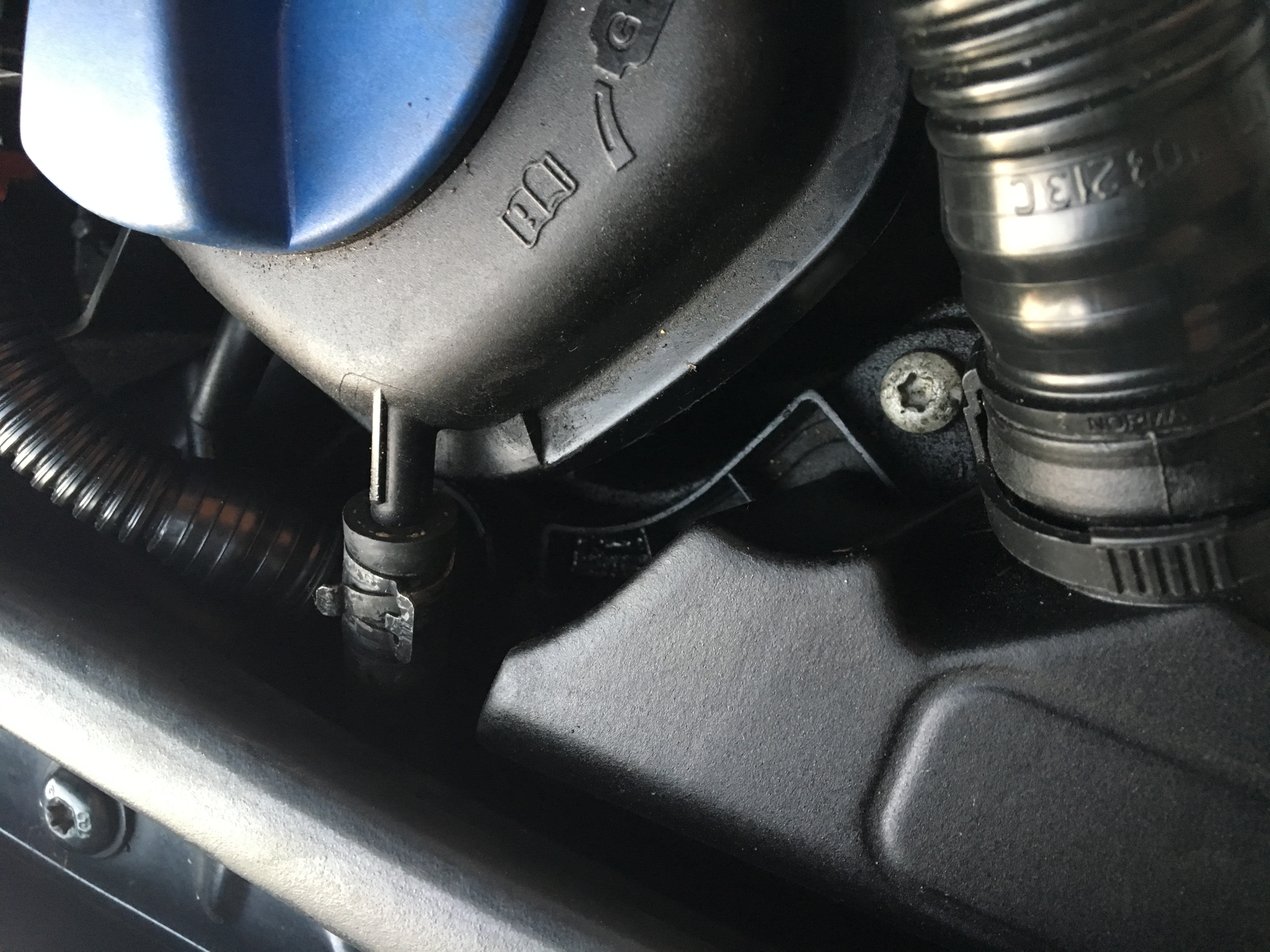

That's the breather hose between the oil tank separator and the PCV oil separator on the RH rocker cover. It gets brittle over the years and sometimes will disintegrate when you touch it. The tank end is easy to remove and refit, the other end isn't.

Cheers Jim... mine’s very loose on the rocker cover end.
What purpose does it serve? And guess more importantly is it ok to drive until i get replacement hose?

That pipe carries the gas/fumes/oil residue from the oil tank separator (removes bigger oil particles/residue) and feeds it into the PCV oil separator (removes small/fine oil particles). If you remove the pipe then you will have a fine oil/air mist sprayed around your engine bay which will be a cosmetic nightmare to clean but also has the very slim chance that, should that air/oil mist hit the red-hot manifold, it could catch fire.

Then it's either broken (usually the ribbed piece breaks away from the fitting) or somebody has had problems pushing the fitting on hard enough for it to positively seat. And that I can understand as it's seriously awkward.
