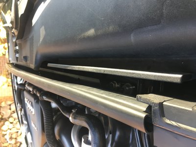

jangol
Posts: 522
Joined: Mon Jun 30, 2014 12:46 pm
Strut Brace - Canyon Run CR-15 installed
Post by jangol » Tue Apr 02, 2019 6:13 pm
It’s arrived Image ignore the healthy bits in the picImage
Baldrick
Posts: 7
Joined: Sat Oct 27, 2018 2:27 pm
Re: Strut Brace - Canyon Run CR-15 installed
Post by Baldrick » Fri Apr 19, 2019 8:49 pm
Yes, still had no response from them, so I picked up an alloy box section for £12, I’ll be putting up a guide on how to easily make it if anyone’s interested...

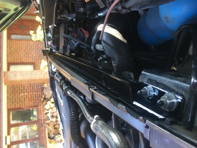

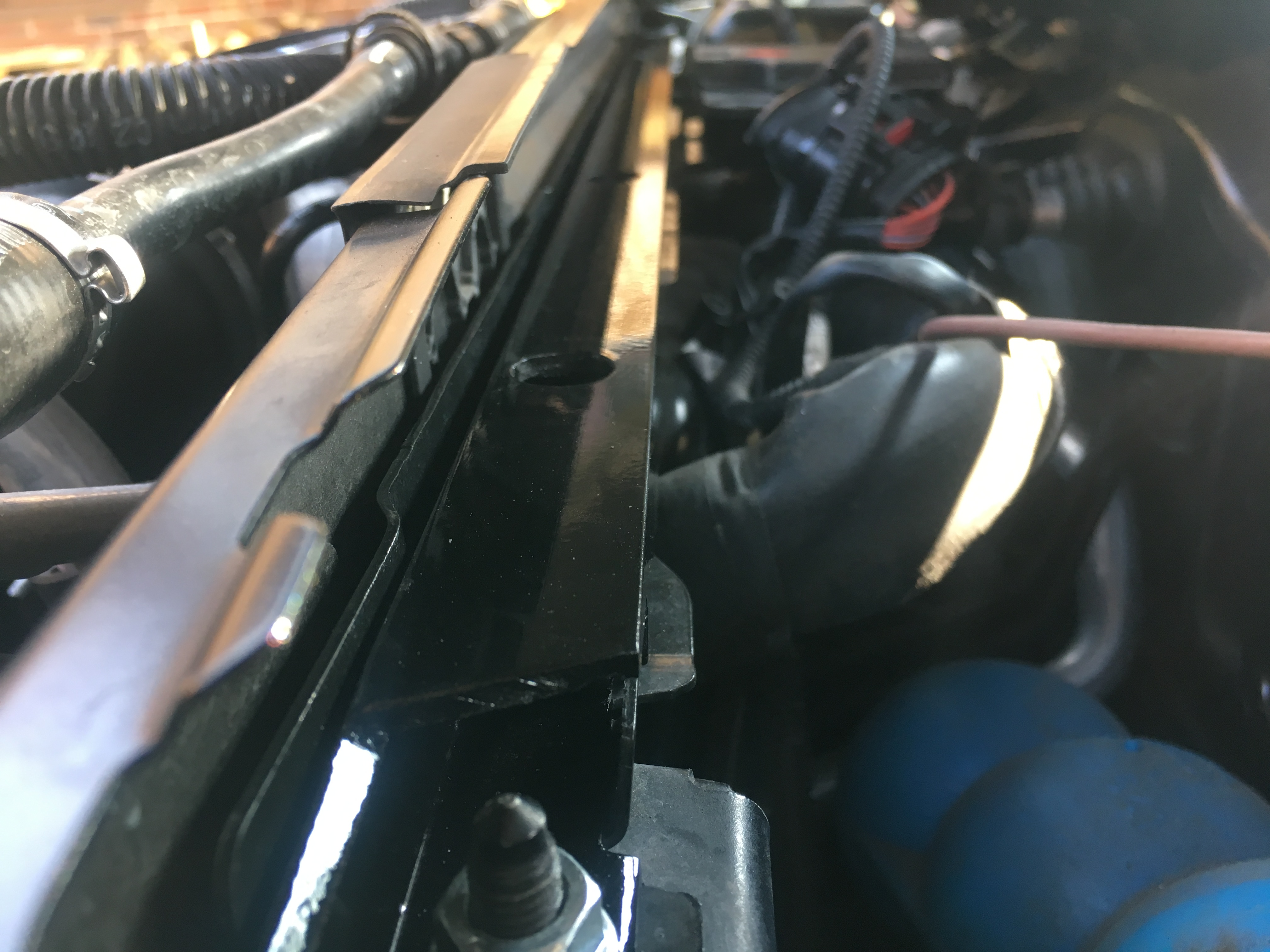

Baldrick
Posts: 7
Post by Baldrick » Sun Apr 21, 2019 4:55 pm
Took a couple of hours, my DIY bar all made up and fitted. If you’ve a vice, saw, drill and a couple of files it isn’t a difficult job and as I said, cost me £12 plus some Halfords paint. The dimensions you need are a 1m length of 1” diameter box section aluminium with a 10 swg diameter. I made mine similar to the canyon where it needed filing and extra holes drilling to fit onto the existing audi brace. But it would be even simpler to remove the Audi brace, and use it as a template for an entirely new bar. Then it would probably only require the drilling of about six holes. Were I to do it again, this is the route I would go down, also using initially a 1m bar with a thinner swg to practise on, followed by accurately doing a perfect job and paint on a 10 swg thick bar. In my opinion it really isn’t necessary to shell out £100+ for what is a lightly machined box section if you’ve got a few tools in the shed.
Baldrick
Posts: 7
Post by Baldrick » Mon Apr 22, 2019 12:32 am
Further to the above - big difference in preciseness to the steering. Recommended.
jangol
Posts: 522
Post by jangol » Fri Aug 23, 2019 10:11 pm
jangol wrote:It’s arrived Image ignore the healthy bits in the picImage

morski
Posts: 385
Post by morski » Sun Sep 22, 2019 12:39 pm
Great job..
did you drill the extra holes to accommodate the extra studs on the original metal fitting? IS there anything already bolted onto them or could they be cut off? Or would you say remove the original bar completely?
