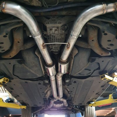

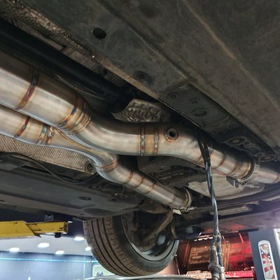

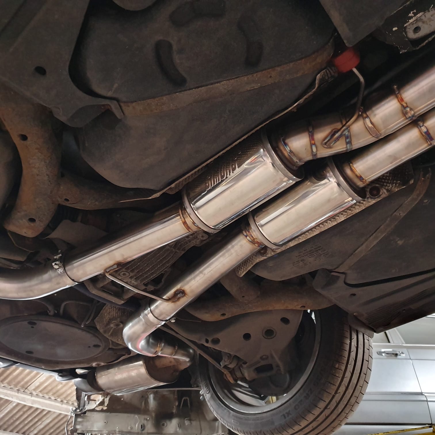

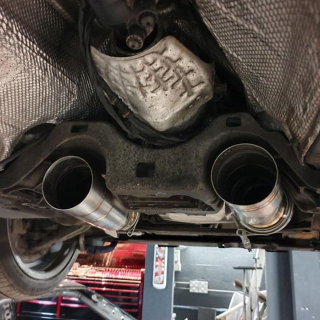

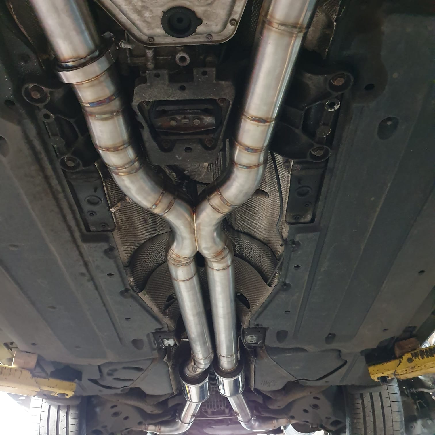

I should have results this week, unfortunately we had a hold up on the exhaust side of things. I’ve went full 3.5” from the turbos back, I wanted to retain some level of quiet. Opted for 5” silencers and the wrong size came, so we lost a couple of days waiting on new ones. Exhaust is now finished and the car will be back at Mrc tomorrow for a week of testing and mapping. As said TTEs rep suggests we should do 1000hp minimum especially with my spec. My car ran 880ps and 1200nms on the 850’s on a mild map and 1008ps on race fuel. I’m hoping the new turbos do 1050+ps on 99 and upwards of 1150 on race. I think the curve will move slightly to the right as it’s a bigger turbine wheel, I’m hoping we don’t lose too much spool as the 850’s were incredible in that sense. Will post all findings good and bad throughout next week 👍🏻

Some exhaust pictures
