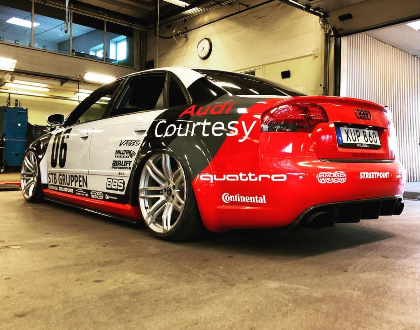

I've mounted 20" RS5 wheels with no spacers. Sure you've seen photos of this set up before but if not I'll post some later.
Others have fitted 20" C7 RS6 wheels but think they need spacers.
Others have fitted same design, width and offset as oem wheels but the 20" version with and without spacers.
Don't think I've seen any 21s though. Or maybe there was one car that had them and looked over wheeled.

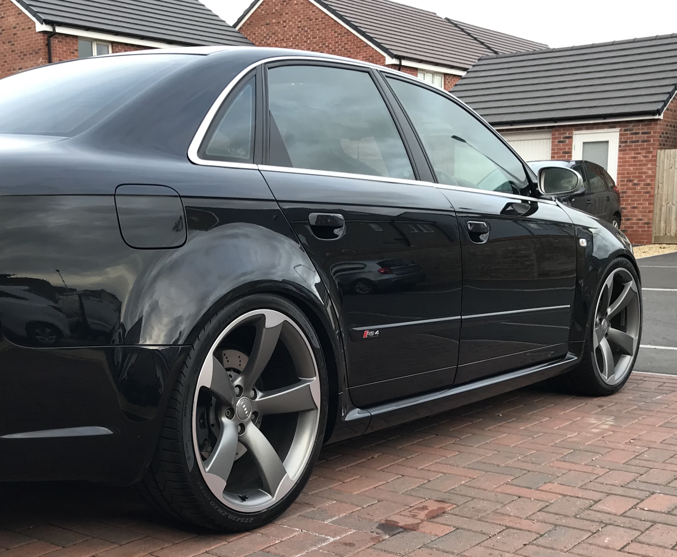

See my thread for details, 4mm spacers
My generic RS4 photo

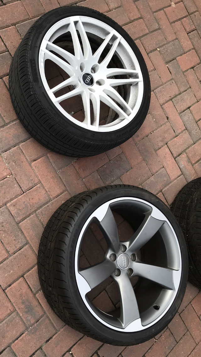

I’ve found some genuine Audi wheels
Do you think they’ll fit
20x9.5
et21
5x112
Tyres are all audi rs R01 specific 275 35 20 pirelli p zero.
2 with 7mm
2 with 5mm

To fit those you’re going to need tyres, spacers and probably spigot rings

I did mention these wheels in my response above. But Daytona is right you will also need spigot rings and probably tyres too.

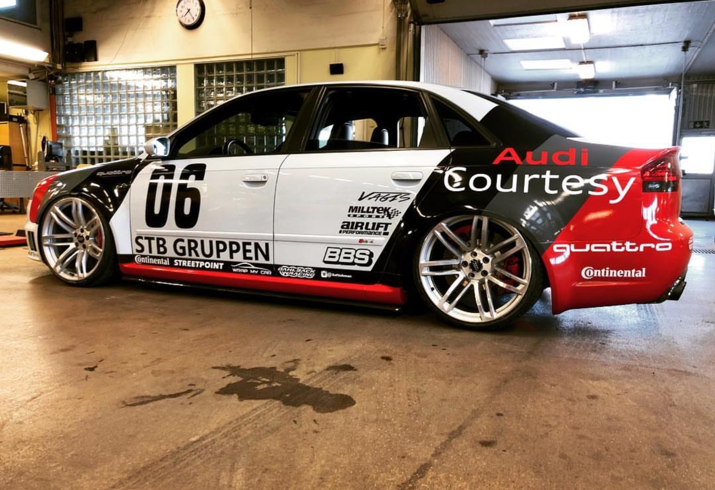

Post by MikeFish » Wed Mar 20, 2019 7:27 am
Courtesy of benhol and softishman.

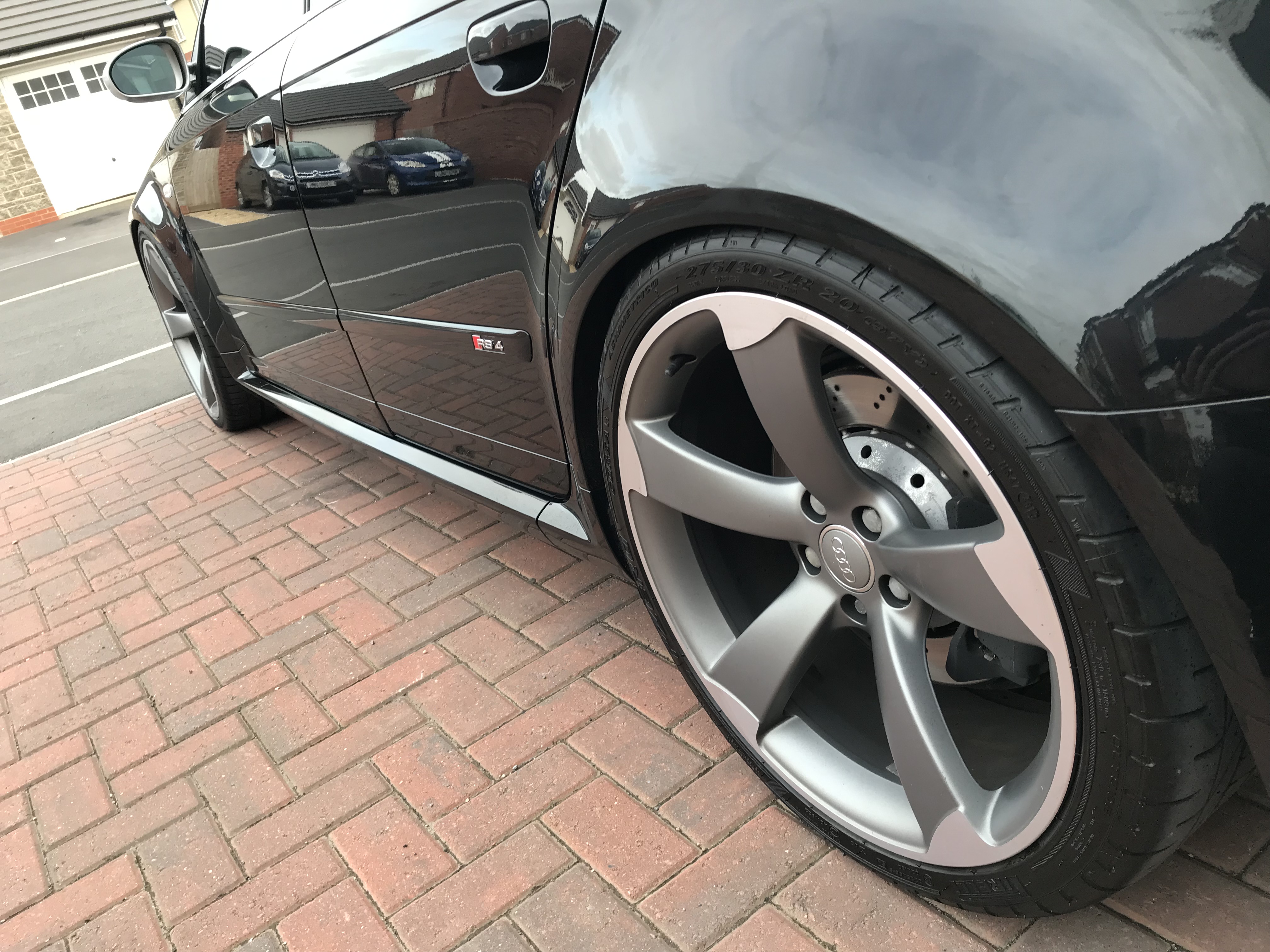

Post by MrRSB7 » Sun Mar 24, 2019 8:58 pm
Yes.... so settled on these puppies
Bit of s snug fit, but they look dreamy

Post by MikeFish » Sun Mar 24, 2019 10:11 pm
It's snug because you have much wider tyres. Those are 275 wide rather than 255 wide.
