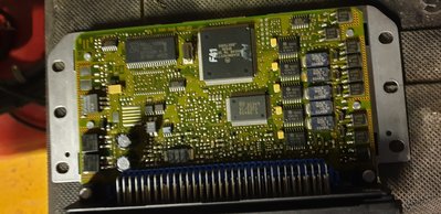

Photo attached of the TCU, any ideas anyone.

I opened up the TCU and everything looks ok, nothing corroded or loose, carpets all dry. Mind you I haven't a clue what I am looking for.

When you opened the TCU did it look like one of the chips had been changed / messed with?
Re: Viper tuned TCU
Not that i could see, pic attached. Old boy that serviced it looked after my Audi's and VW cars this was just to much for him I guess.
