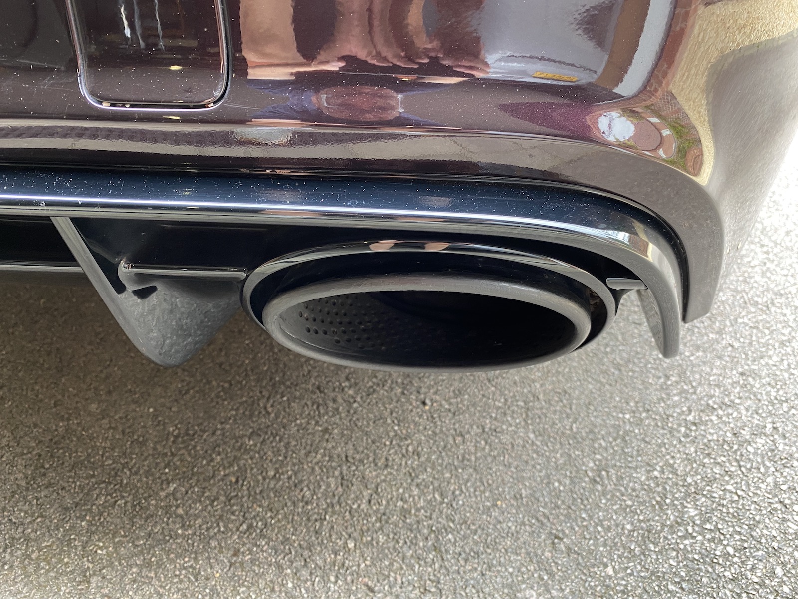

My car has also suffered pretty badly with the pitting, I've barely done 25,000 miles and they've been like this for a while now:
I picked up one of those black Dykem markers to see what difference it would make, I tried to clean up as much of the crud as possible with a spot of autosol on a rag but didn't go as far as using some wire wool as I assumed it would have taken most of the existing finish off. Took about an hour to give both tips 3 coats:
As a temporary solution its fine, obviously if you stop and examine it you can still see the pitting where the original finish has chipped away. The Dykem pens are like felt tips markers, I struggled to get deep down the side of the tips but overall am happy for an hours work and £9
