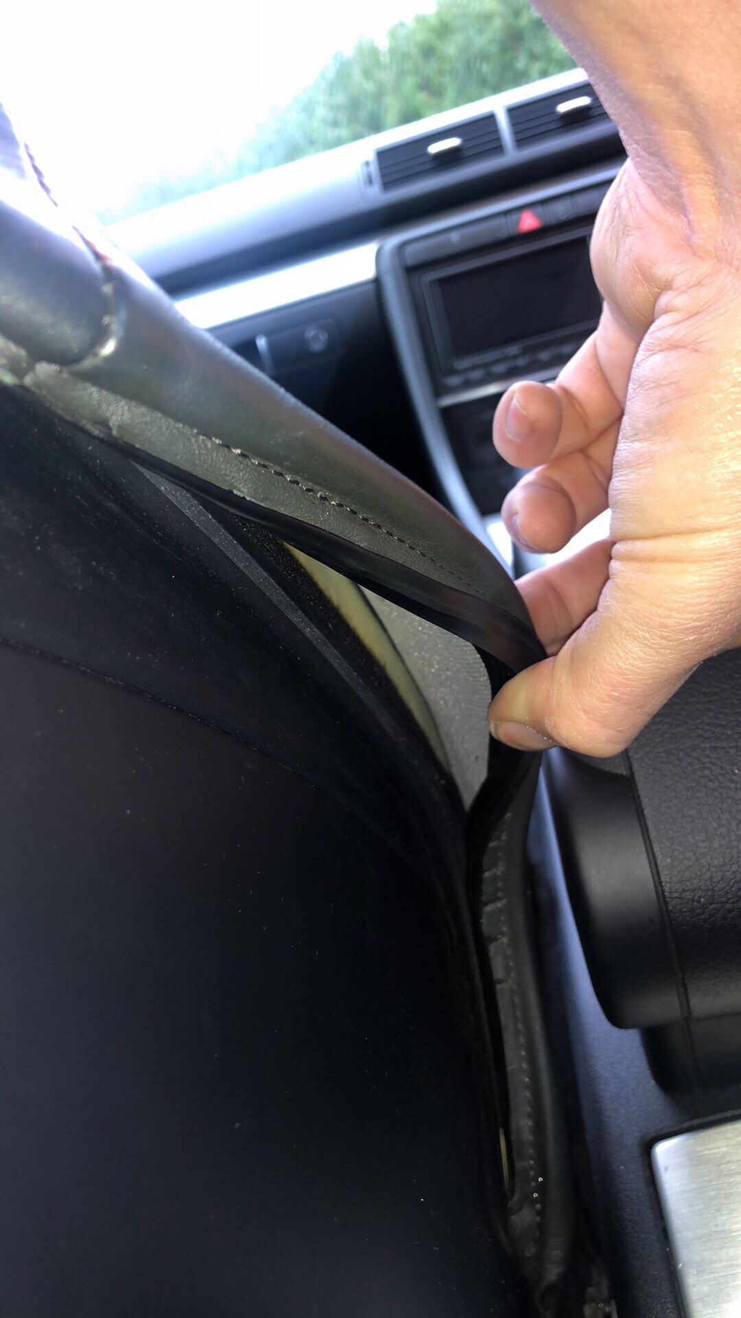

On Both front seats the trimming is coming off the back is there any way of pushing it back in to place?? Is that how it has to be done or is there clips??

No clips, it is just tucked in. I've never had any issues just tucking it in by hand on the easy to reach areas. Might need to pull it a bit to make sure there is enough edging to tuck if it doesn't go in willingly.

Slacken the bolsters off so they’re on their widest setting and you’ll find it easier to tuck them back in.
