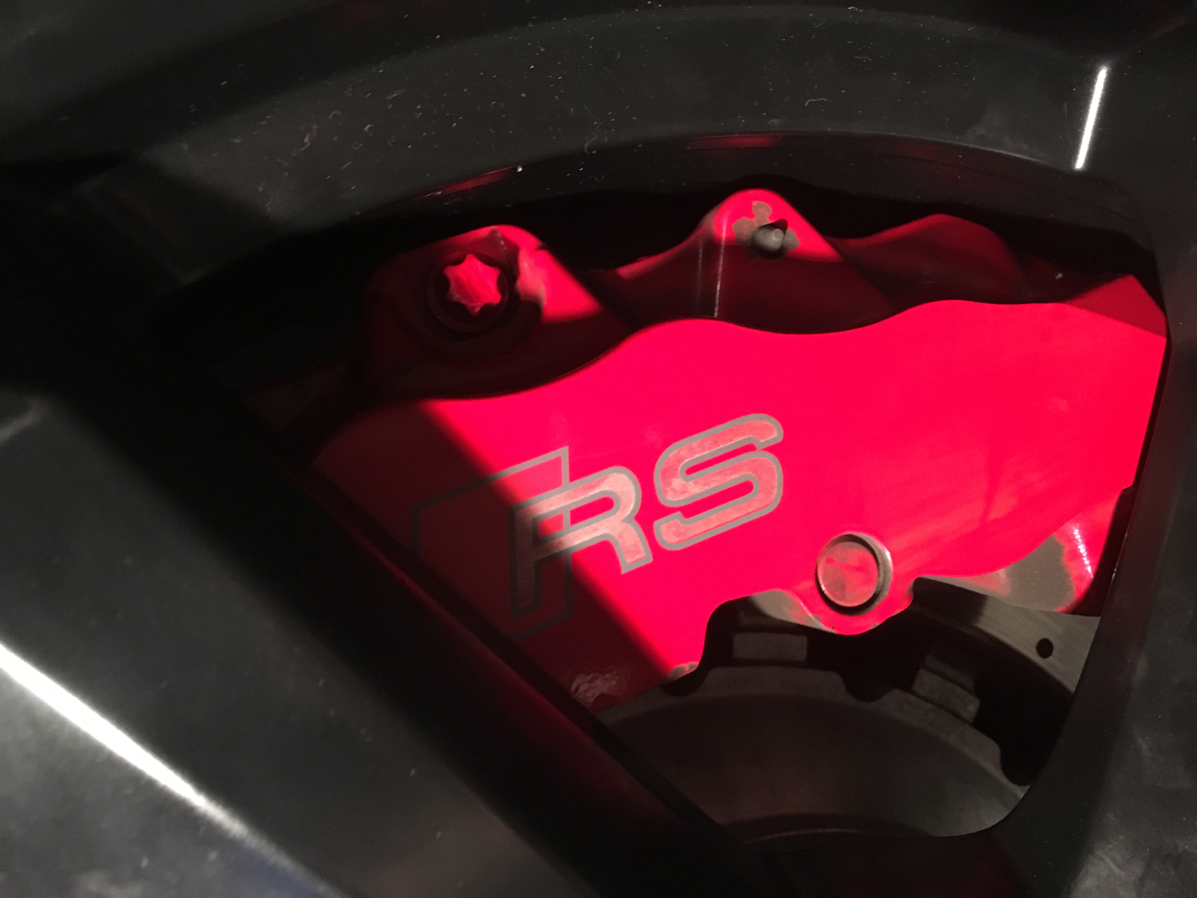

will 2018 S3 black edition wheels in 18inch fit my 2016 RS3 looks quite tight on the radial for the callipers ???

Well the wheels arrived today. Tomorrow will be the test if they clear the callipers
Re: Winter wheels & tyres ?
Bugger
. As you can see I can confirm 18’s off an S3 don’t fit. A costly test

I've just seen the wheels in the for sale thread. They look really good in that colour. Where are they catching? Hard to tell in the photos. I think it looks like the diameter is too small rather than the spokes catching the caliper. If so, wouldn't a spacer help by bringing them out a bit or is the barrel flat all the way through the wheel?
Mike the car is already on 10mm spacers it touches on the radial and the spokes. A larger spacerwould sort that problem but the calliper would still touch on the radial
